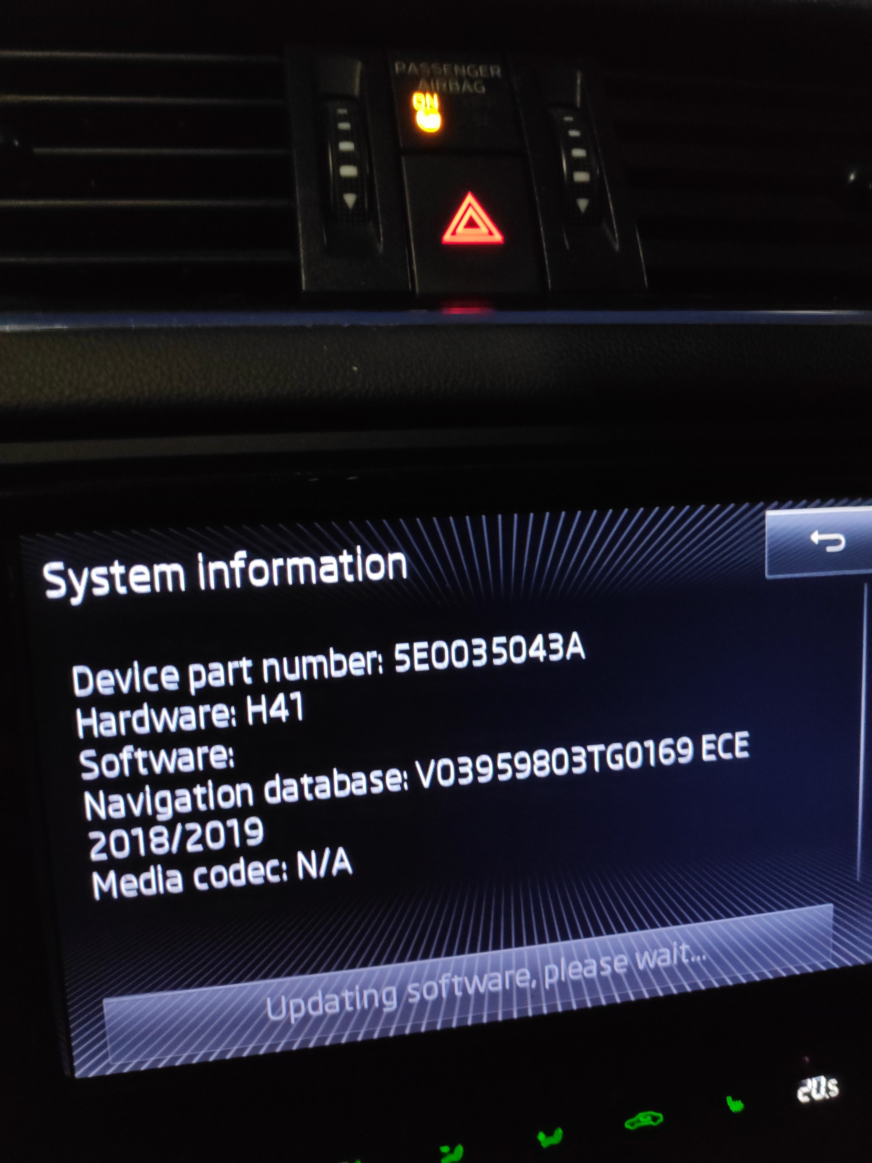

I’ve got a 2014 vrs that had mib1, Check out this thread I made a while ago.
 You’ll have to upgrade the display and head unit, total worth it, makes the car feel brand new.
Edited by System0fAClown
To change to past tense.
Mine.
What extras u got after upgrade ?
