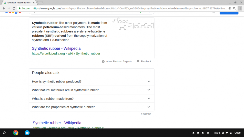

  • Go on take the chance, the cambelt is a rubber/fibre construction so the rubber will and does harden over time (as do tyres) that is why they are given time/mile intervals, Skoda errs in the side of c
