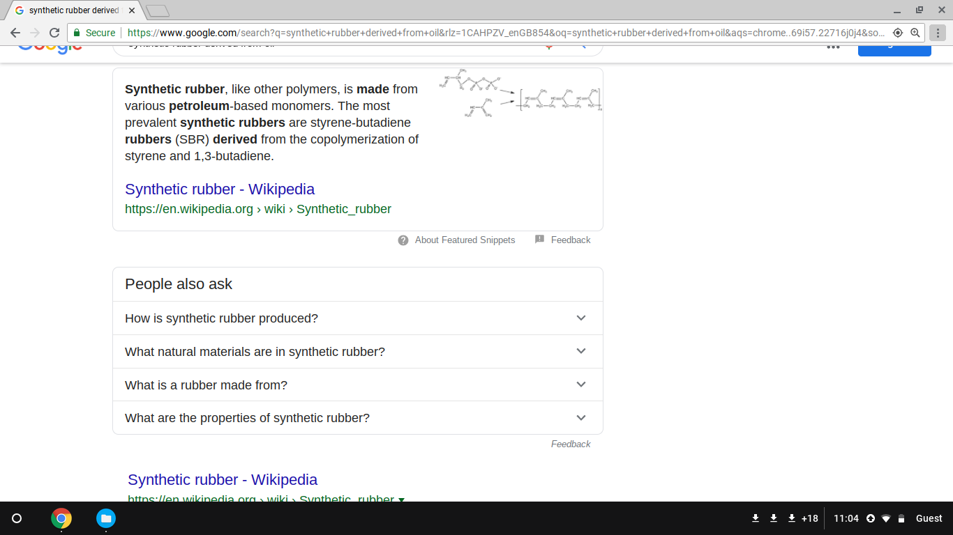

There are a common thing with tyres, rubber boots, condoms and Cam / fan belts.  Or there used to be when they were rubber from trees
& not some synthetic rubber / composite with ingredients derived from petrochemical plants..
But then there is with Door Seals and Hatch Seals & Sunroof seals and VW Group source some totally crap ones.
