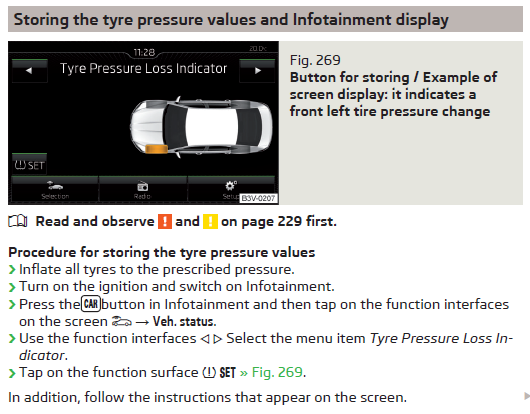

So you go into the menu and in tyres select set pressure?
Just checking as I met someone who thought you had to set the tyres to the car rather than the car to tyres.

what's the error message?
How far through the process did you get?
So once you have inflated to the right pressure have you then pressed "set" on the screen to recalibrate it to your new tyres ?

Hmm, I experienced this behaviour only in case the car was moving. Once it is still, I am fully able to set the tyre pressure and it doesnt matter if the engine is on or off (but ignition has to be turned on). I assume you have tried it this way.

One tyre was a little low, so I pumped it back up and went to reset the system.
It wouldn't let me, just said 'starting' on that screen for about half an hour.
I switched the engine off and put the ignition back on, and hey presto I could reset it.

This worked for me in the end thanks for all the replies.
