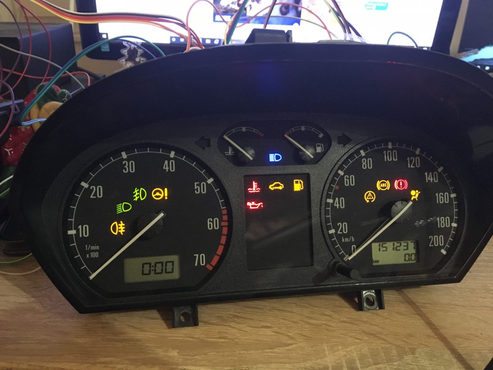

Hi. I tried everythink to light on ilumination of clusters on table. I have BSG unit and connected via CAN-BUS. Everything wokrs (etc. VCDS, VAG-COM, K+CAN commander - everythink communication and works). I can light on only via test in VAG-COM. I can not found working pin on BSG to light on clusters. Very please for your help. On any concern car is more simply, but on Fabia MK1 not... Thanks

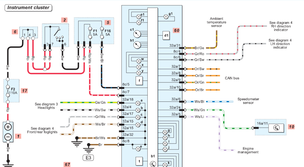

Not sure if this is any help?....
Hmmm, it doesn't seem to show the cluster backlights does it.
EDIT apparently 'e' is it but shows nothing else.
Edited by TMB
Realy thank you for replay, but... I thing that I am searching 60 and "e" like a Ilumination instrument is grounded at pin 8c/8. I got it (It is GND point of cluster terminal 31) but the second signal is from b1 (CAN communication). Do you have the same diagram for main control unit of the car (comfort unit) (BSG)? I do not know where to find this type of wiring. I have only original ŠKODA documentaion and its very more complicated :-).

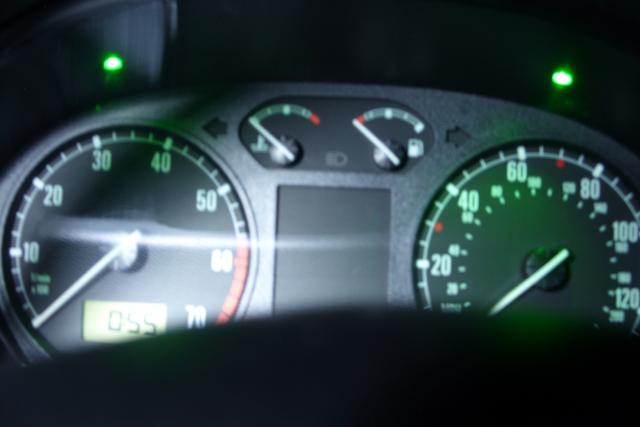

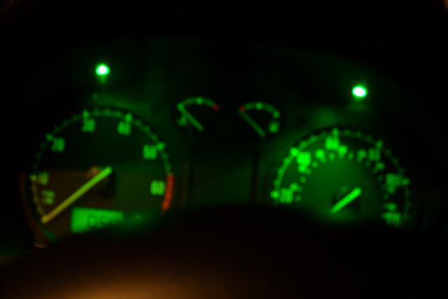

When mine broke I just fitted two 5mm green LEDs in the top of the cluster. Lights up a treat. It worked so well that I had to change the resistor I originally used to a higher value one to dim them a bit 😁

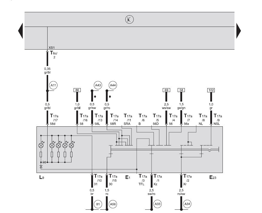

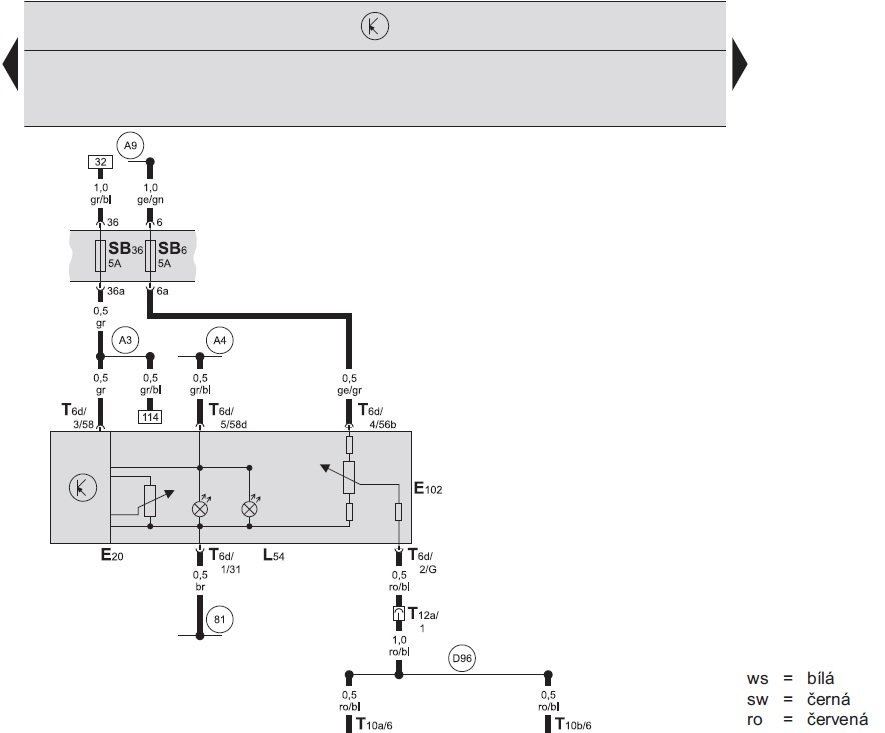

The numbers like 86 in rectangular boxes tell you the 'current track' number where that wire continues. Current track numbers are the ones at the bottom of each diagram.
If you scroll down a few pages on the diagram you have, you'll find the 'illumination regulator', E20, which seems to be a potentiometer. It isn't shown as a proper circuit, but I think the output is the wire going to the A11, and A4 in circles, from pin T7a/3 of the illumination regulator. This will be supplying a variable voltage to something inside the J519 module (A-D converter in a microcontroller, most likely) which will then allow J519 to command over CAN communications the illumination level at the instruments circuit board. Unless you can find a circled A11 or A4 associated with one of the wires going to the instrument cluster (dash panel insert, J285), I think this must be how the backlighting of J285 is controlled, via digital comms.

See my reply just above, but I think you just need to connect up the illumination regulator to your BSG at T6c/2?

I used a 10k OHM potenciometer (with LED diod) and feed 0V-12V to XS1 (T6c/2) in BSG (J519) and nothing going on... My LED diod with resistor is working, but backlight nothing... I founded that page about setting of backlighting, but I don't understand it... 😞 Everything work me... I can connect the clusters to PC and via app play a game and show real speed on clusters :D it is perfect, but this simply think like is backlight i can not run :(. I do not understand, what does it mean that A4, A9 etc. and continuing of cable [32] etc.

Things like A4 in circles are wiring connections within the loom. Where lots of wires are all spliced together.

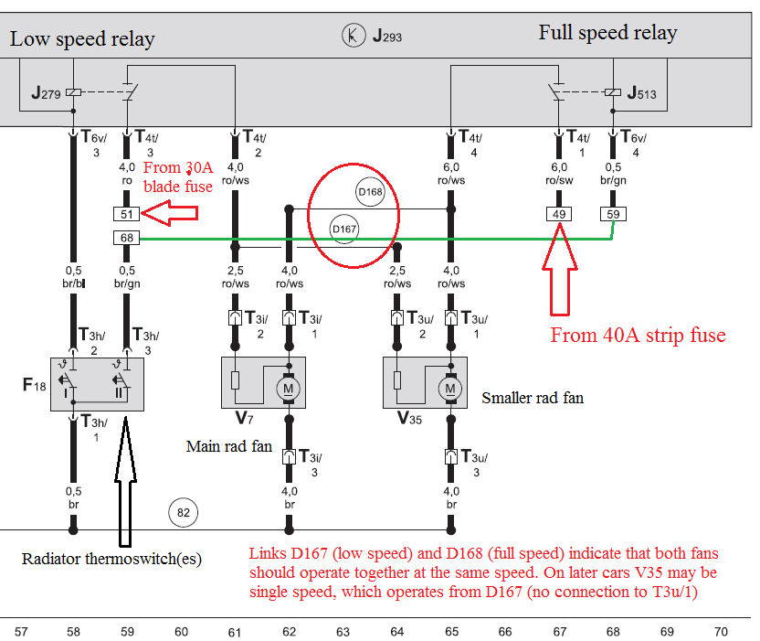

Here's an example of (radiator fan wiring)  where continuation rectangular boxes of source and destination are on the same page, so I've highlighted the linked track numbers by joining them with a green line. Usually the destination is on a different page.
This example also shows some circled numbers where the wires joined are actually also on the same page, and linked with thin black horizontal lines.

I understand it now :D thx so much for explain this 🙂.
