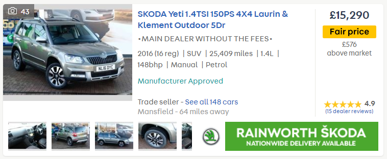

I'm not sure what your budget is? Given the 1.8 TSI you were looking at had covered 120,000+ I'm guessing lower than this one, but it ticks a lot of nice boxes, rare colour, 1.4 TSI, 4x4, main dealer warranty, low mileage and Laurin & Klement (L&K) trim...
If it has to be 4x4 and your budget won't stretch to £15,000 then it'll have to be a diesel.
Personally if I had to choose I'd sacrifice 4x4 for the 1.4 TSI engine and invest in a set of premium all-terrain tyres.
