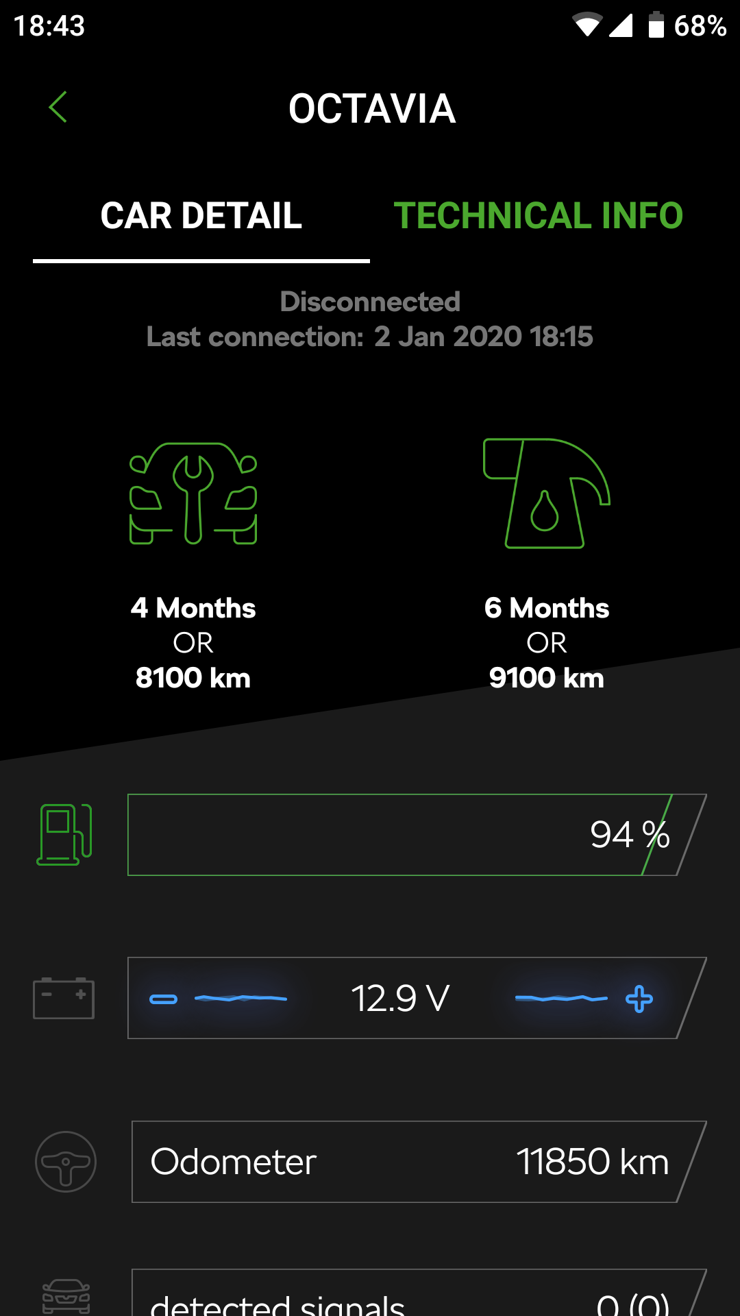

I'm just picked up my 2018 Octavia 1.0 two with stop/start. I'm noticing that it very very rarely wants to activate with the reason of high power consumption.
I have none of the obvious stuff running (radio/AC/mirror heaters/rear windscreen heater) but it still tells me the power consumption is high.
I've done a bit of reading through the search function and it looks like the battery could be the culprit. I have a EFB 59Ah battery and it sits on 12.9V on idle (according to MySkoda app - I know it's probably not the most accurate).
I understand this is the weaker of the stop start batteries. Is this likely to be the culprit? Do I have a leg to stand on to ask the dealer to replace it if it's not 'fit for purpose'?
Many thanks
M

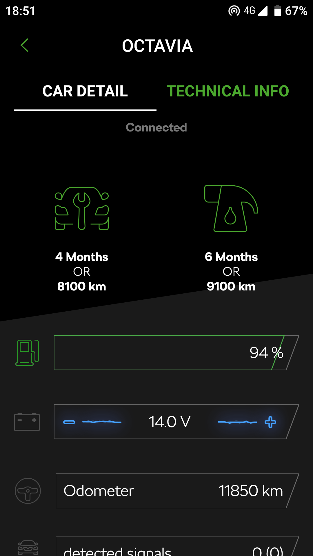

Oh dear. My mistake, it is 14V at idle.
12.9V must have been engine off.

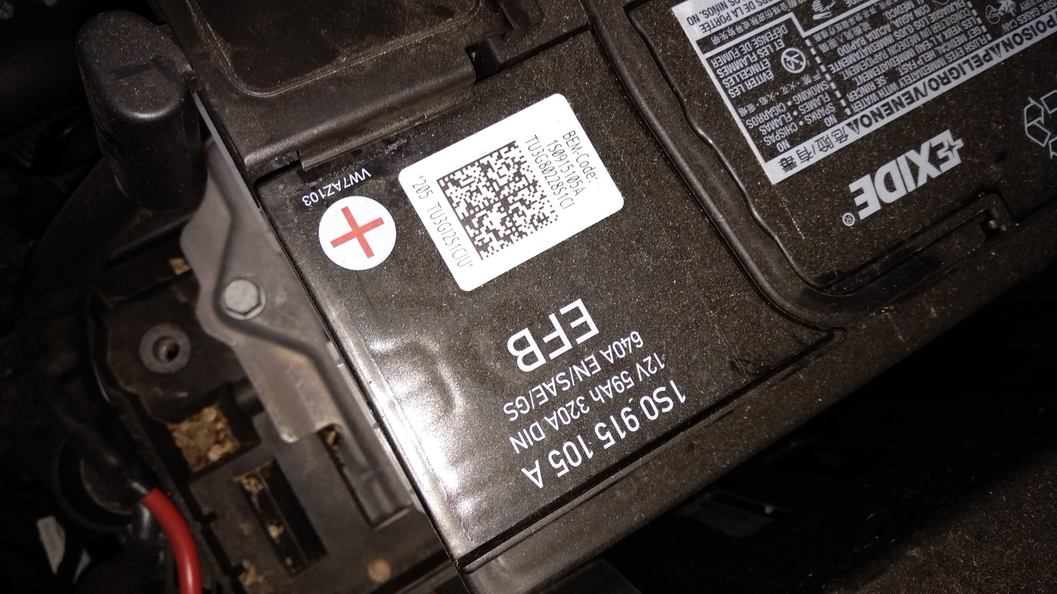

Yeah it seems very strange, would you mind having a look at the type of battery you have?
With a Stop/Start engine the alternator doesn't always work. 😮
If the battery was at 12.9 Volts then the BMS  ( Battery Management System ) would think the battery doesn't need charging.
It will come on when you brake but it will charge at a higher rate, about 15 volts.
So a Stop/Start battery will not normally be fully charged by the car so there is capacity to be charged.

Could you tell me what kind of battery you have?

Assessing battery performance and stop start operation isn’t as easy as associating the battery construction type with others showing performance issues. There are a number of factors affecting when stop start cuts in such as cabin temp difference between heater setting vs actual temp and outside temp,  engine temperature, steering input, foot movement on pedals, for example, as well as vehicle history and usage pattern.
Measuring battery voltage accurately isn’t that straightforward on a vehicle, alternator charging phases switch in and out for fuel efficiency and the operation of multiple electrical consumers suppress the true voltage. All of this skews the reading you get between 12.2v and 14v.  Ideally the battery should be disconnected for a few hours to stabilise before it is performance tested in an open circuit condition with something like a Midtronics tester. Otherwise there is too much interference getting in the way.

The measured CCA (cold crank amps) Vs the label rating is key. A test with a Midtronics should return a value higher than the label rating at room temp and 12.72v. The label shows cca at -18’C. If the test result show a lower cca rating for 12.72v, the battery is on its way out and is unlikely to improve much.
The battery you are likely to get from a Skoda dealer will probs be the same as what you currently have.  It will be perfectly ok if you do reasonable average annual miles. Otherwise up-spec to AGM from higher spec cars, they take more abuse.

Looking for CCA reading approx 10% or higher than 640A EN spec at +17’C (ref photo of label in first post) and 12.72v for a good battery. Slightly less if voltage is lower.

5 minutes ago, AGFalco said:
If you go from EFB to AGM then you need to tell the car, read this first:-
https://www.golfmk7.com/forums/index.php?threads/how-to-retro-fit-a-bigger-capacity-battery-to-a-mk7-golf.320084/
