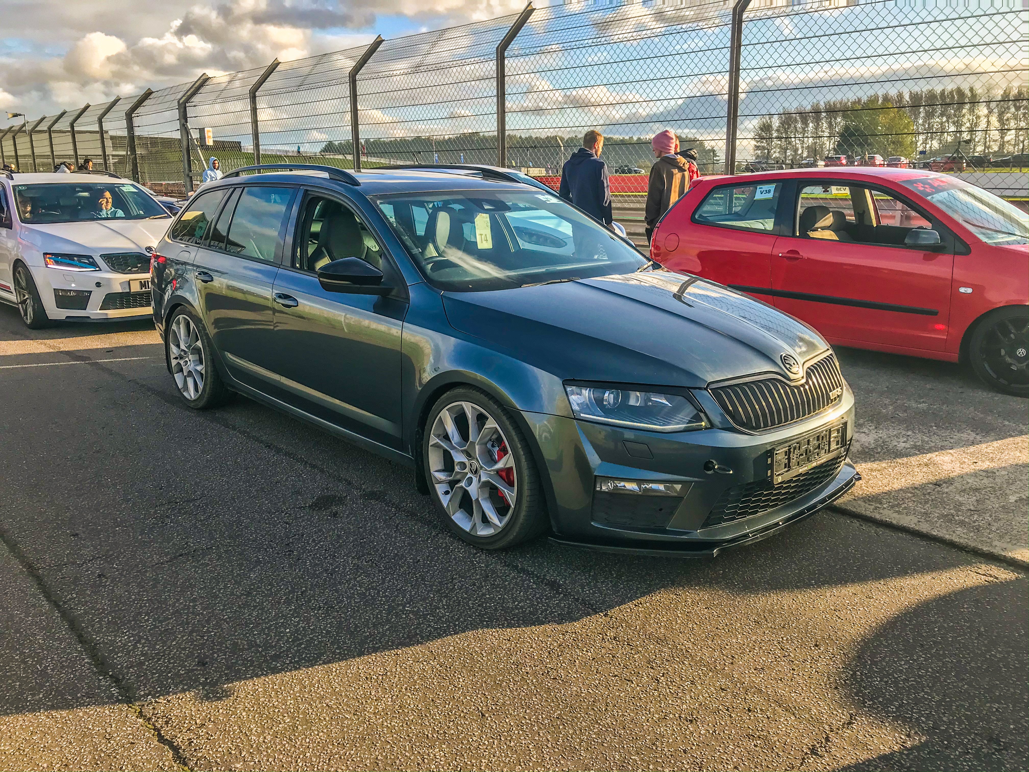

For reference, here’s mine with 19’s and 40mm H&R springs with standard shocks also running 20 front and 25mm rear spacers. Most people do 15/20 but I need 20 front with the Xtreme’s to clear my brakes.
Thanks for the reply SashaGrace, the stance on yours looks exactly right and what i would go for. good to see what the 19s and 40mm drop looks like.  Very nice car by the way.

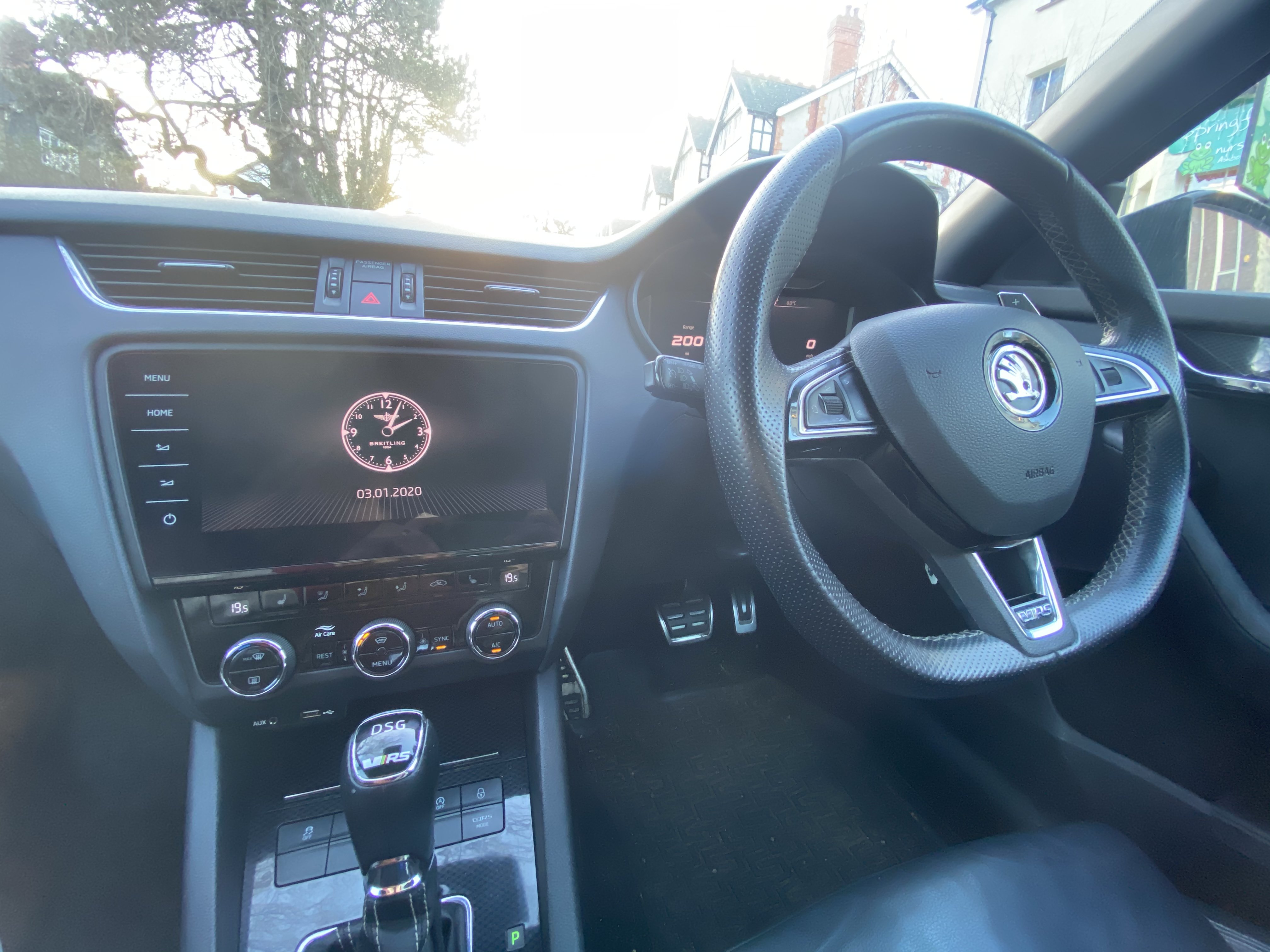

You would lose the ambient lighting and key personalisation though and my screen isn’t a plug and play upgrade as you’d need the MIB2.5 base unit to match, though this is true for the FL too. If you have a MIB2 radio with the older screen you can plug and play the 5E0919605M glass FL Amundsen screen. This is not the case for the earlier MIB1 cars.
Personally I specifically went for a pFL 230 as I wanted the leather seats, the single light front end and also wanted the electronic diff.  For me, they're the sweet spot of trim.
The screen is a bit small, but if I'm really that bothered I'll pick up a glass 8" screen.  Tbh though, I'm generally looking out the windscreen so that kind of stuff isn't a huge concern for me.
Sasha, out of interest, as I just googled that part number and found they're not that expensive...
The glass one has an 'app' button rather than a 'traffic' button.
What does that button do if you swap from the old screen to the new one?

Nothing, unless you port 04xx firmware onto the radio unit (if you have the right radio) and then it shortcuts to SmartLink. The backlight still works in any case.
