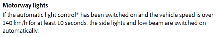

My old Oct 2 had auto lights and if you did over about 65mph it would automatically turn the headlights on.
Yep, that's still a feature, it is 140kph (87mph).

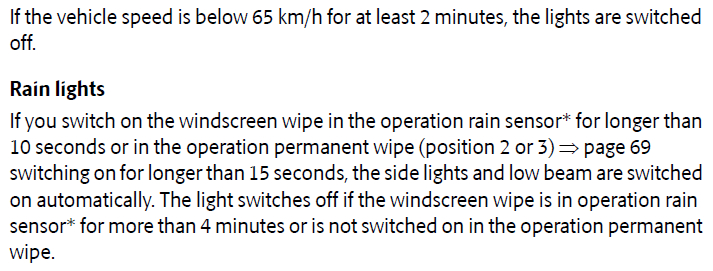

Also, if the wipers are wiping constantly they'll activate the auto headlights.
My point was that once either of the various inputs activated the headlights, they wouldn't turn off again until my I was in stop/start traffic for several minutes, and even this was hit and miss, they'd often stay on until the next ignition cycle.

 I also have same issue on current car that once they come on especially if it's due to using wipers /rain they take an age to go off again.  If they come on in a tunnel they generally go off quickly after exiting.

So the reason they do this is to make you visible to other road users where there is a likelihood of poor visibility (rain, spray etc.). Lights aren’t just about you seeing where you are going.
they stay on for a time after rain has stopped as there is still a good chance of people not seeing you well.
