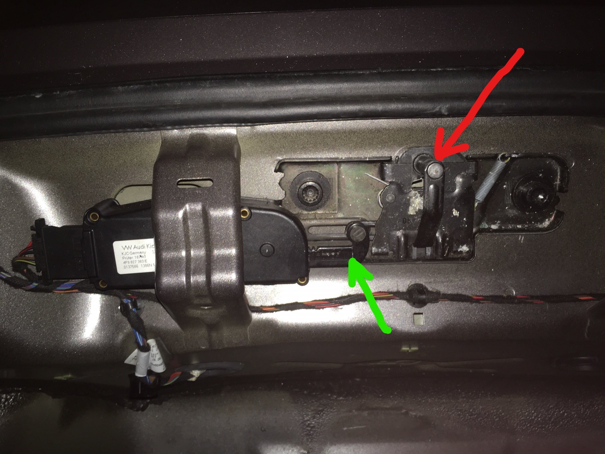

Just an update on this issue.  I seem to have located the source of the problem.
Having investigated the lock latch which sits in the tailgate all appeared to working correctly so I turned my attention to the tailgate lock mechanism that sits in the sill of the boot.  As has been described in other posts when the tailgate closes this emits a whirring noise.  Having removed the rear trim from the boot sill and having climbed into the boot I was able to observe how the mechanism works.
Once the "boot close" button is pressed the 2 struts bring the tailgate down where the lock latches onto the post that is part of the tailgate lock mechanism (see image RED ARROW).  It is then that the whirring noise is heard and the mechanism draws the tailgate post downwards to what should be its closed position.  (See image GREEN ARROW shows part of mechanism which is activated by the motor)  For approximately 5 seconds it is ok but then the mechanism reverses its action and the tailgate post is returned to its original position. I have tried a thorough degreasing and cleaning followed with a light lubrication.  Having done so the mechanical side of the mechanism is moving freely.

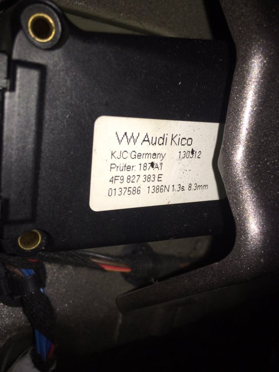

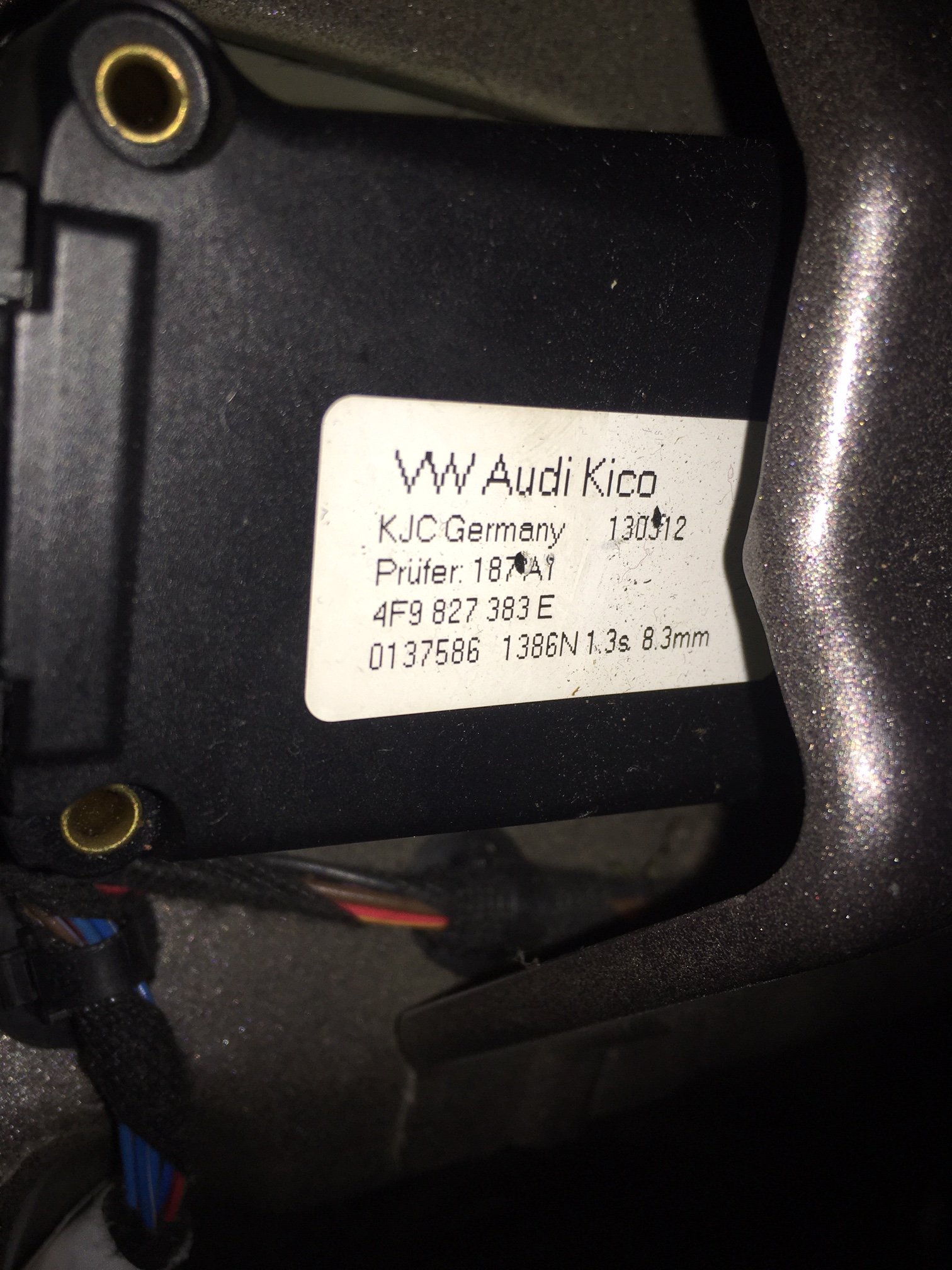

Hence my conclusion is that the tailgate lock mechanism is faulty in that it doesn't hold its closed position.  I'm wondering if there is a small limit switch within it that tells the mechanism when it has reached its full travel.  If this isn't made the motor reverses and the mechanism returned to its starting position.  This is just a theory that I have and would love to hear if anyone else has any experience regarding the testing of the part (Part No. shown image)
Any feedback would be gratefully received.
