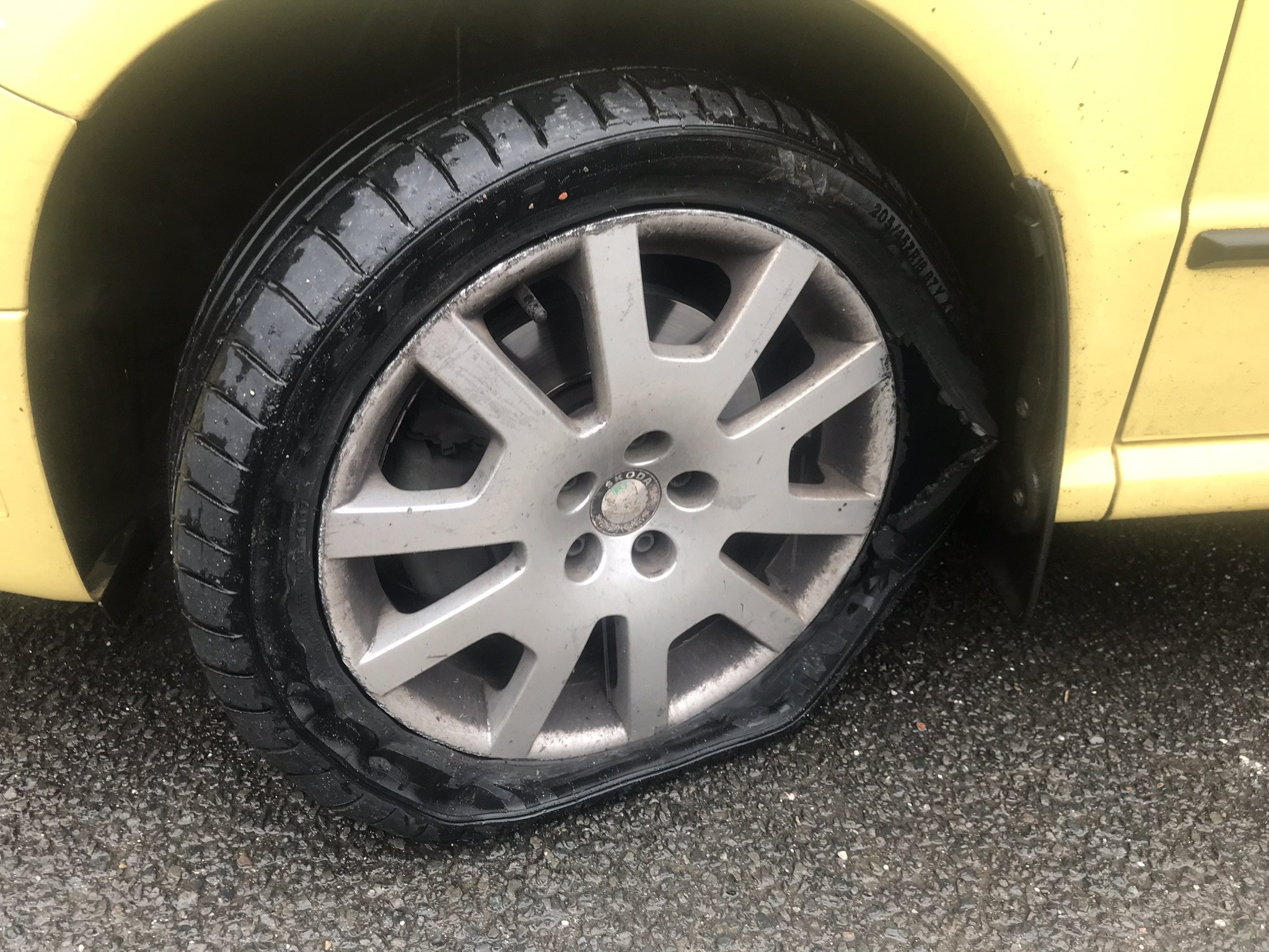

Unfortunately for me I think I may be looking to retro fit a number of things. First stop will be the scrap yard for a spare tyre, as good as the inflator rubbish is it wouldn’t have fixed this that happened to my last fabia after a meeting with a pot hole in the rain that I didn’t see. Then I will see how tricky it is to fit the sensors, my concern is the drilling of the bumper tbh

hope the guy in the wrong didn’t do too much damage, the only problem I have seen with mine so far is a slight scrape to the mirror housing, no big deal really but not something that’ll buff out. I’m certainly not going to be fixing it any time soon.

My wife's Polo probably got the usual bits damaged, the trim cap vanished though it probably ended up in many pieces, but I could not spot it anywhere - even asked the old guy if it came in through his smashed window! The other bits that tend to get wrecked are the LED indicator assembly and the frame assembly - that bit only costs about £10 from VW Group, the LED indicator assembly costs about £40, just under £100 for all the stuff needed to sort it out, I had estimated it would cost round about £450 so I got a pleasant surprise, a good enough surprise for me to keep telling my insurer and the old guy's insurer to clear off and let me fix it properly in my time without faffing around booking/driving it in, collecting it and then finding a crap job had been done using special lookie likie insurance claims quality parts.
