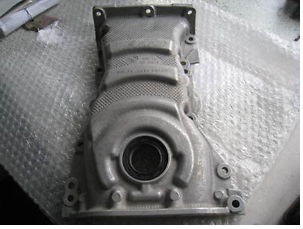

I followed up your recommendation today and had a browse of the parts catalogue.
The camchain box referred to in the TPI you kindly provided above (part 03F 109 210C) is in fact the complete cam box (see attached picture). It probably only make sense to change that as part of a job to replace the entire cam chain assembly. Although the part looks substantial in the picture (and hence potentially expensive) I found it could be bought for as little as 34 Euros from third parties on ebay.
Although this is a revised part it makes no sense to me. (But then I'm not an engineeer). It may guard against the cam chain jumping the lower sprocket but would do little to prevent the camchain jumping the camshaft sprocket.
Are you referring to the top cover which is a different part? I cannot find an upgraded alternative but that does not mean there is not one.
The TPI also refers to a "timing chain repair kit" part number 03F 198 229A. This "kit" comprises just the chain and tensioner - it does not include the guides etc. People who have their chains replaced using that part number should be aware of that fact. It is not be a big deal when the cam box is stripped down to replace ALL the parts. The parts of the entire assembly cannot come to much more than £150 - it's the labour that is the killer, so it makes sense to replace everything once it's stripped down.

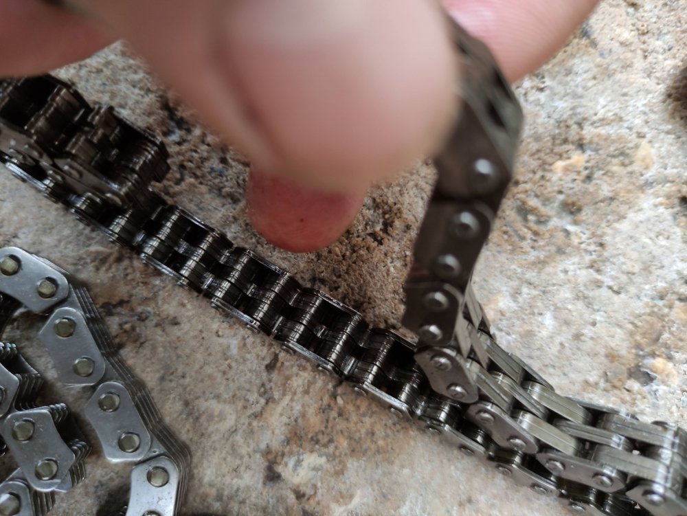

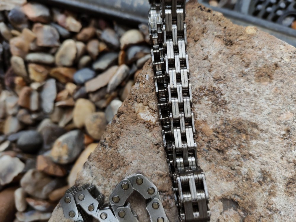

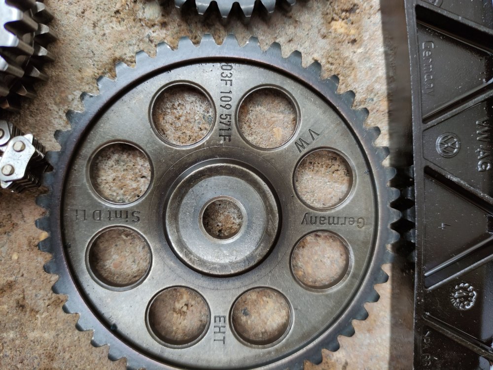

Hi
Had to upload this picture seperately. The website had a bit of a "moment" when  I tried to attach it to a reply post.
One final point - there are plently of posts on the web about faults with early 1.2TSI cam chains and third parties are supplying thyeir own parts which says that there is a demand out there. I don't want to be a Jeremiah but.,.......
Whoops! Goes to show the importance of reading AND understanding....I thought illustration 4 was the top cover, but you are right its the main cover that has the chain guard.
So probably vag think when the chain is slack, it hangs down, and the skipping/detatchment happens on the bottom sprocket?
Anyway, good work minimoke!
Keep us posted whether you experience the death rattle again after just a tensioner change.
