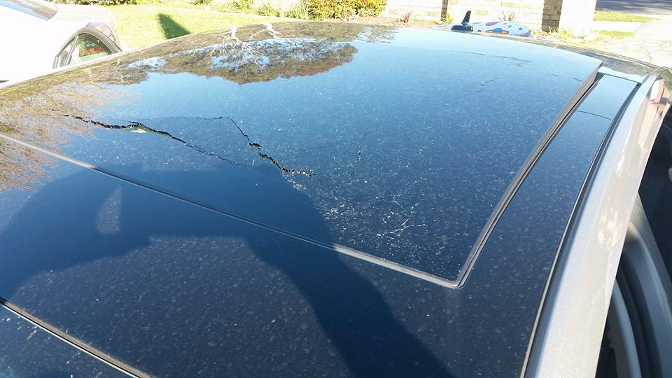

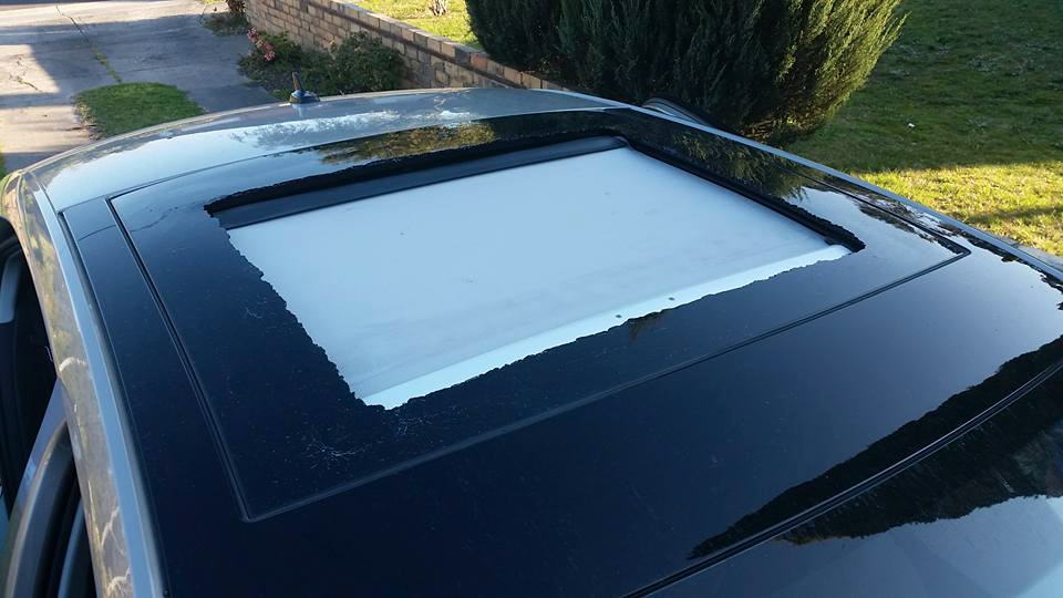

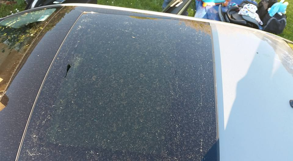

I had this happen on my old O3 some years ago when the car was about 6 months old. there was a bang and some fragments fell in; however most of the roof held its shape until I knocked it in. To get to my destination I closed the blind and then knocked it in, using a vacuum cleaner to pick up the granular pieces.
image.png.c8c562a3e39a53598db228cc4a9ed209.pngimage.png.c3a6e5948f7c1c3a55016e82bae56adf.pngimage.png.c8f601aac338336be3978d420314abe6.png
Having worked for many years in the lighting industry for many years and many thousands of sheets of toughened glass go through our factory, we only saw one sheet fail, which was put down to Nickel Sulfide inclusions. Being 8m up a pole and pointing down there are not many other explanations. It does happen and is exceptionally rare. If you are that worried, you should get your side windows replaced as well, as they are toughened.
To tell thermally toughened glass, look at it through polarized glasses and you will see a mottled effect. Compare the front laminated screen to the side toughened glass and you will see the difference. This is the result of toughening and not caused by any window tinting. Toughened glass is used as it is safer than un-laminated glass as the granular fragments are allot less dangerous than extremely sharp shards from broken normal glass.
Edited by Superb Smartie
