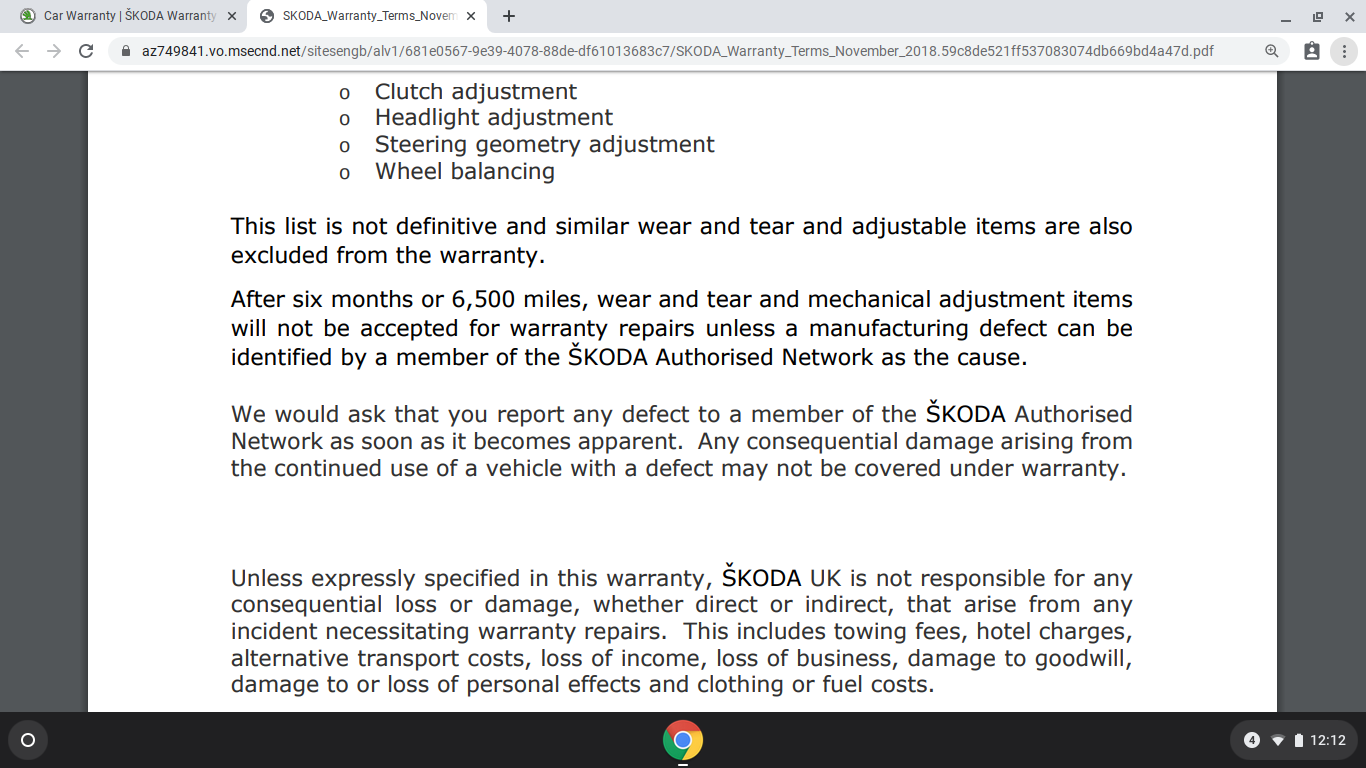

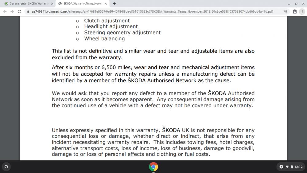

@varaderoguy
There is an issue with that, and Warranty 'Exclusions'  and the 6,500 mile / 6 month one which dealership staff like to try as a get out of having to do anything.
So report as soon as possible, have issues logged even if no source of noises found and no resolution.
& Read the Warranty T&C's.
SKODA_Warranty_Terms_November_2018.59c8de521ff537083074db669bd4a47d.pdf
