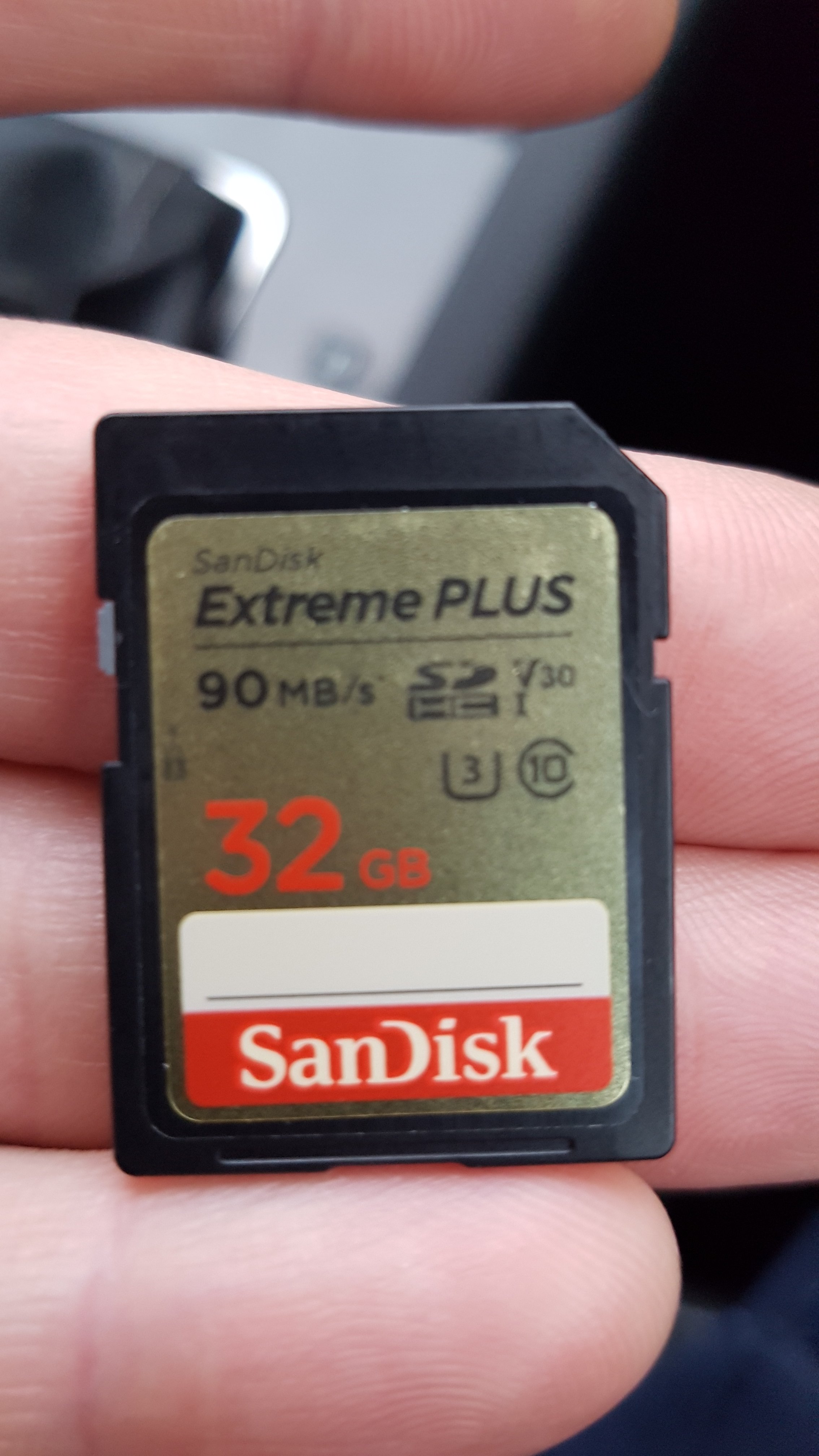

Hi . My system is a Columbus.  I attached a picture of the ad card I'm using . Is it up to the spec u were saying . Sorry I'm not able to tell . Thanks for the reply
Well, it's a FAT32, but I can't tell from that photo if it has the hidden "Skoda" partition. @SashaGrace may know, and indeed whether or not a Windows systems administrator account can look for that partition.

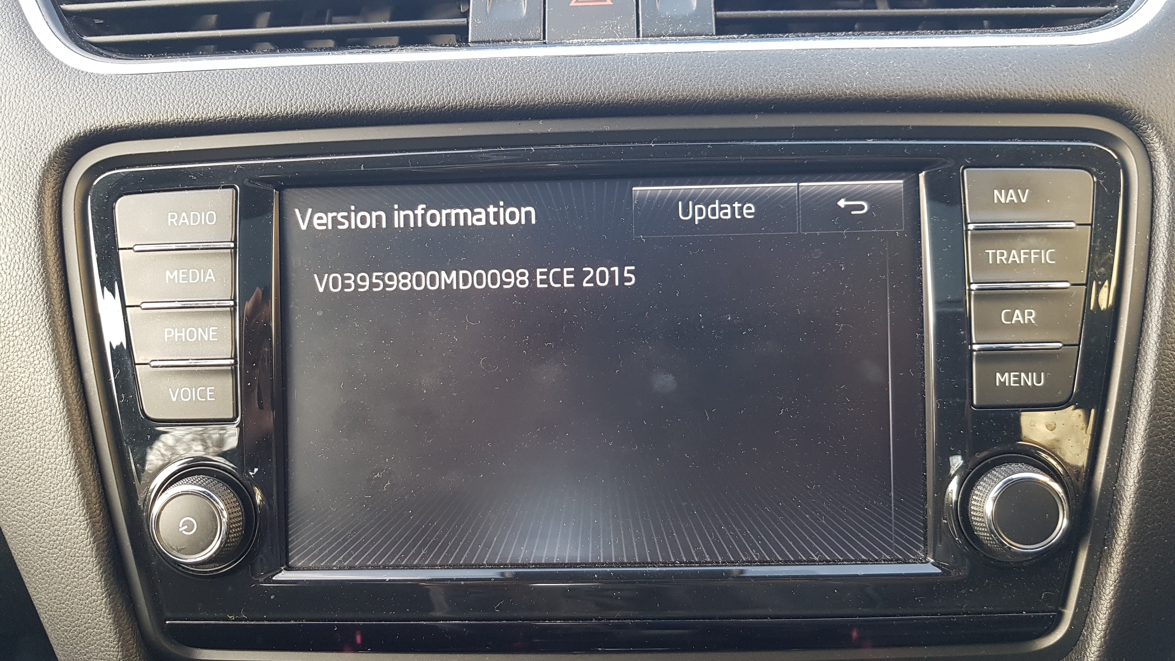

I have attached a picture of the system . I can't even play music of a memory stick . I borrowed a memory stick from a mate with a 16 Skoda with music on it and my car said memory stick error.

That’s definitely a Columbus, advice above is accurate; make sure there is nothing else on the card. Are you using a Mac?
