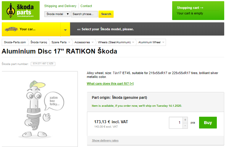

Skoda Ratikon alloy rims 7Jx17 ET40 5/112 57.1
Euros 187.22
https://www.skoda-parts.com/catalog/kodiaq/spare-parts/accessories/wheels-steel-aluminium/aluminium-wheel-578.html?sort=a-z
Four Skoda Ratikon alloy rims Euros 455 (less than £100 each rim not including shipping)

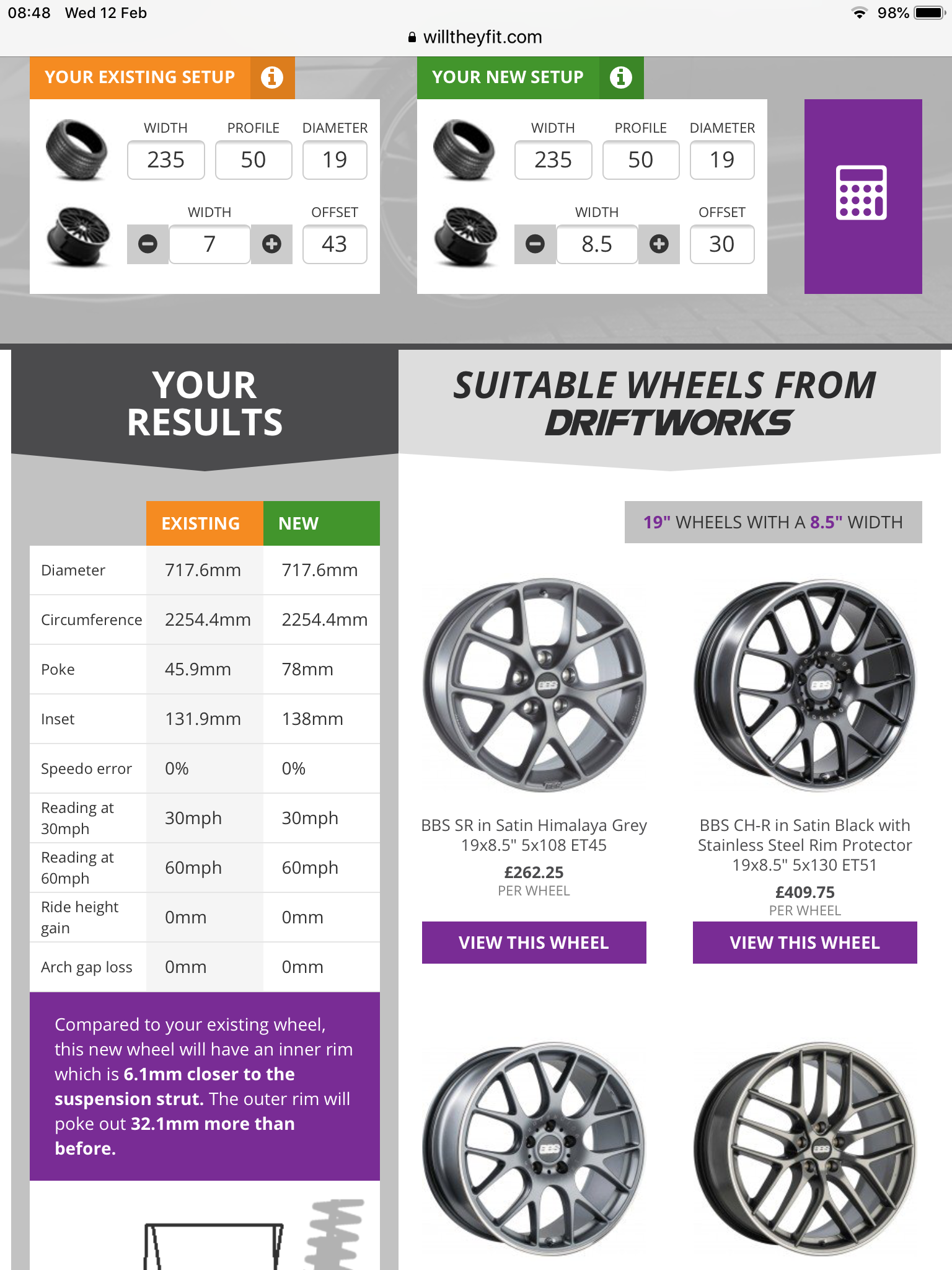

If you new wheels are 7x19 same as original then with the et30 they will stick out of the wheel arch 13mm further. You might need to invest in wide mud flaps to prevent road rash along the sides of your car :)
The wheels are 8,5x19
The pictures have to wait a long time.
Car does not even have a build date yet. :(
In that case the new wheels will stick out 32mm further than originals. More importantly they will be 6 mm closer to suspension strut.

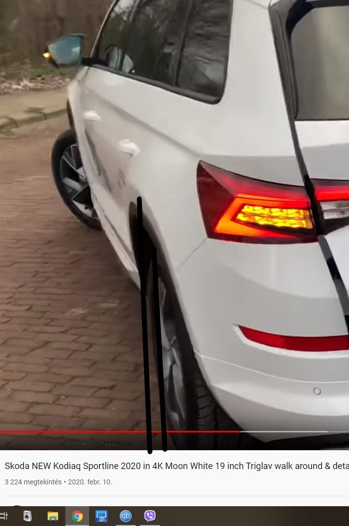

You made me worry so i looked for a youtube vid and feel better now but still not 100%
I attached a pic which tells me i should be fine with the 32mm the picture I attached is not a perfect example but it shows there is more than enough room for that 32mm at least at the back wheel.
The front im still looking.
I will stop by my dealer this weekend to check.
