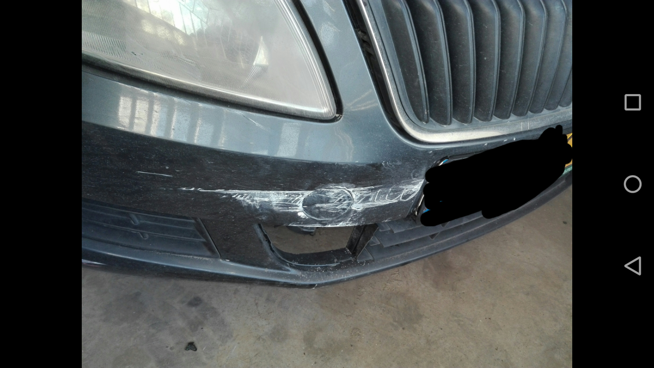

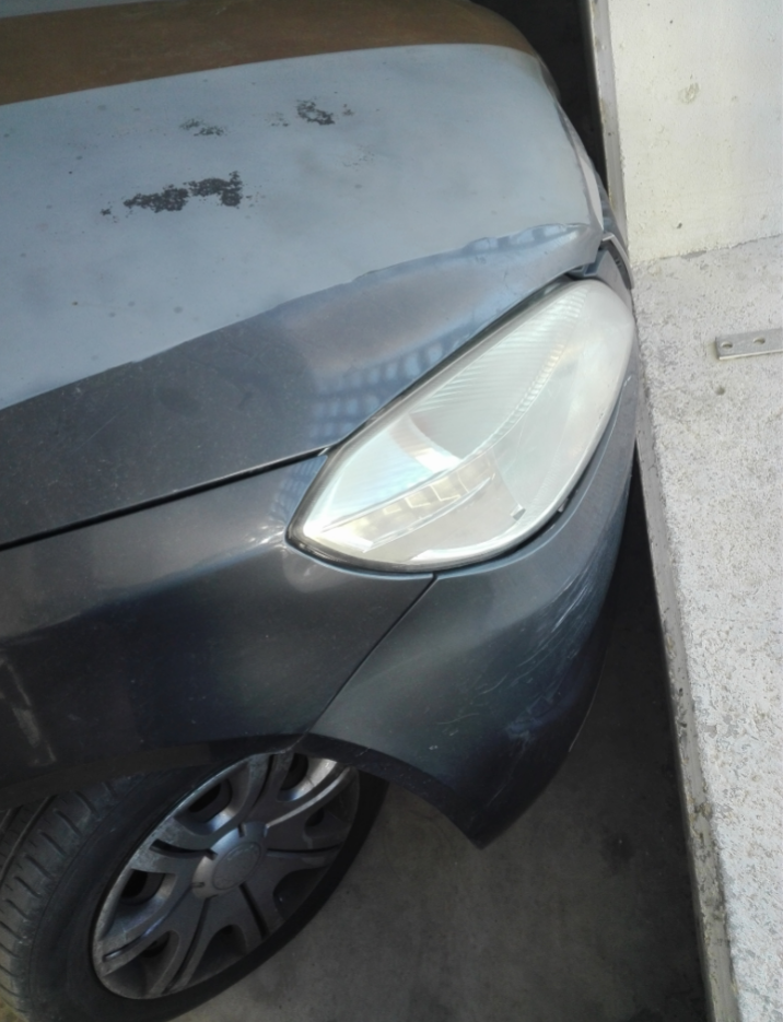

My Fabia uneventually "crashed" into a wall during park driving at ~5 km/h and the srs system was activated with driver+side airbag deployed and front seat-belts pretensionners activated.

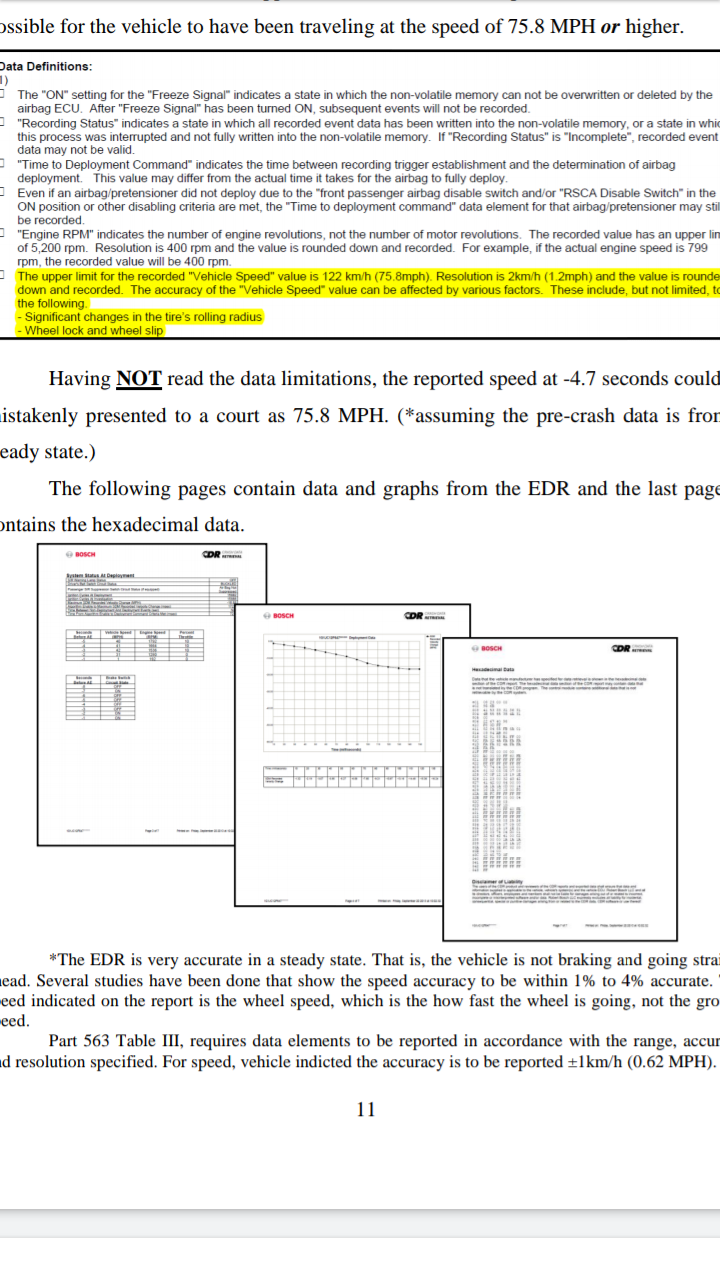

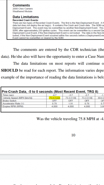

Is there a possibility in Fabia mk2 to retrieve data from the airbag ECU for the velocity/rpm/brake or gas status for thr 5 seconds before srs activation like in newer cars ?
Attached picture of the "impact" and of an example of Bosch CDR crash data retrieval tool

Whilst I share your view the hidden damage will be more severe than what you think, I recently rebuilt my Yeti after an impact far less than yours which had deployed the airbags, my windscreen was not cracked, the bumper has a tiny scuff which remains, the plastic radiator grille had some broken slats and the number plate cracked, all but the plastic grille were re-used and nobody would even notice.
During the strip down the severity of the impact became apparent, the metal bumper inner beam had contacted the aircon condensor and perforated it, the beam was deformed with a split in one return flange, it straightened quite well on my 12 ton press but as the whole front end is aligned from it including all the panel gaps it wasn't good enough, it is in fact the primary sacrificial crumple zone and had crumpled, the main chassis rail hadn't.
from looking at the photos its possible that you main chassis rail crumple zone has deformed, nothing in the scheme of things and I have repaired far worse in the past but thats more than enough impact to trigger the airbag g sensor and deploy the airbags, the threshold is low on the basis that the driver or passenger may not be wearing seat belts.

I received now an answer from Bosch inc. That her CDR tool ( https://www.boschdiagnostics.com/cdr/ ) :
Hello,
I do not show we have any coverage for a Skoda Fabia. So it would not be supported on our CDR tool.
Best regards / Mit freundlichen Grüßen
Drew Mehling
AA-AS/TSS2.1-NA
Aftermarket Technical Support Specialist
[email protected]
655 Eisenhower Drive
Owatonna, MN 55060
USA
www.bosch.com
Is there another option for crash data retriveal from the ECU box ?

Under 5kph? Really? I find that hard to comprehend, looking at the scuffing/damage to the car. Thats around 3MPH so unless you kept on driving, forcing the car into the wall and sending the car sideways on a deflected trajectory, that's an awful lot of damage! I would take a punt the glass was already smashed as its difficult to see what could have struck there.

With the sudden "explosion" of the airbag and the smoke it take some time to understand and brakes the car, so the scratching on the bumper...

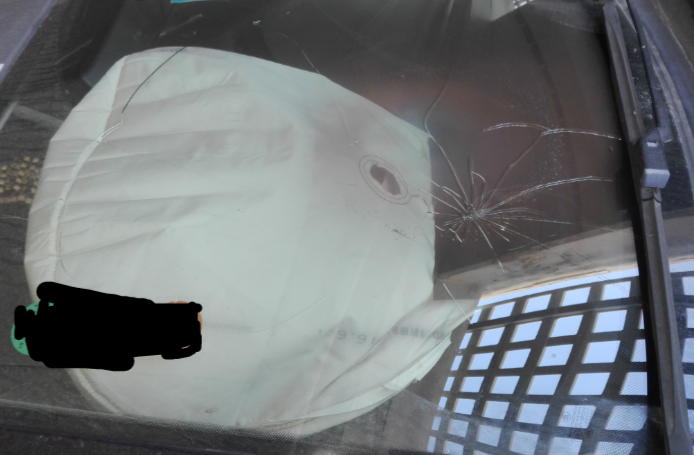

And 2nd, the glass was broken by the side front airbag when deploying. Was normal, no fissure before the srs activation !
Yours, Rafifi
I guess I was lucky not to have added a windscreen to the bill then, there were smeared charge deposits on it bearing witness to the airbag having pushed against it. The side, steering wheel and knee airbags all deployed but not the ones in the A & B pillars or seats.
19 hours ago, Rafifi said:
WOW! That was one unlucky collision, then!  I dint ever recall a windscreen being shattered/cracked by an airbag before. Surely that sort of deployment in its-self would be enough to render the use of airbags as dangerous!  I hope the insurance people are co-operative.
