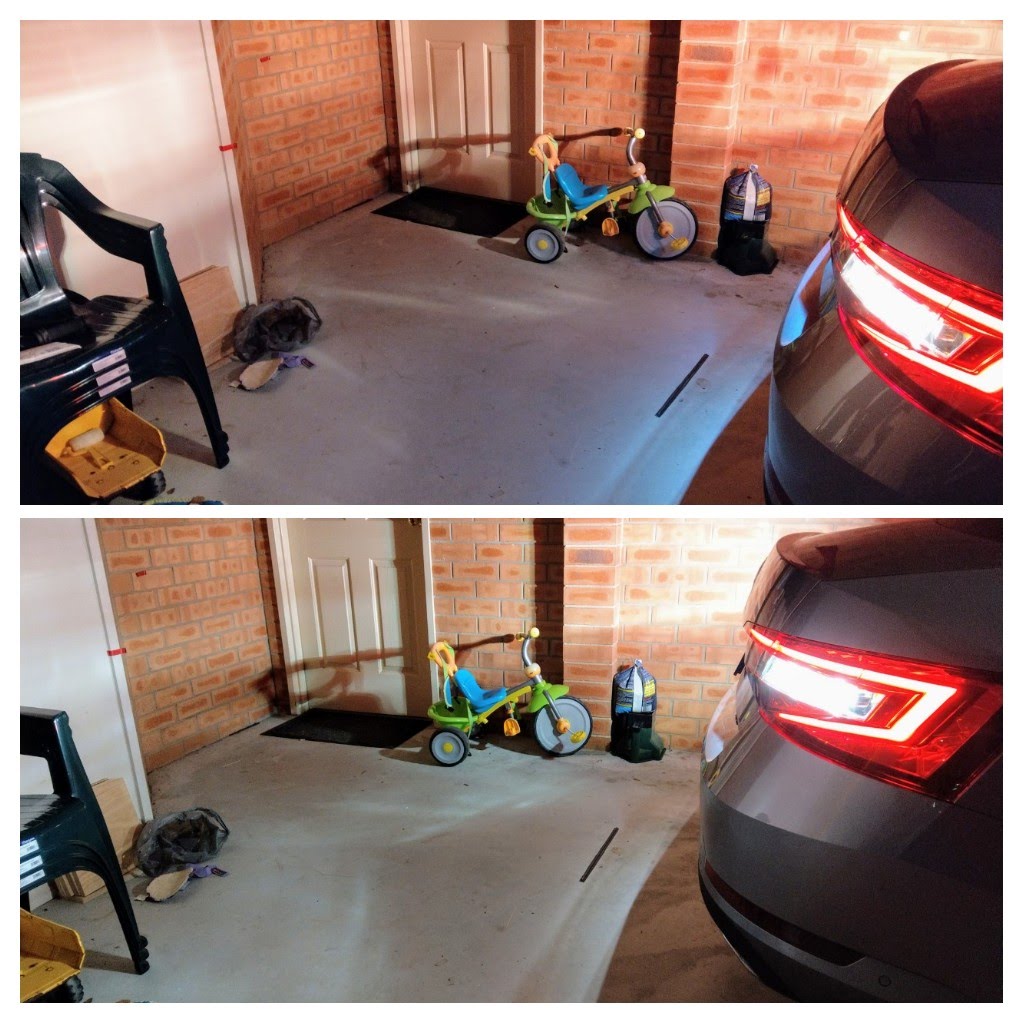

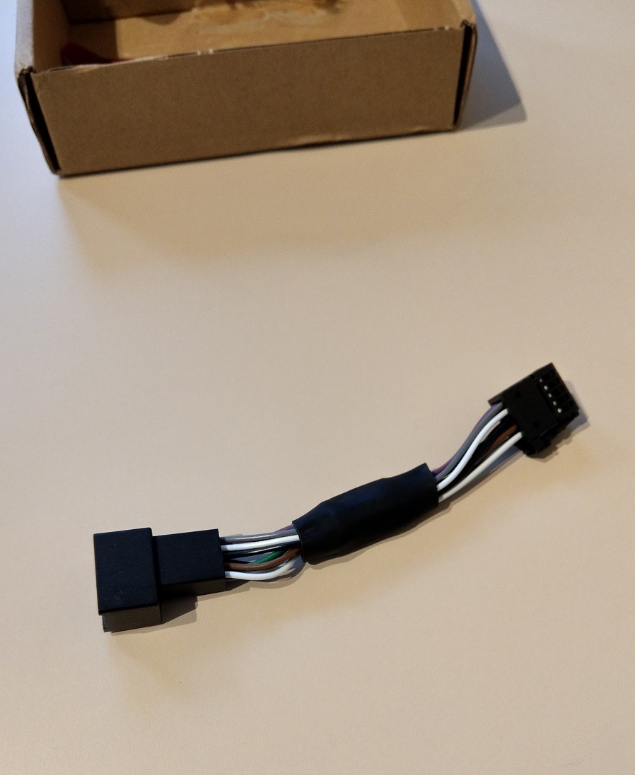

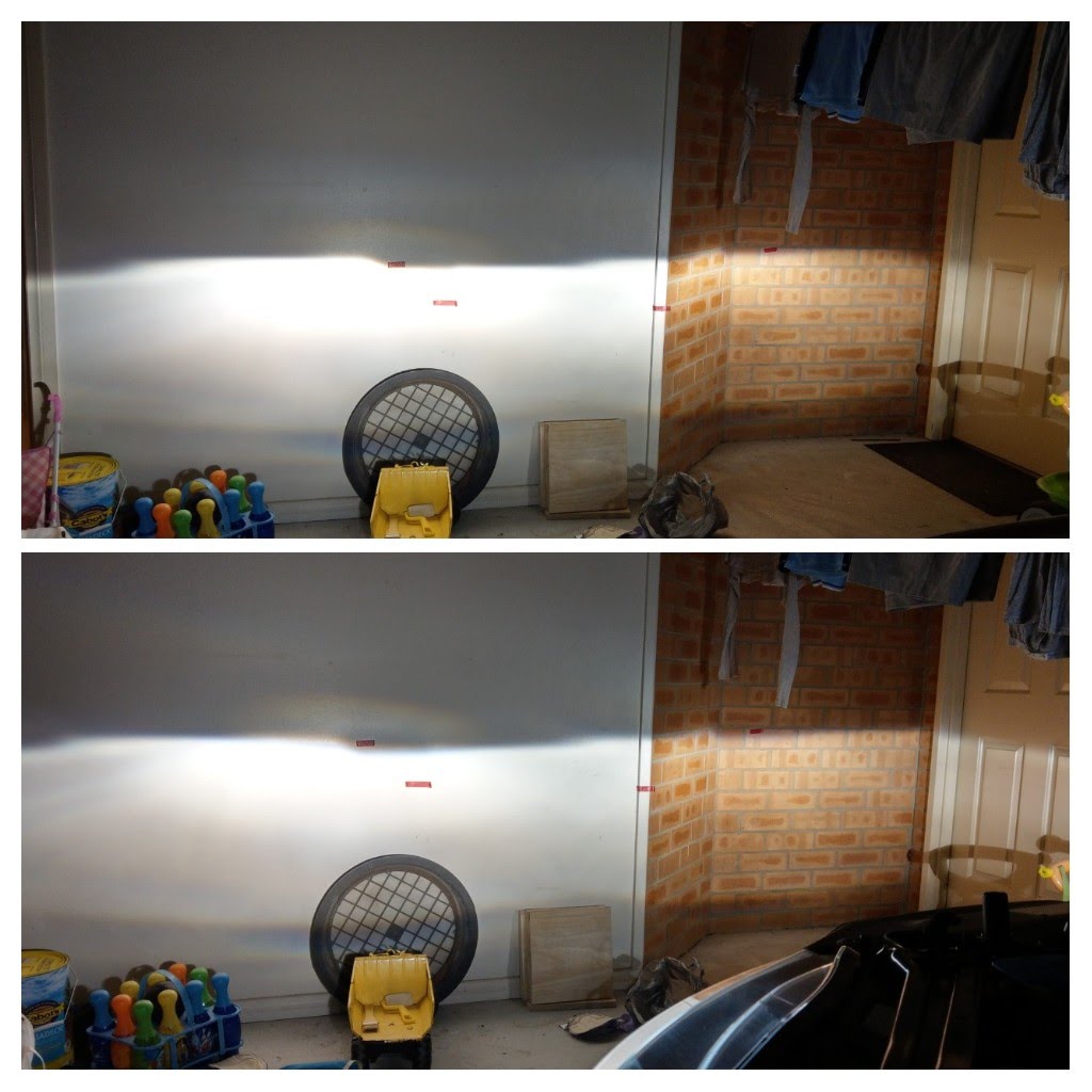

  • again, all installations/retrofits i did myself     Technology/Lights Modifications - Start-stop memory device   - Smart Light Assist (SLA) retrofit  (P/N: 3V29410

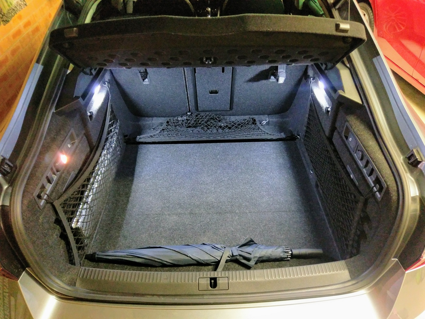

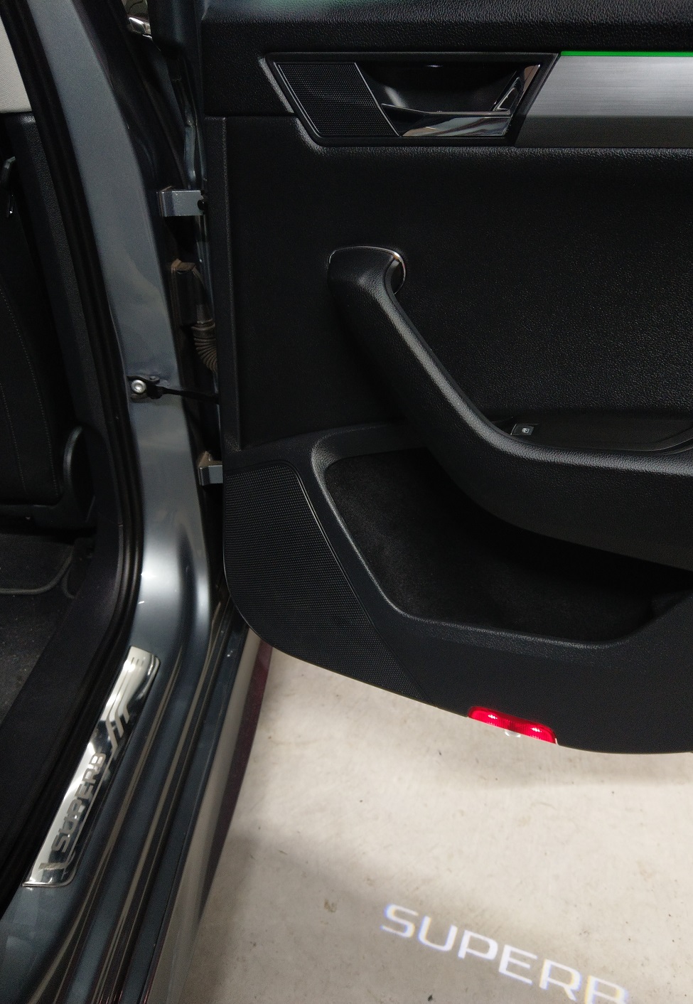

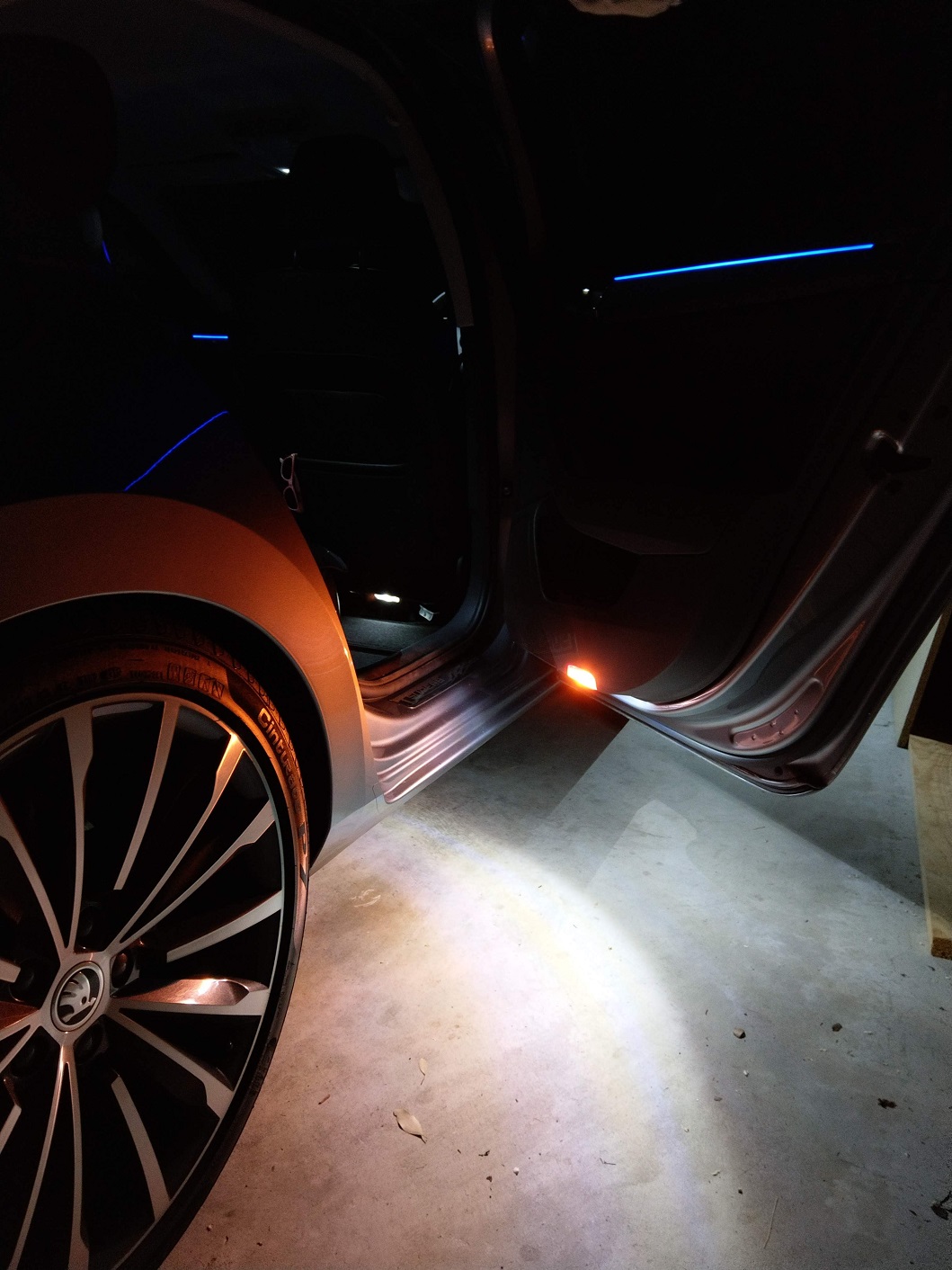

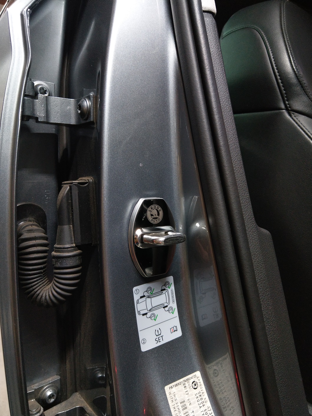

  • Latest retrofit completed successfully - illuminated door sills They're the geniune Skoda ones.   Its a lot of hassle for "illuminated door sills", but i like how it looks.  adds a nic

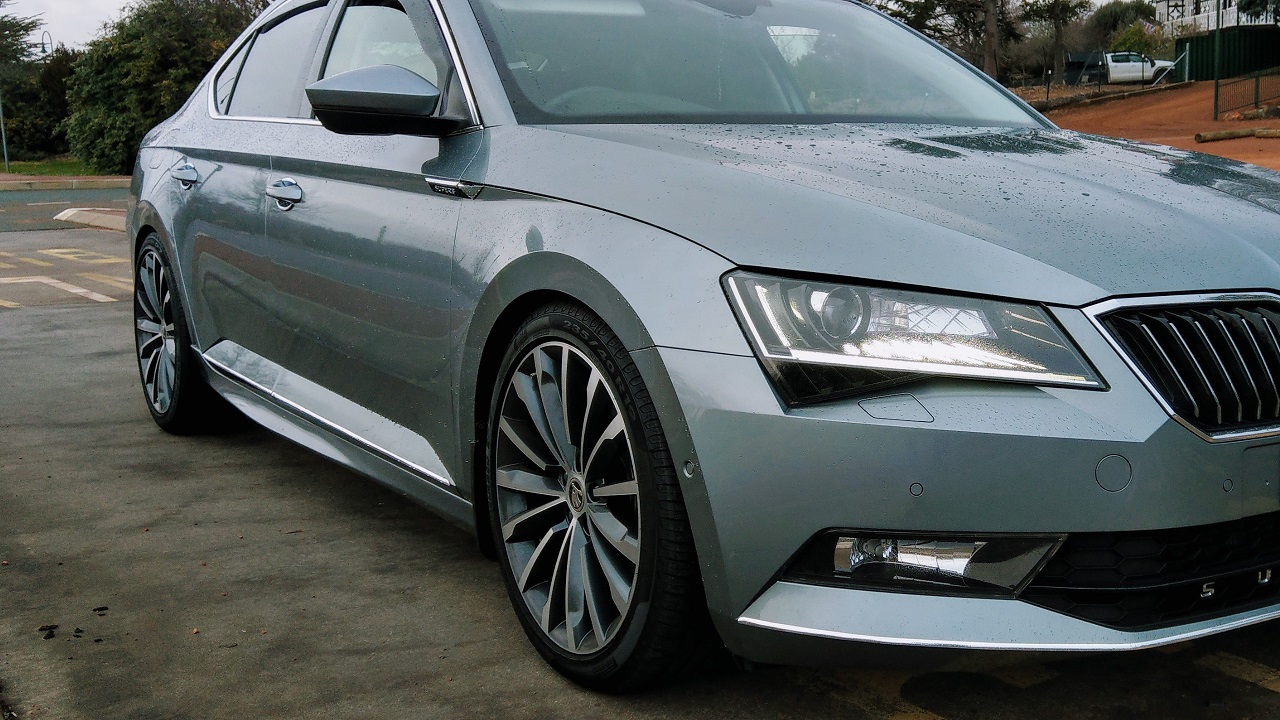

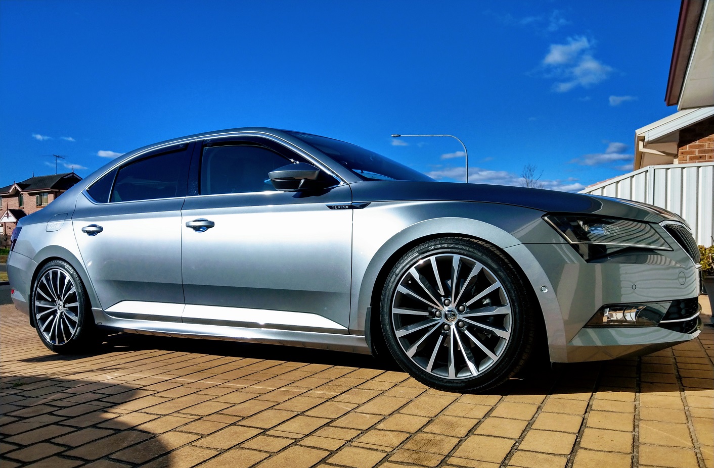

  • After 6.5 years, decided to change Gandalf's personality.   Really pleased with how these turned out, and the fitment is spot on. Rotiform LAS-R 19x8.5 ET35 Matte Black finish.

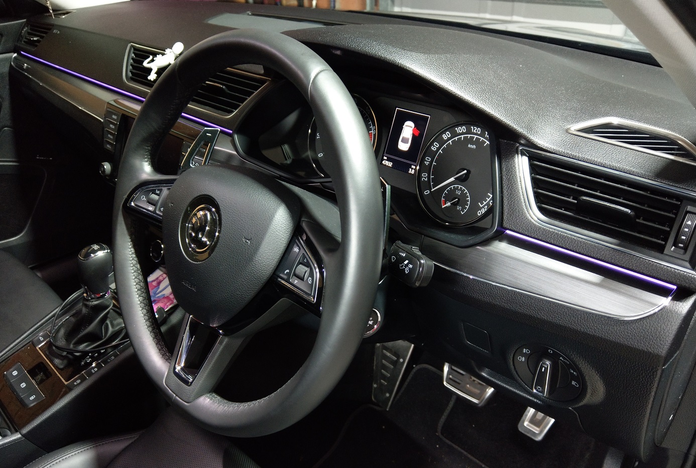

- Chrome strip across dashboard.
flexible chrome strip placed it between the silver trim and the black plastic.  above the glovebox, and above the headlight switch.

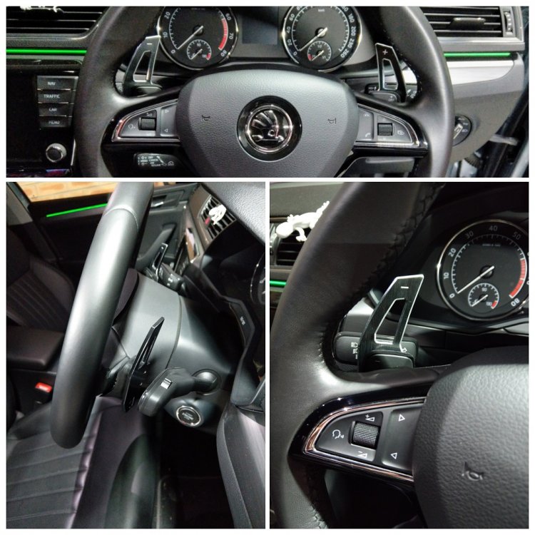

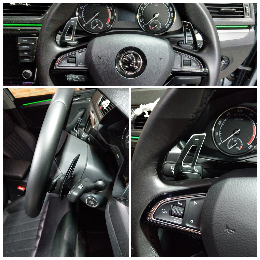

- Aluminum alloy DSG paddle shifter extensions
stick on ones.  been 12 plus months.  still solid and nice feel to it when pressing.

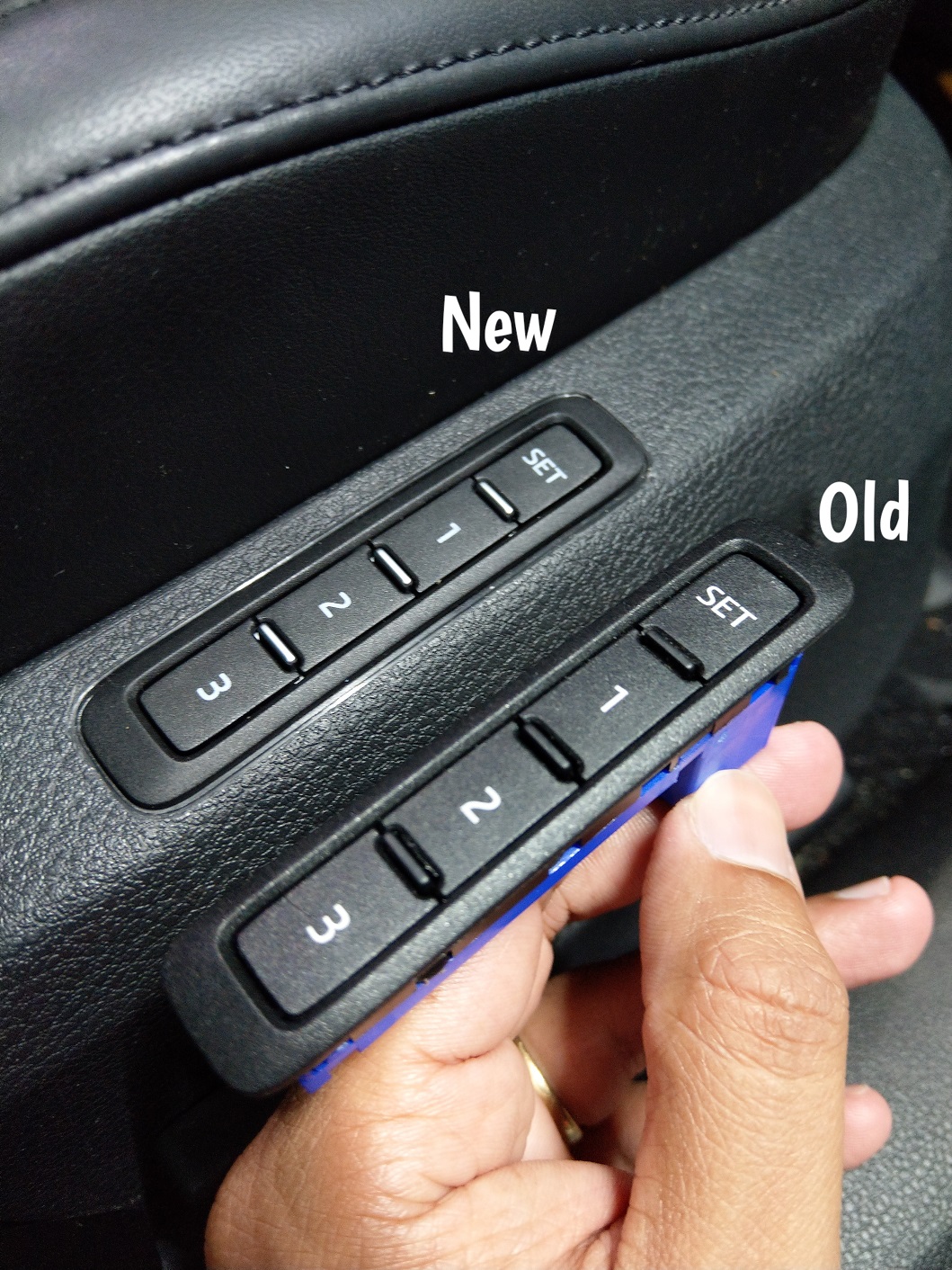

- Chrome Car Seat Memory Switch

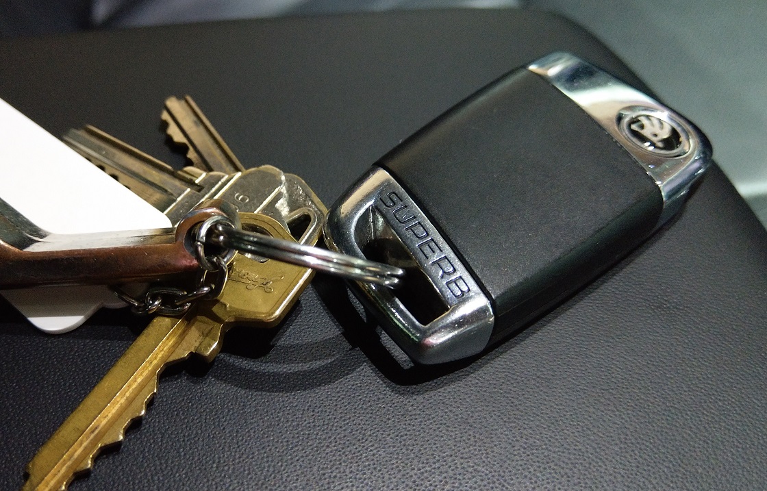

- Key bottom Chrome end tip RS6 style - SUPERB

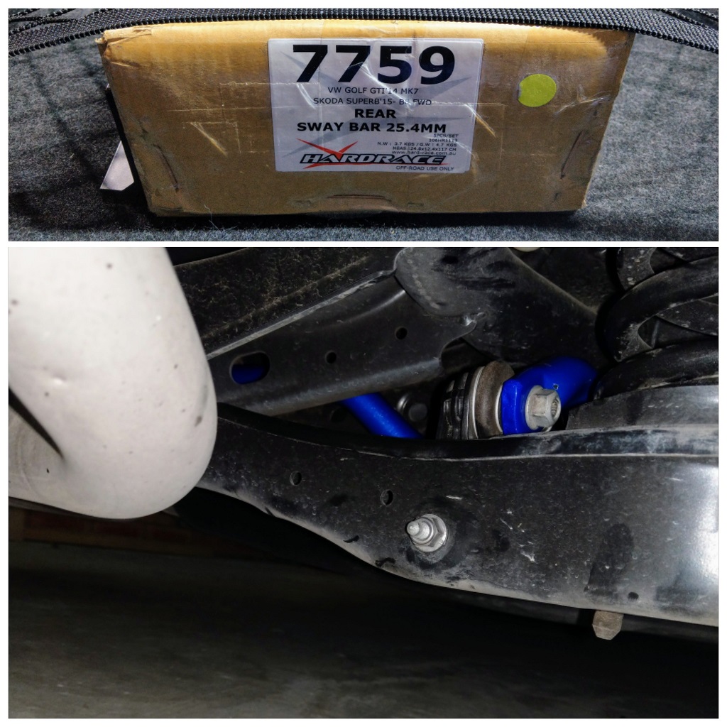

- 25.4mm Hardrace rear sway bar (P/N: HR7759)

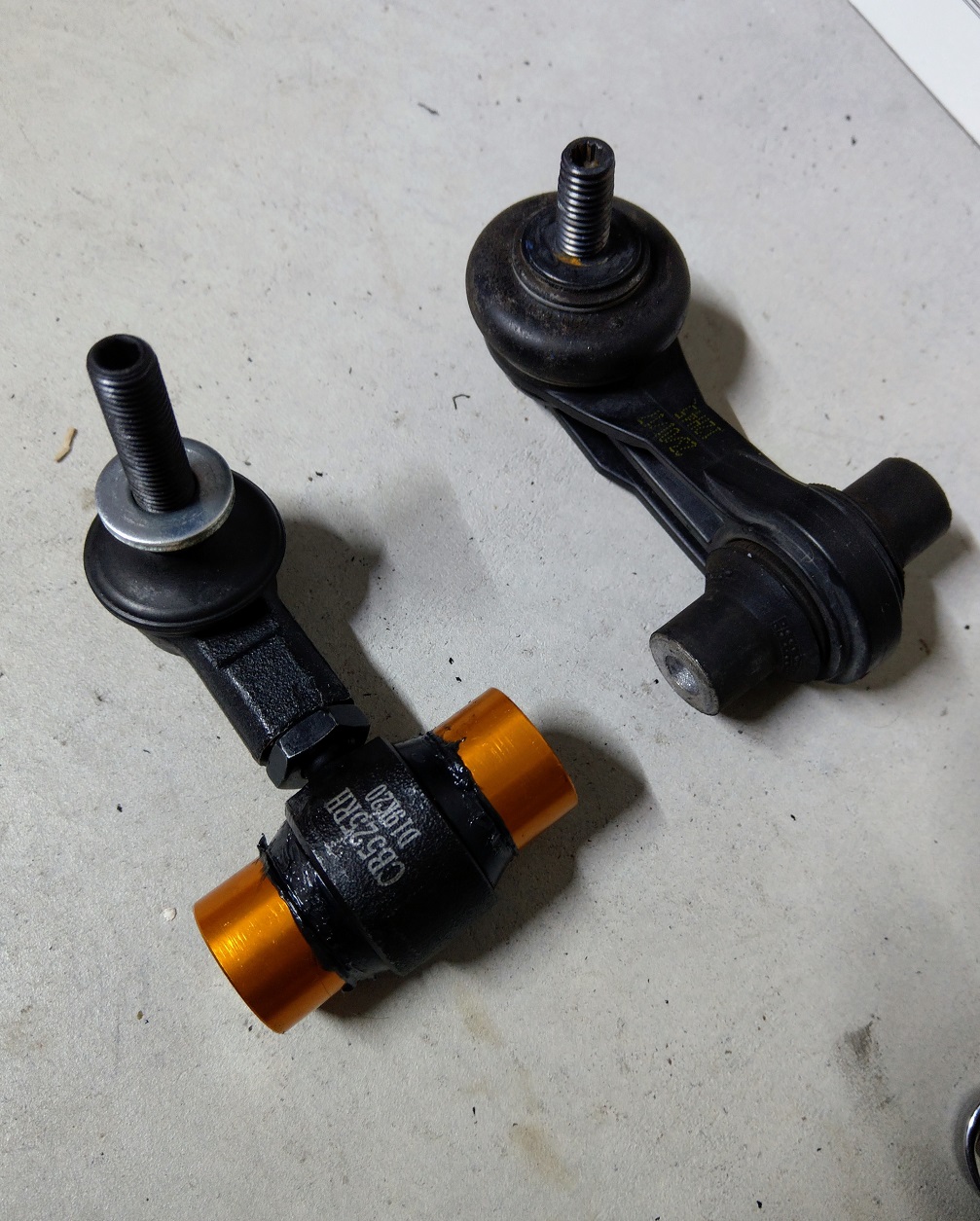

- Whiteline rear end-links (adjustable) (P/N: KLC202)
left = whiteline
right = factory

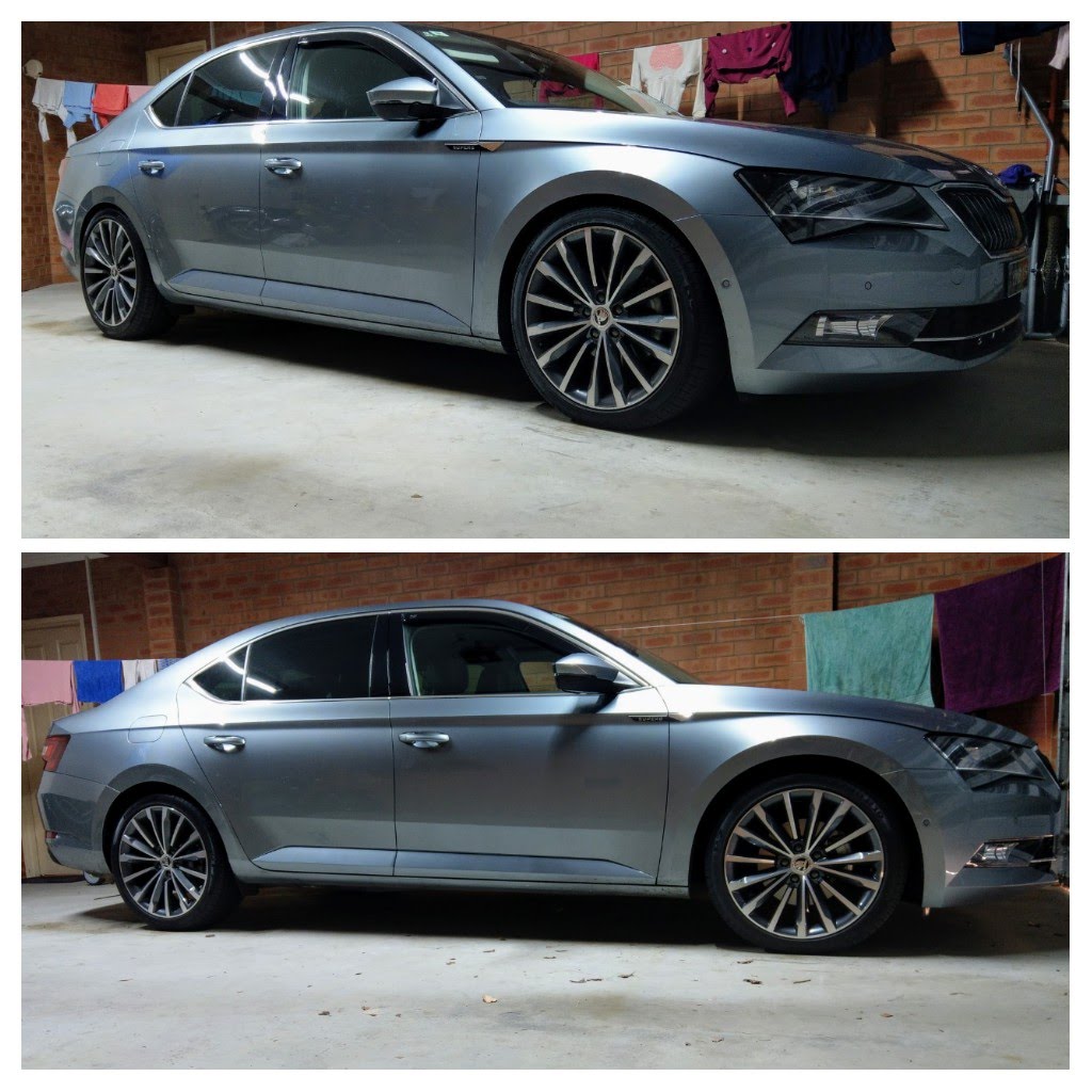

- Eibach Prokit Lowering Springs (25mm) (P/N: 10-84-042-02-22)
top = eibach
bottom = factory

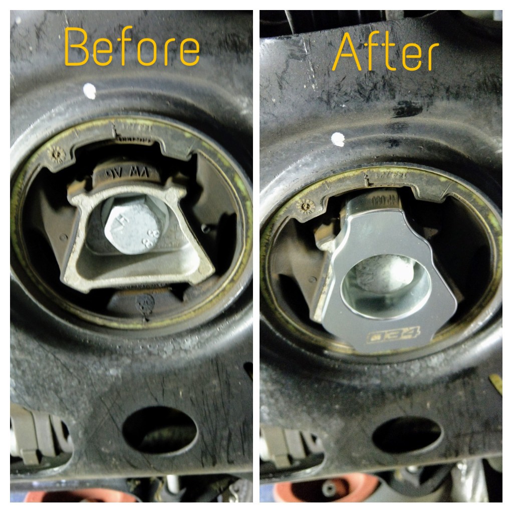

- 034Motorsport Billet Aluminum MQB Lower Dogbone Mount Insert

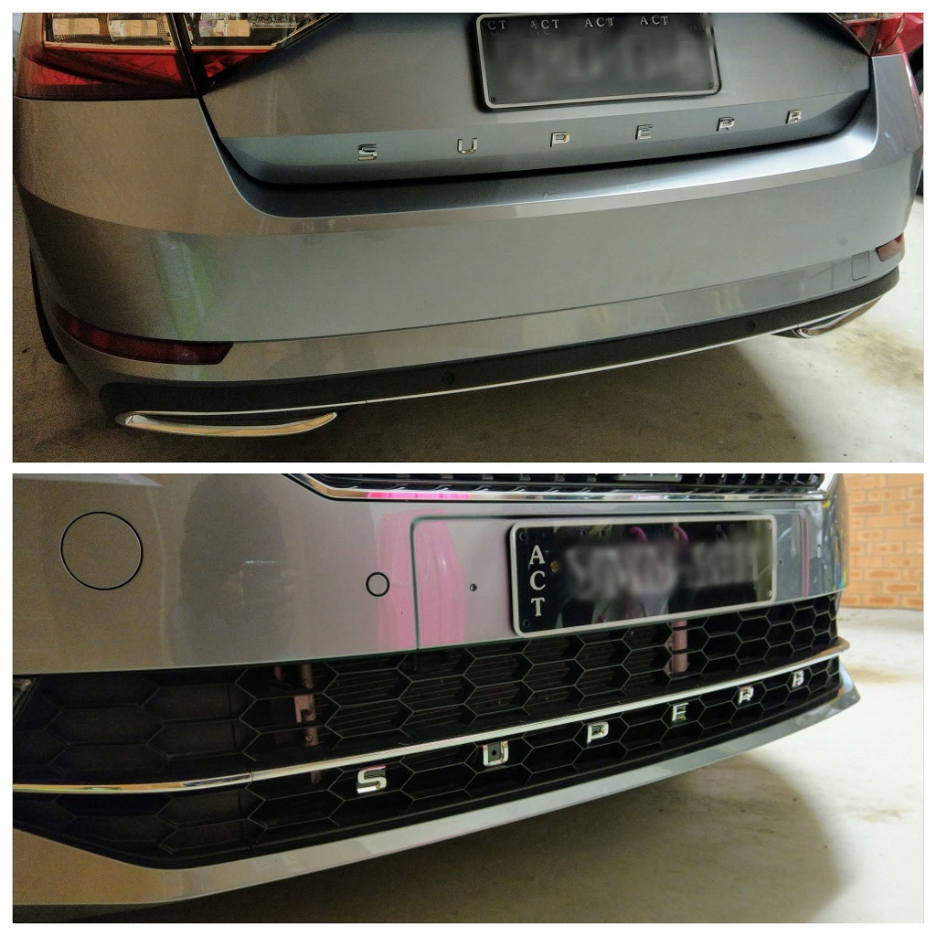

Acutaly, I do really like the large Superb lettering on the front lower grill. Should be factory fit.

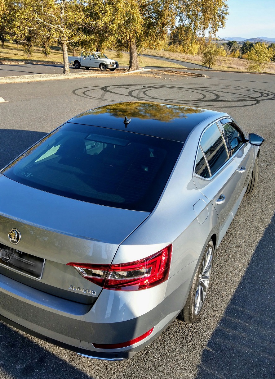

- Roof wrapped Gloss Black vinyl (cost me $450 to get it professionally wrapped)

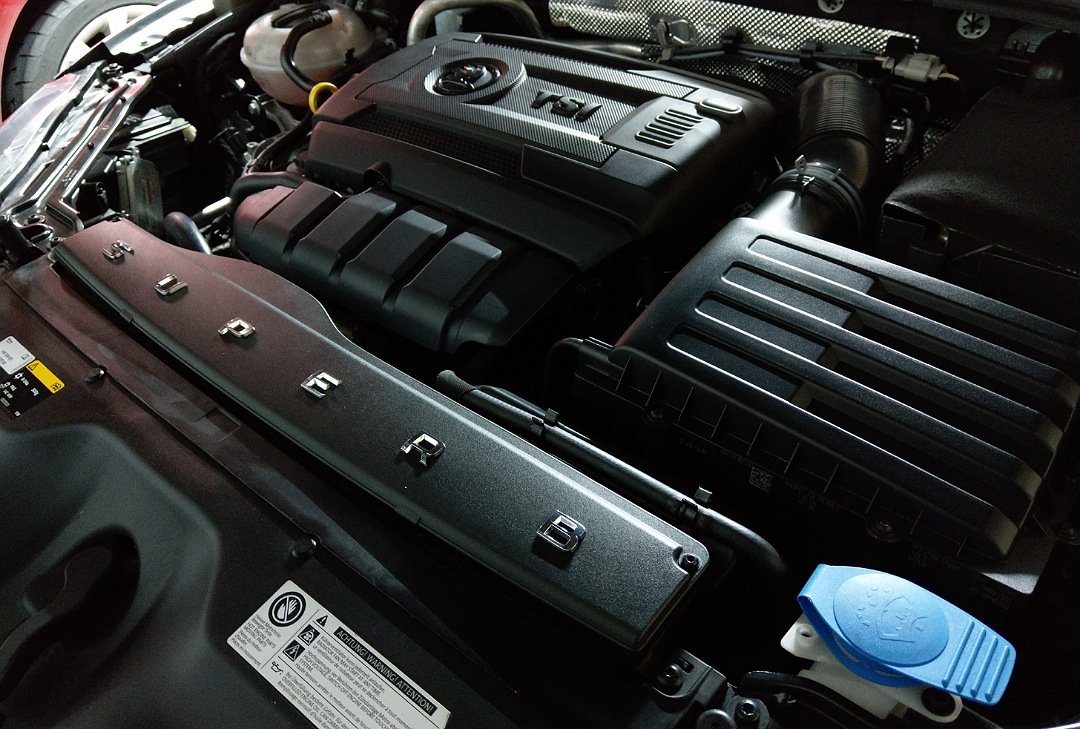

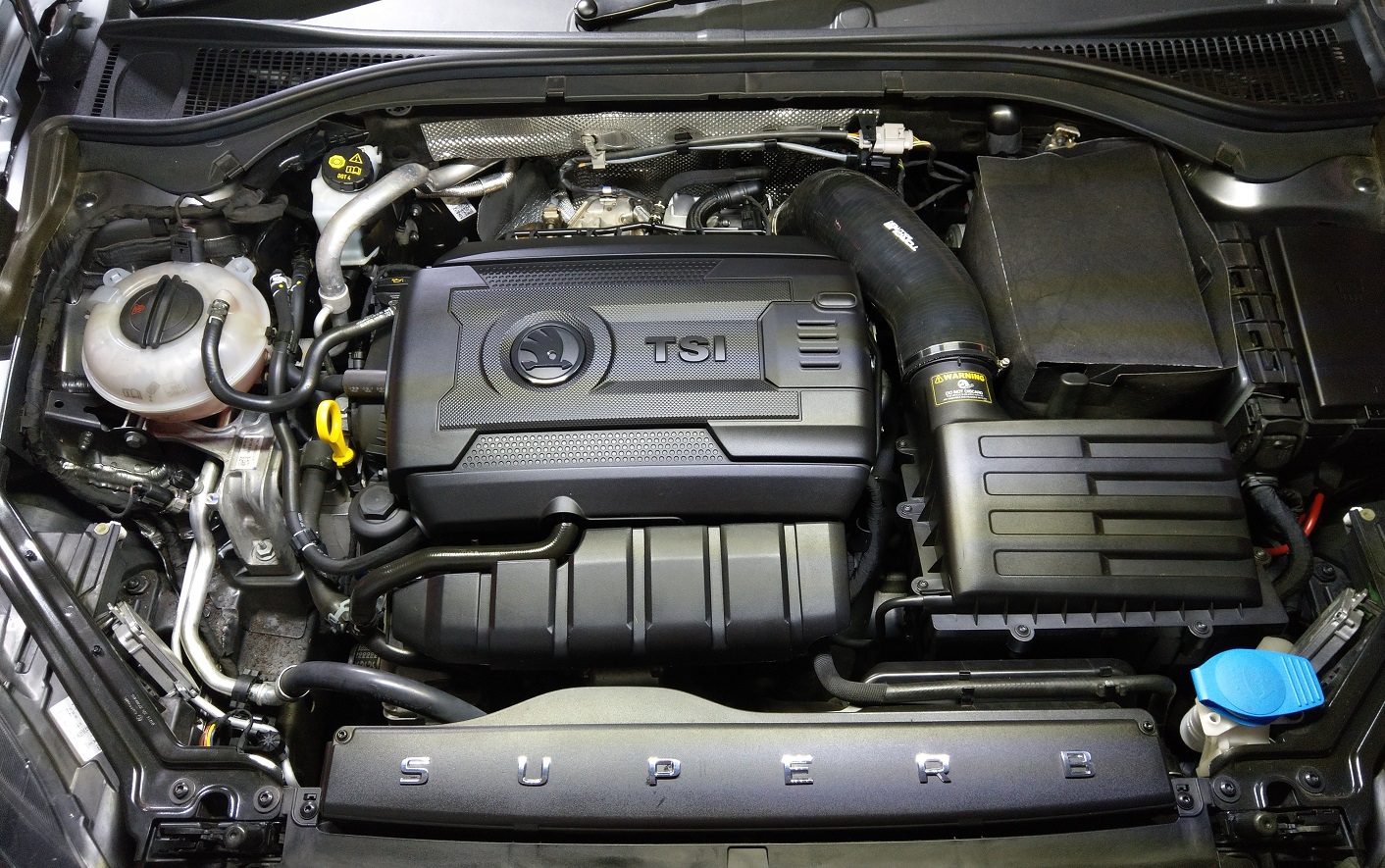

I think you are slipping :nerd: No cover on top of the battery:o
I bought one via Amazon last year which hides the cheap looking felt wrapper thingy. £11 in the UK.
I cut the top bit of  OEM cover to fit the replacement cover which has a removeable panel to give access to the + battery terminal without having to remove the whole cover.
Battery cover

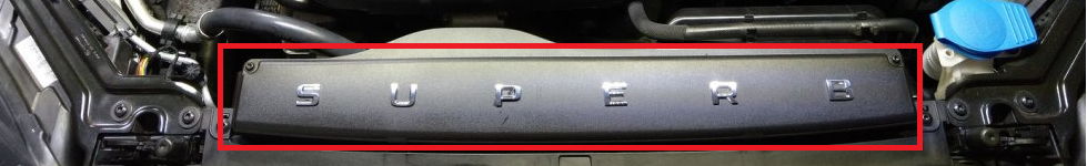

Also, is the Superb cover on top of the radiator standard or aftermarket? Not seen that on UK cars & unless I missed it I didn't see it in your list of mods. Do you have details if aftermarket?
This has given me quite a few ideas. Keep the updates coming:thumbup:
@Colin170CRlol, now that u point it out, yeah, I've let that one slip :D
The engine bay would certainly look much better with the hard plastic version :thumbup:
how is it held in place though? Does it "stay" by simply sitting on top of the battery?

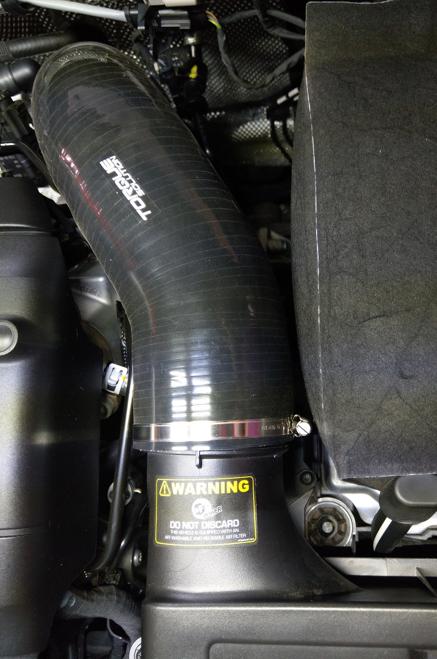

With regards to the air intake cover - it's the standard factory one.  All I did was stick the Superb lettering (that I debadged off the rear bootlid) on it, spaced out ;)
IMG_24082020_221655_(1080_x_729_pixel).thumb.jpg.b821f78b7d02578257d11797c898f1ab.jpg
Edited by JR RS
The battery cover sort of snaps on over the battery. I had to remove the top of the felt flap to fit mine.
Ah for the intake cover. Thought it was an aftermarket jobby which I now see are available from Revo amongst others.
You may find that its the standard MQB platform battery tray underneath, it was on my 2015 Yeti and an OE full battery cover assembly, top and two lower sections was next to nothing from Ali-Express and clipped straight into place, with the OE set up the lid is properly located and clipped into place, there is no chance of it coming adrift.
It looks much neater with the correct plastic sides but the aftermarket push on upper cover looks as decent as the OE one.

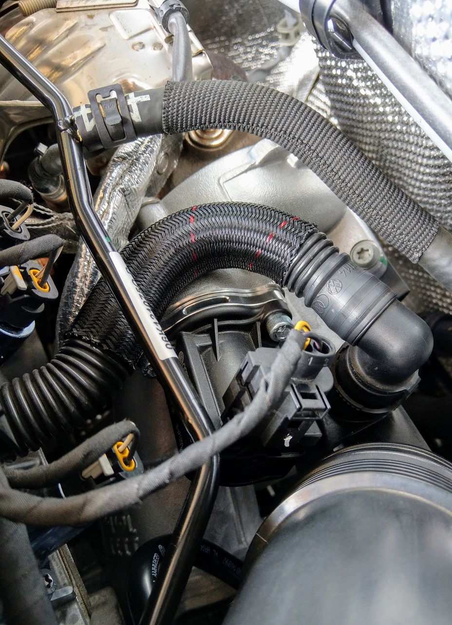

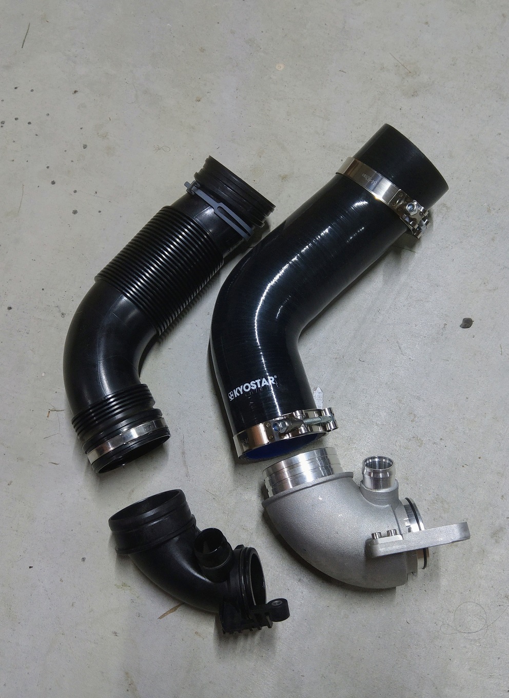

Apart from the fact that it doesn't snow much in Aus & I appreciate you also have a different air filter & modified air intake, but does removal of the snow baffle in the filter box provide any other benefit e.g. increased airflow / bhp?
Also, does the new turbo elbow give you much in the way of increased response / power.
Removing the snow filter didn't make any difference to the power delivery or feel, or induction noise.
It was more about knowing that having it removed would allow an uninterrupted airflow through the airbox.
With the turbo inlet elbow - can't really say there was a noticeable difference on its own.
In combination with the inlet pipe, and air filter - it definitely felt more eager.  It didn't feel like hesitation, and would want to keep urging u on for more :)
the car throttle also seems a bit more throatier.  There is more induction noise.  I like how the engine sounds now :thumbup:

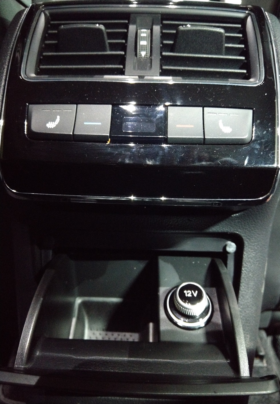

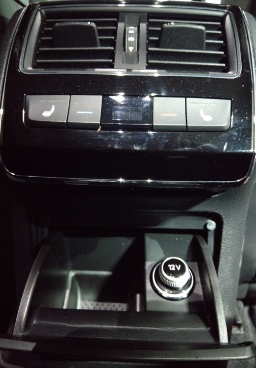

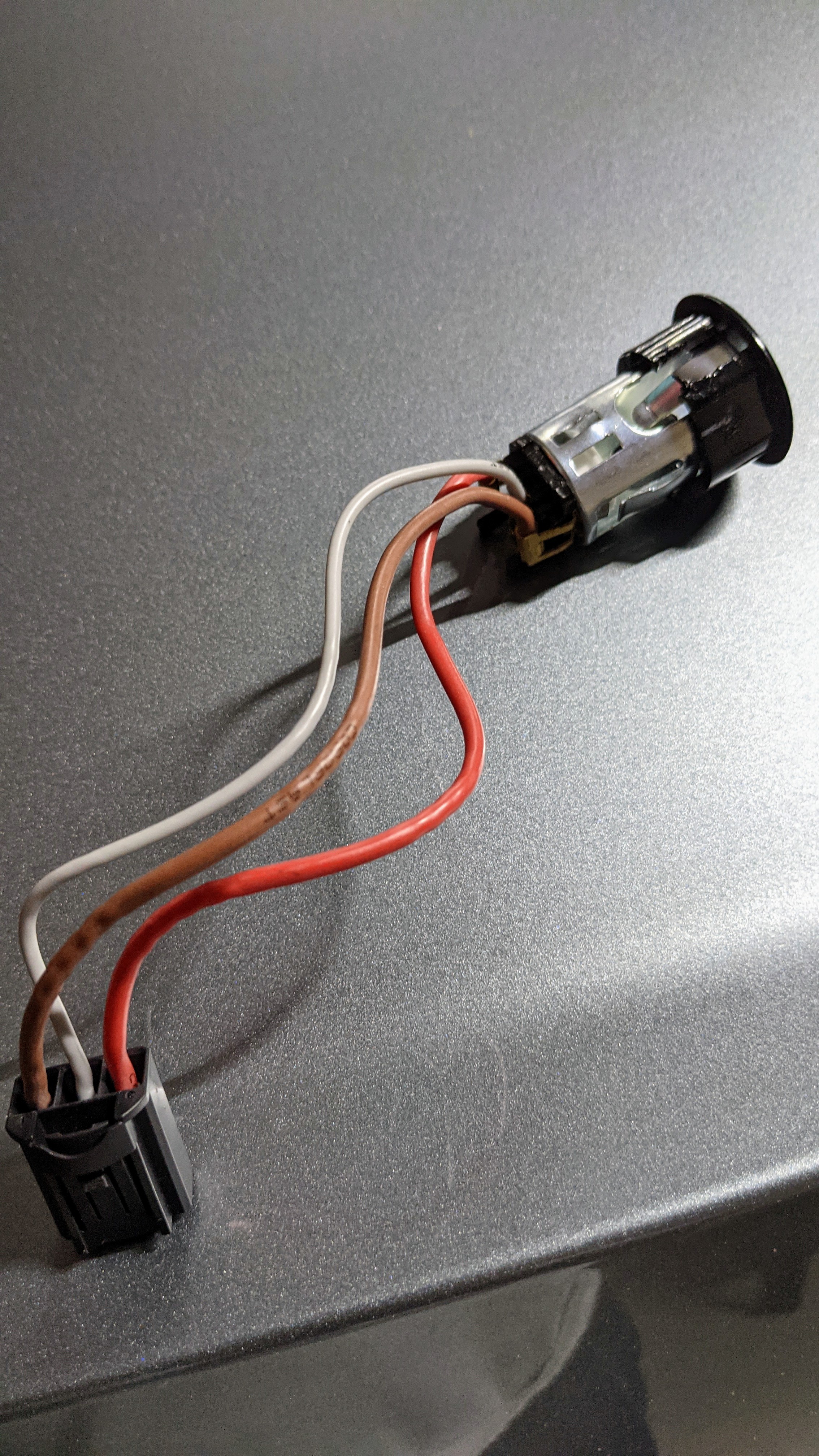

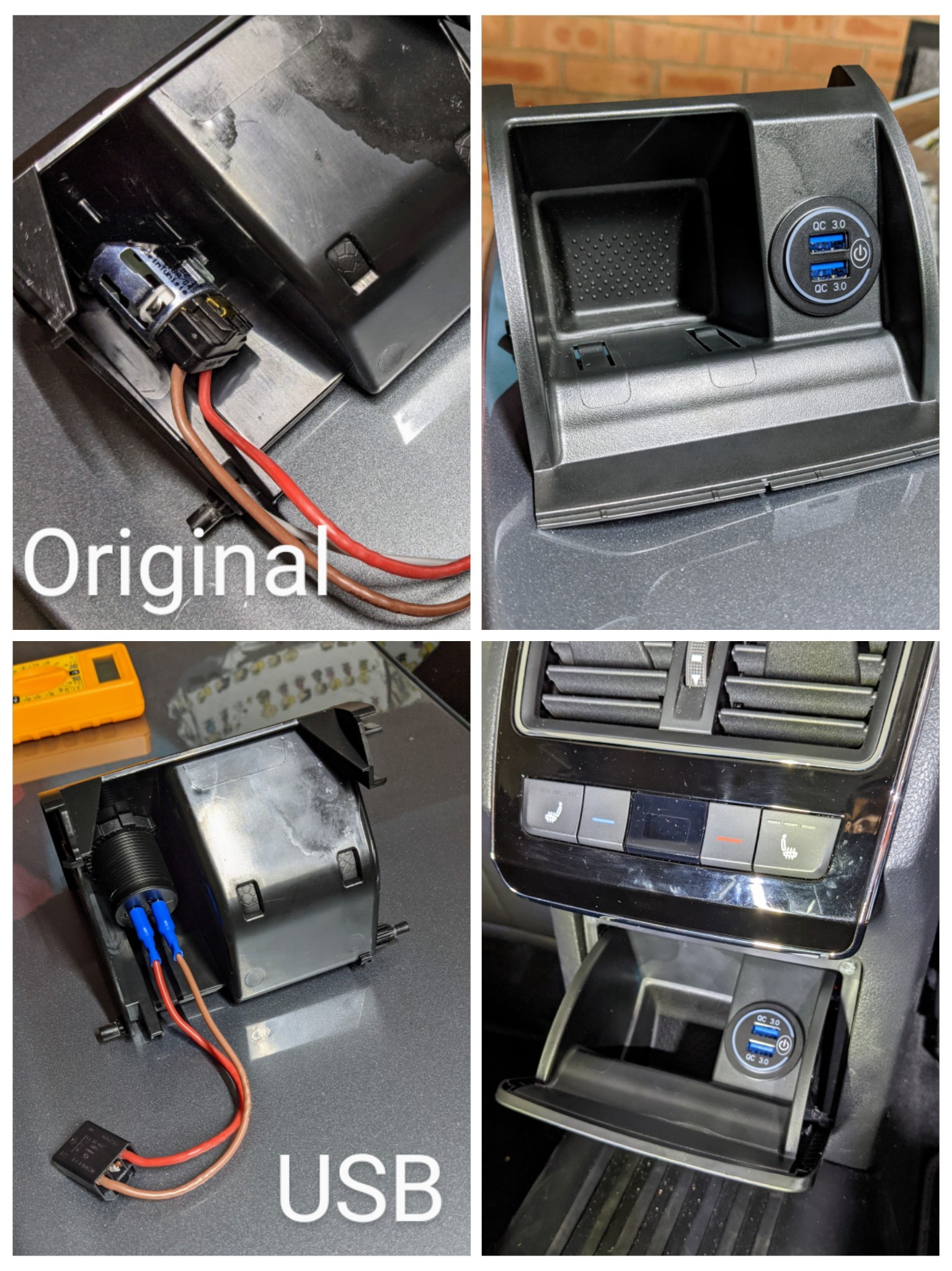

Completed the rear console 12v socket to a dual port USB.
Was nice n simple to do.  Clean finish.
Happy with it :thumbup:
Very neat idea. Is it easy to remove the tray unit?
It was relatively easy to do.
The front cover unclips easily from the top, then unhinge from the bottom.
The actual tray has two hinges at the bottom - the right side pops up, allowing u to slide the left side out.
Then unclip the wire plug to the car, and u can then proceed to freely remove the 12V socket from the tray.
The replacement USB socket fit perfectly in the existing hole.
Edited by JR RS
