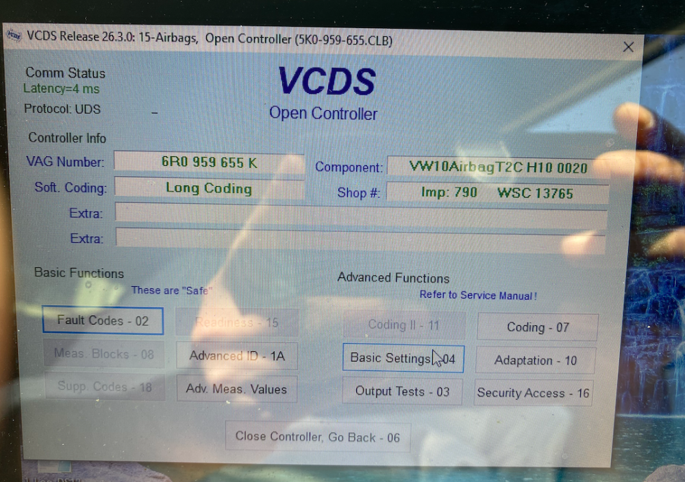

Hi Experts ,
Can some body please confirm if AIRBag part number is correct as per attached screenshot of vcds ( 6R0959655K) for Fabia Mk2 13plate Monet Carlo 1.2 Tech tsi.
Thanks in advance.

That is the airbag control unit part number, and it is correct for your car.
partslink24 also has the "T2C" string seen in the Component field of your screenshot, as a further suffix after the 'K'.
Shown as "6R0 959 655 K T2C"
I would suggest that this is the original unit, but can't be certain.
Before you ask, I have no idea about coding, or what T2C means, or anything much at all about airbag systems, sorry.
