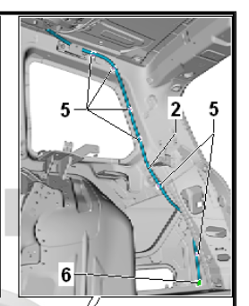

Does anyone know if the drains can be cleared from the top of the car or must it be done from the bottom? I understand this involves removing the bumper.
Workshop manual says that it should be cleared from the bottom, not from the top, but yes, rear bumper has to be removed. However, the manual also states that installation of new hoses does not require to take off the rear bumper. I think you might be able to reach the lower end behind the cover of rear fenders. We did the same with Passat.
