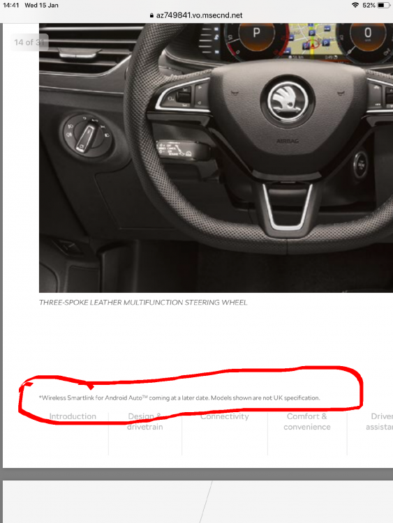

The brochure clearly states ......
THIS FROM THEIR SITE
Both the SCALA and the KAMIQ now enable drivers to connect a smartphone to their car using wireless technology. They are the first models from the ŠKODA family to offer the new Wireless SmartLink technology, which makes for even more convenient use of Apple CarPlay or Android Auto. In conjunction with the inductive charging feature of the optional Phone Box and the cordless connection to the vehicle aerial, this even enables completely wireless in-car smartphone use.
Up until now, ŠKODA drivers had to connect their mobile phones to their vehicles via a USB cable in order to be able to use the brand’s SmartLink technology. Selected smartphone apps then display on the infotainment system’s screen and can be controlled while driving. However, the optional Wireless SmartLink technology for the compact SCALA and the new KAMIQ city SUV is now making smartphone integration and use even easier and more convenient.
The first time a smartphone is used, drivers have to establish a connection to the infotainment system via Bluetooth. Once this has been done, the phone will always connect automatically via Wireless SmartLink as soon as the driver enters the car, provided the Bluetooth function is activated. The smartphone is paired via Bluetooth; the data for mirroring is transmitted over Wi-Fi. If the smartphone is placed in the optional Phone Box upon entering the vehicle, it connects to the infotainment system as well as to the vehicle’s outside aerial to ensure optimal reception and is inductively charged at the same time.
...but it doesn't work and no time scale when it will. Notice it does not mention that it is a work in progress 🤨

Who's site? Skoda Auto or Skoda UK? Do you have a link?
As mentioned by Kenny R, Skoda can put whatever they want in their online and hard copy content, if they then cover themselves with clauses stating that it isn't yet available in all markets.

I only wrote to Skoda(UK) yesterday but I have just had lengthy, informative and helpful phone call from Phil from Skoda (UK). He called me rather than respond in an email, so we could discuss the issue with my Kamiq.
As was anticipated, the Bolero unit is not as capable as the Amundsen, but the reason I cannot connect my phone to the WiFi is that Android Auto is currently only wireless on a fairly limited number of high-end relatively new Android phones. This is not the case with Apple Phones and Apple Car Play which is apparently routinely wireless enabled. The 2 Android phones I have available are relatively new, but would be described as 'budget' examples, so are not enabled for wireless Android Auto.
I am now investigating to see if a work-around is available, but in the meantime I will use a USB connection with my phone for Android Auto.
