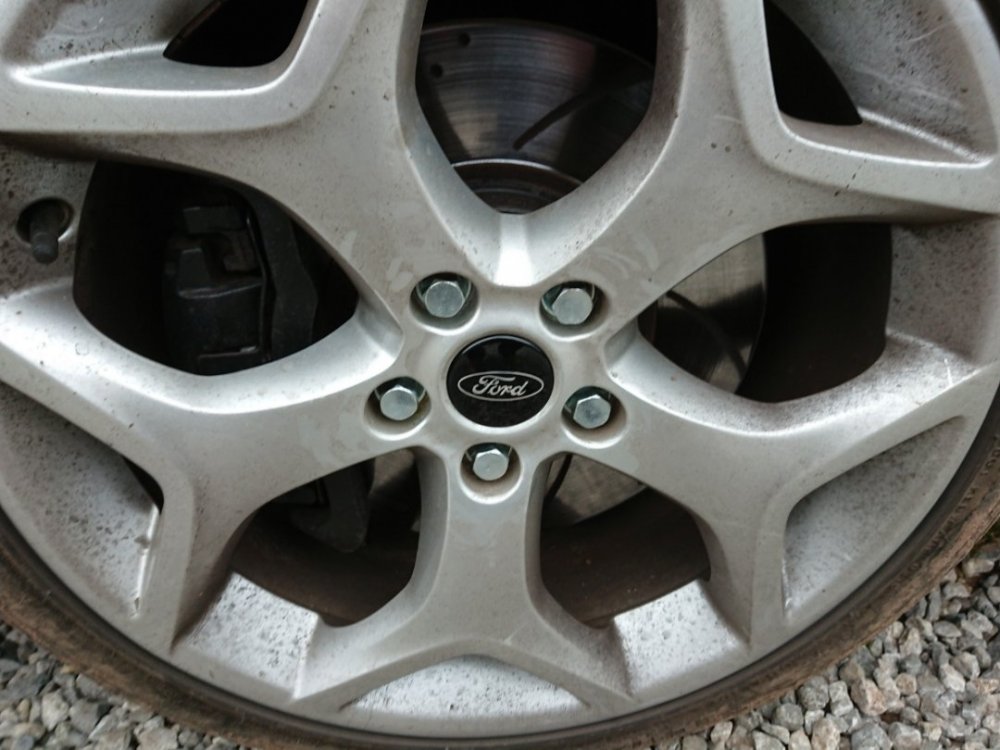

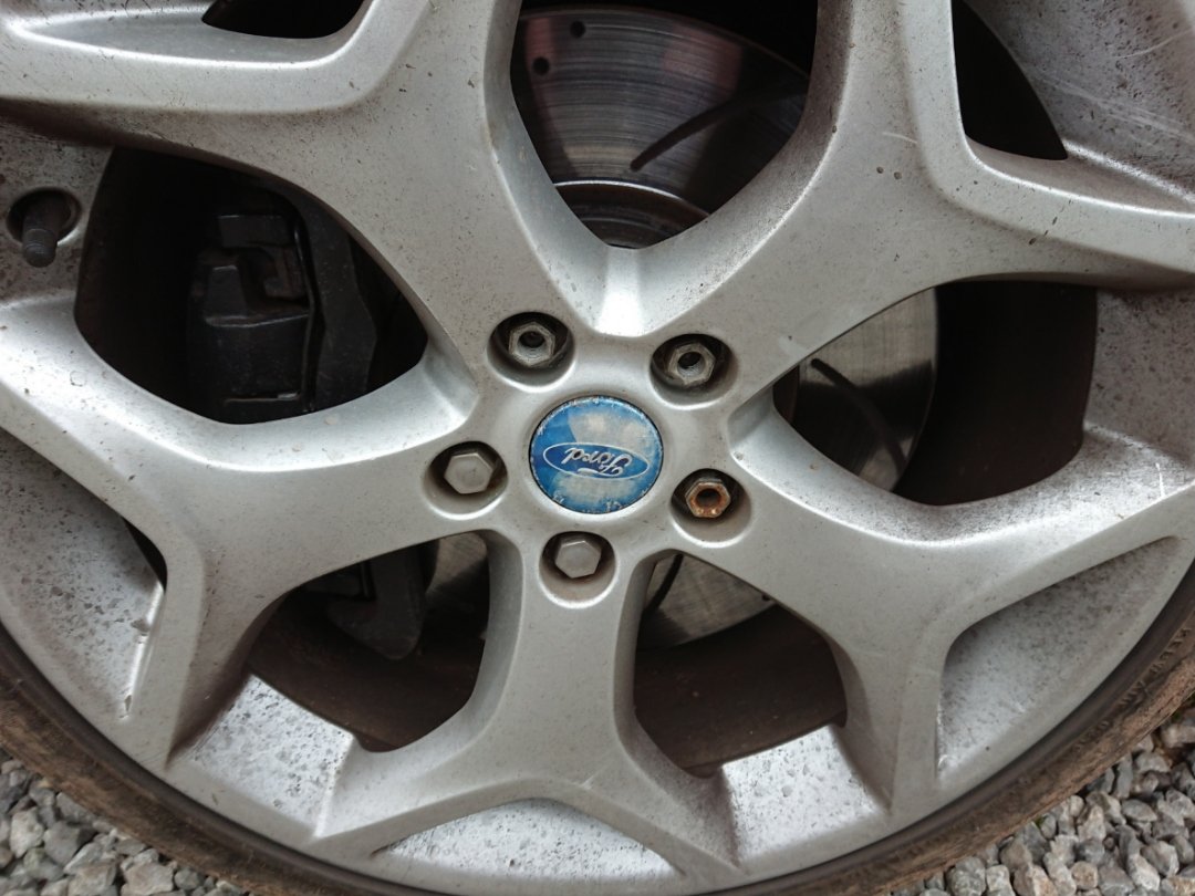

Unfortunately this is a ford thing although it's not just that the nuts swell the chrome caps deform as well, the first thing I did when I got my focus st home was replace the original nuts with chrome covers with some decent solid capless nuts.

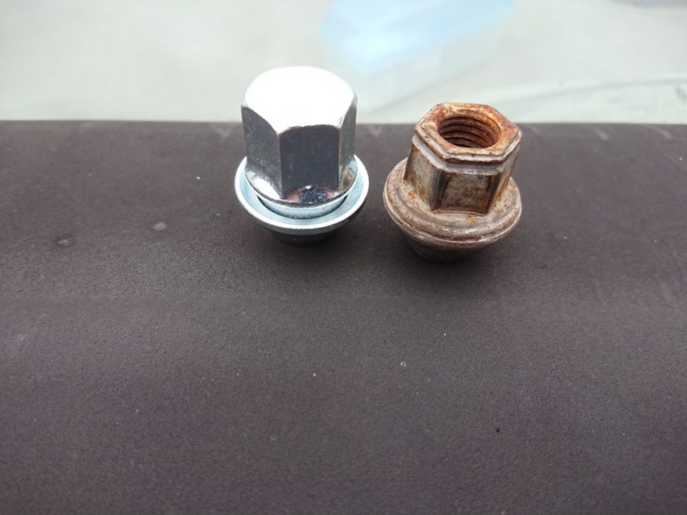

The standard ford nuts are open ended and 18mm, the chrome cap they bodge over takes them upto 19mm. Over time and and poor tool usage they start to twist and and deform, so the 19mm wheel brace no longer fits over them but with the caps removed its too big for the 18mm nuts.
Here is new new replacement next to the original nut - the cap.
