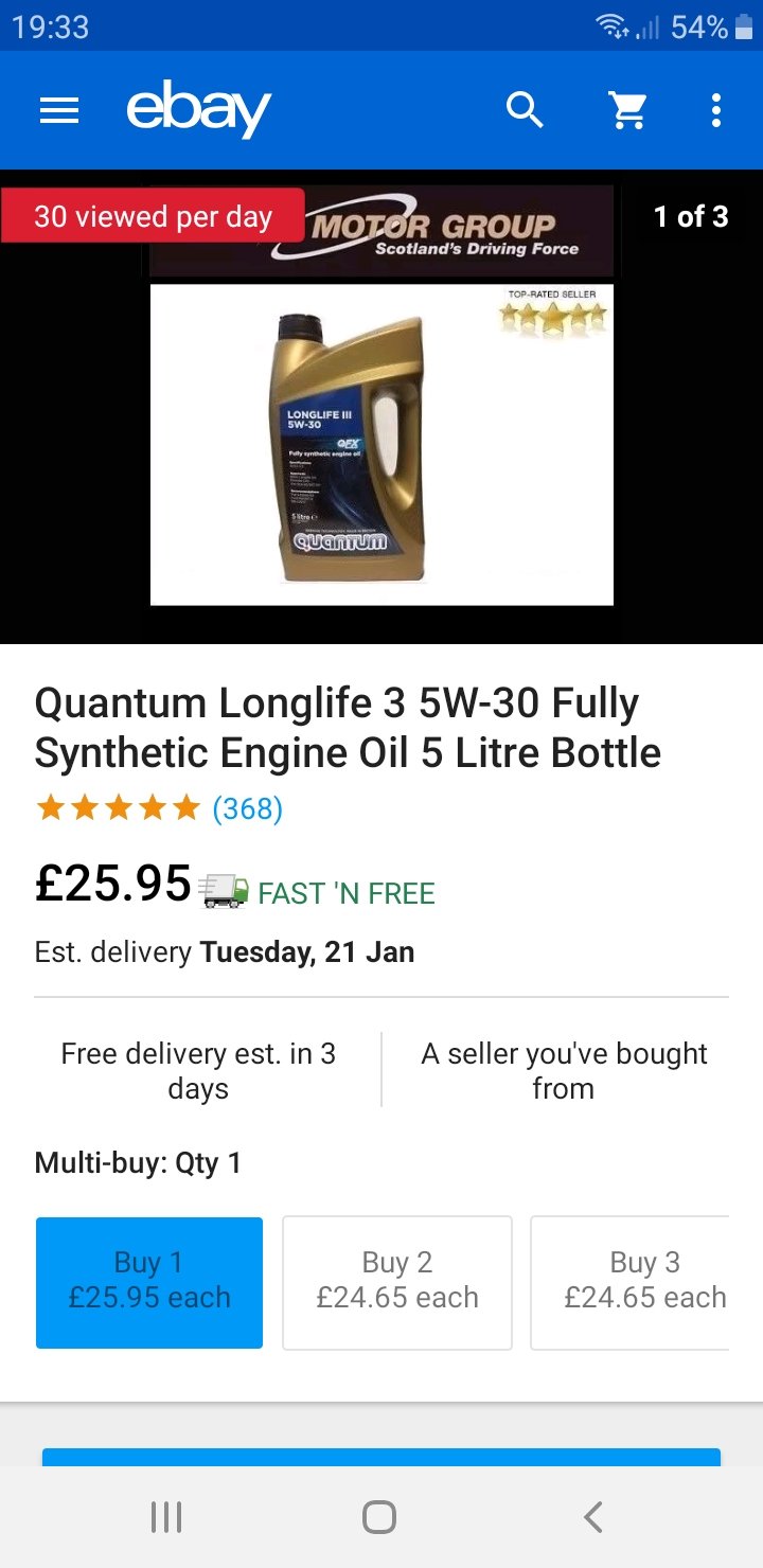

Quantum Longlife III (5W30), which is the same oil a lot of franchised Skoda main dealers use. It is VAG's own brand.
Here is 5 litres delivered from a Skoda dealer for less than £26...
https://rover.ebay.com/rover/0/0/0?mpre=https%3A%2F%2Fwww.ebay.co.uk%2Fulk%2Fitm%2F254332069498

Great price, just i would never give Parks of Hamilton my money.  I would cut off my nose to spite my face.
Arnold Clark number 1 stealers & Parks are right behind them.
Popping into Asda or any Supermarket or just a Local Motor Factor for oil to VW 507 will do so that is 5w 30 Full Synthetic III  (Long Life)
It is just Diesel oil for VW engines after all.
