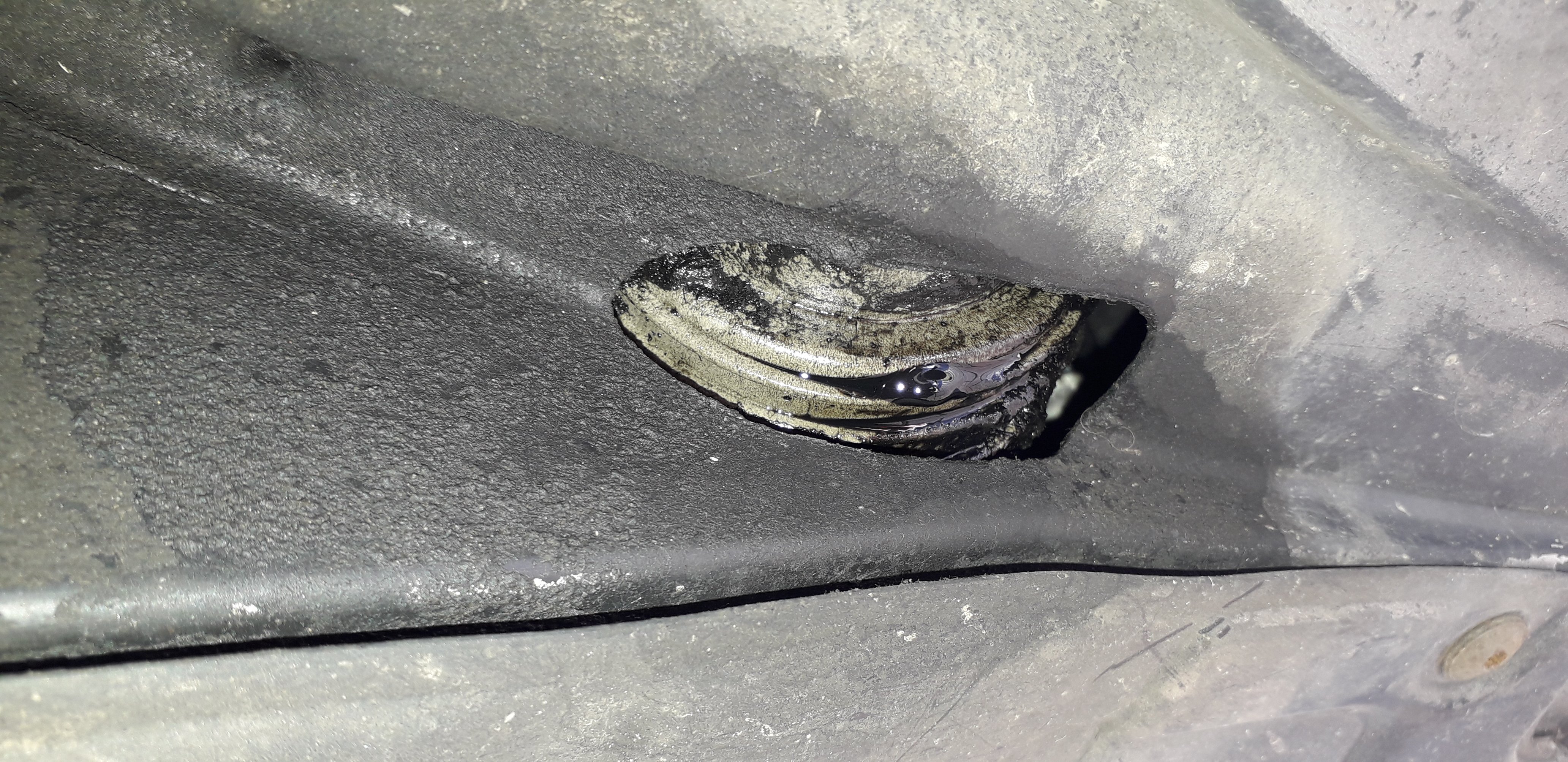

Is this a serious issue?
Hello everyone. It's been a while since I was on here! I was the original owner of the Fabia VRS LE #19 back in 2007 but unfortunately had to exchange for something bigger due to family commitments.
I recently just purchased myself another MK1 Fabia VRS due to its low mileage (50k).  However, I think I may have been to hasty as I didn't do much diligence work and have noticed this oil leak(?) on the underside of the engine.
Can anyone tell me if it is serious?
Thanks in advance.
Do we get a prize for guessing correct?
Not sure why there is a hole in the tray, or what part that is.
Intercooler connection?

Lol, no prizes mate sorry.
Not sure what it is but I'll try and get a more revealing picture tomorrow and post it on here.

Take the under tray off and all will become clear ;)
It's not serious.

Thanks, can you elaborate anymore on the issue?
A minor oil leak on a 15 year old car is never serious, I can't remember the last time I saw an engine of that vintage that was completely dry, never mind that it's a diesel with notoriously leaky intercooler connections.

Thats just a weeping intercooler pipe, it is not a serious issue at all.
the oil comes from the crankcase vent into the air intake (some of this oil bypasses the seals in the turbo) and gets into the intercooler pipework.
to remedy the issue either vent the crankcase to an oil catch tank or atmosphere and clean out intercooler pipework / replace with new.
or if there is no loss of power (boost leak) just leave it, only an issue if the intercooler connection pops off
