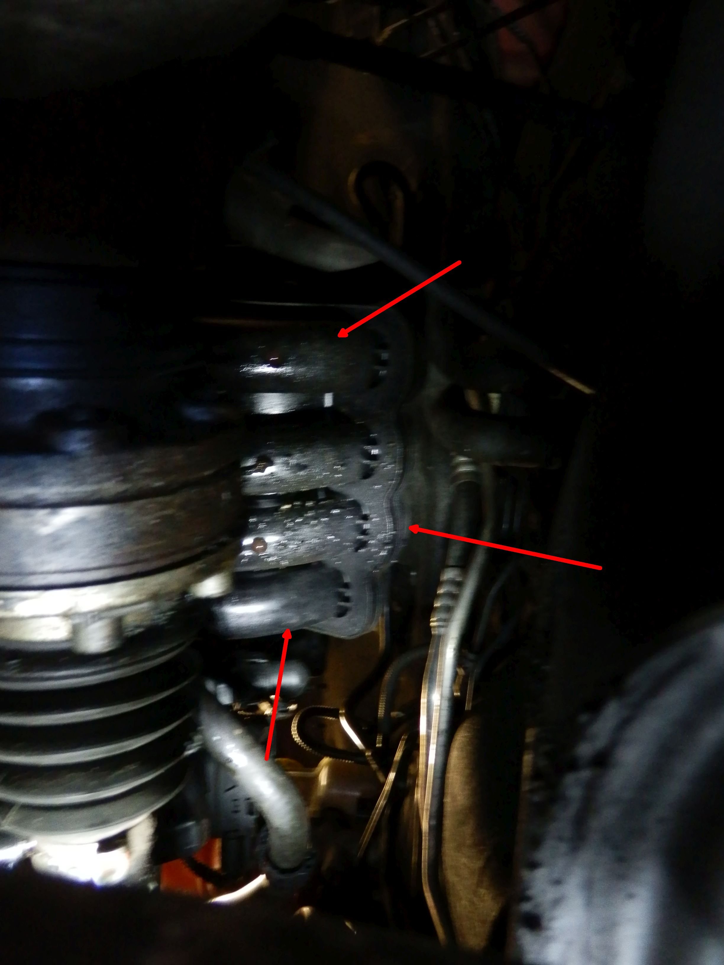

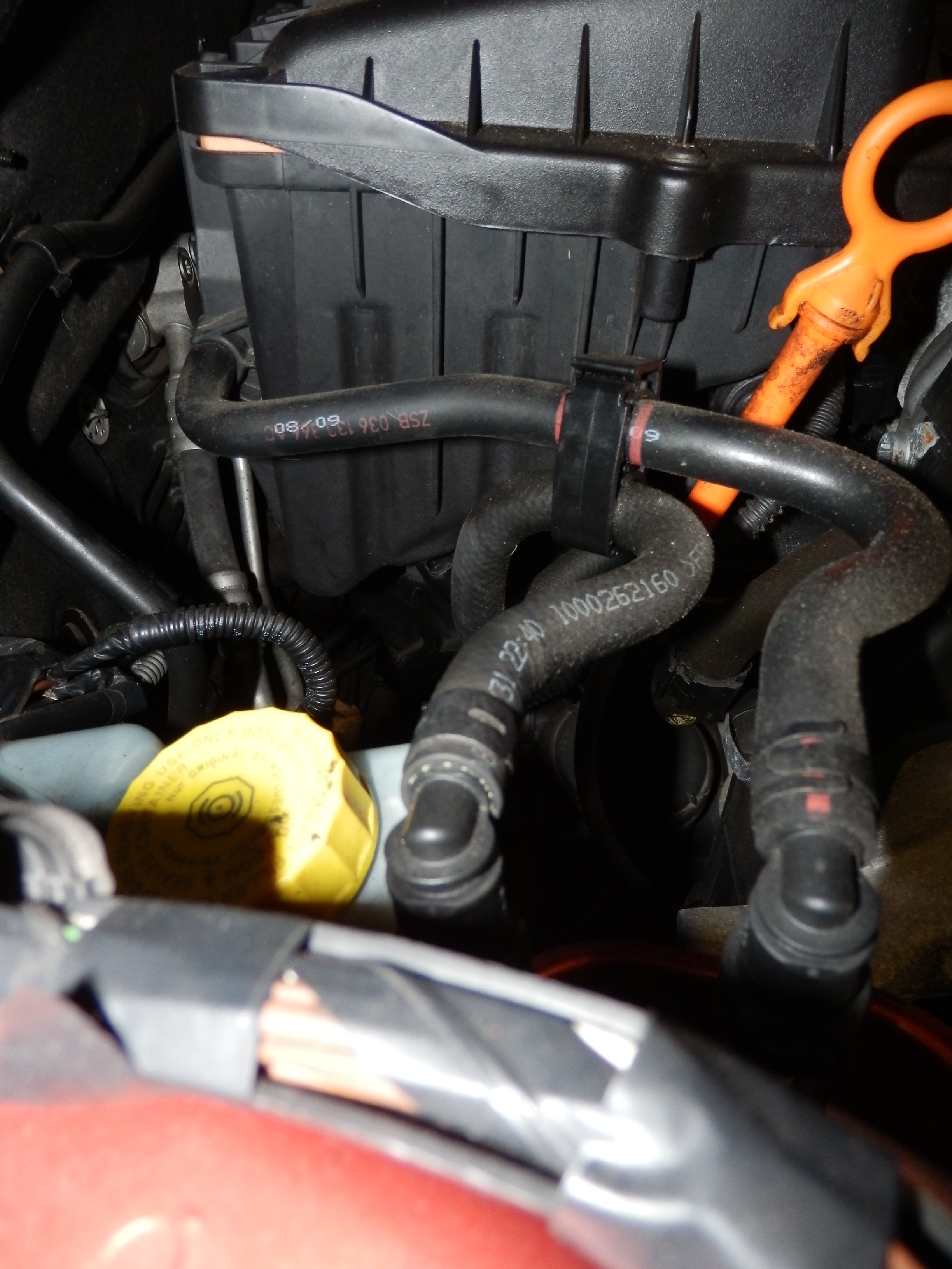

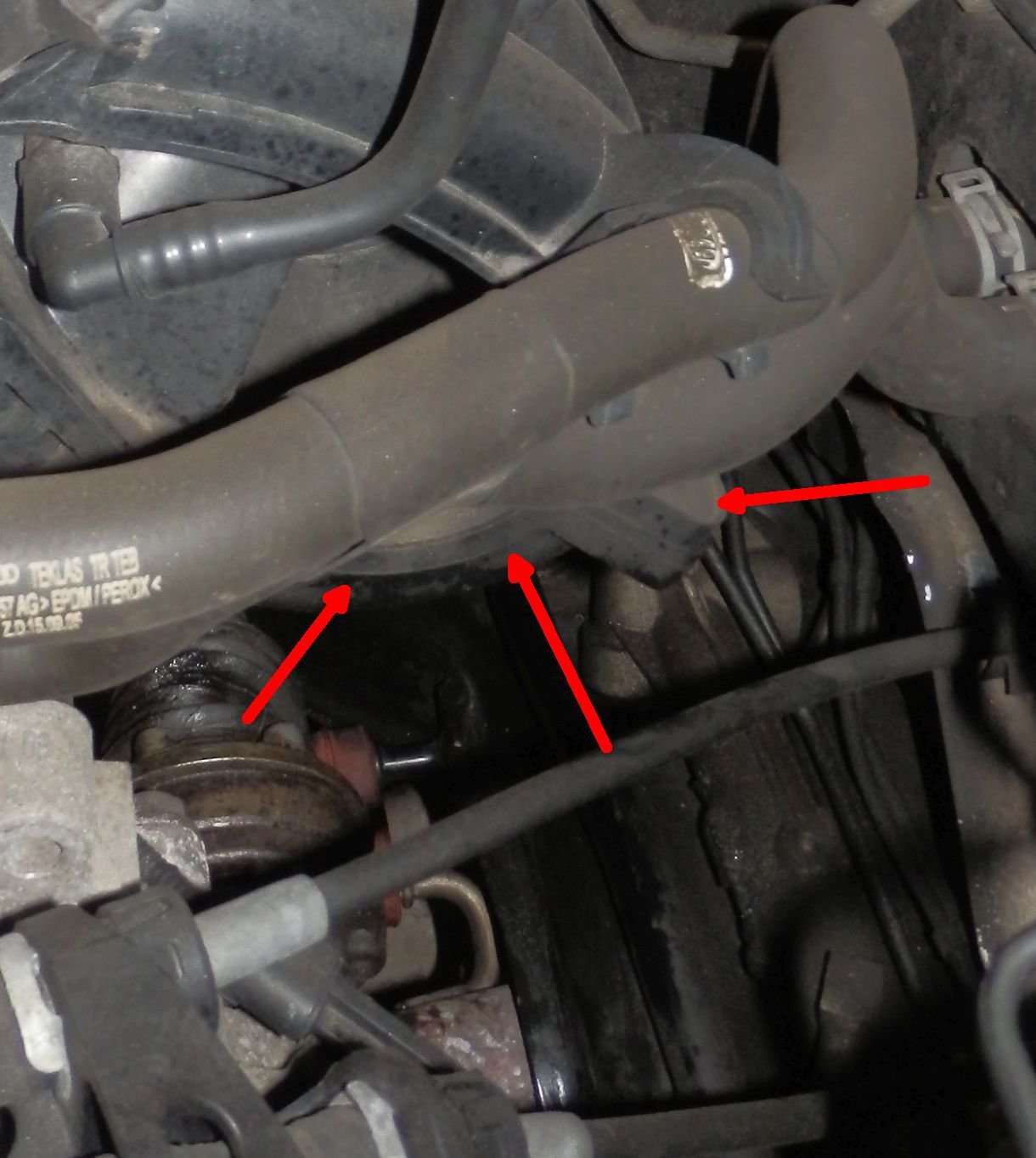

My daughter has the same Fabia, that you are looking at, 2009, 3, 1.4l petrol. We noticed a coolant leak a few months after the sale - could have been old or new.
The 1.4l has a known problem with the air intake preheater - PN 036121188B - which is a pig to get to and fix if it is that. I crawled under the car looking for any sign of leak. Looking up behind the engine block you can see a black plastic structure which almost looks like a manifold. This part likes to split and leak.
We were quoted £120 to fix. I do DIY repairs, but I think it is a workshop job as you take a lot of parts off.
You might be able to reach round and behind it as on the 2. picture to feel for a leak.
Just use the faults to haggle. Front discs and pads are £60 - 80, just replaced, and the timing belt was £350.
View looking up
View from left onto engine
View from right
View looking up
View from right
Thank you, that’s really kind to send me the info and photos. I’ll pass them to my mechanic. 👍🏻

I'm almost certain that that part is the oil separator and it tends to be the O-ring that causes that leakage,  I'm not sure which one the large one or the small one, my daughter's previous car a late 2009 Ibiza SC 1.4 16V suffered from that - I bought new O-rings, but never got round to replacing them, not a bad leak just wetted the nearby inlet manifold.
