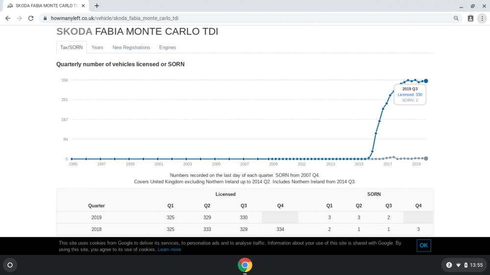

I was told this by dealer and Skoda UK.
"It is due when the car reaches 5 years or 140,000 miles from the date of registration whichever comes first."
