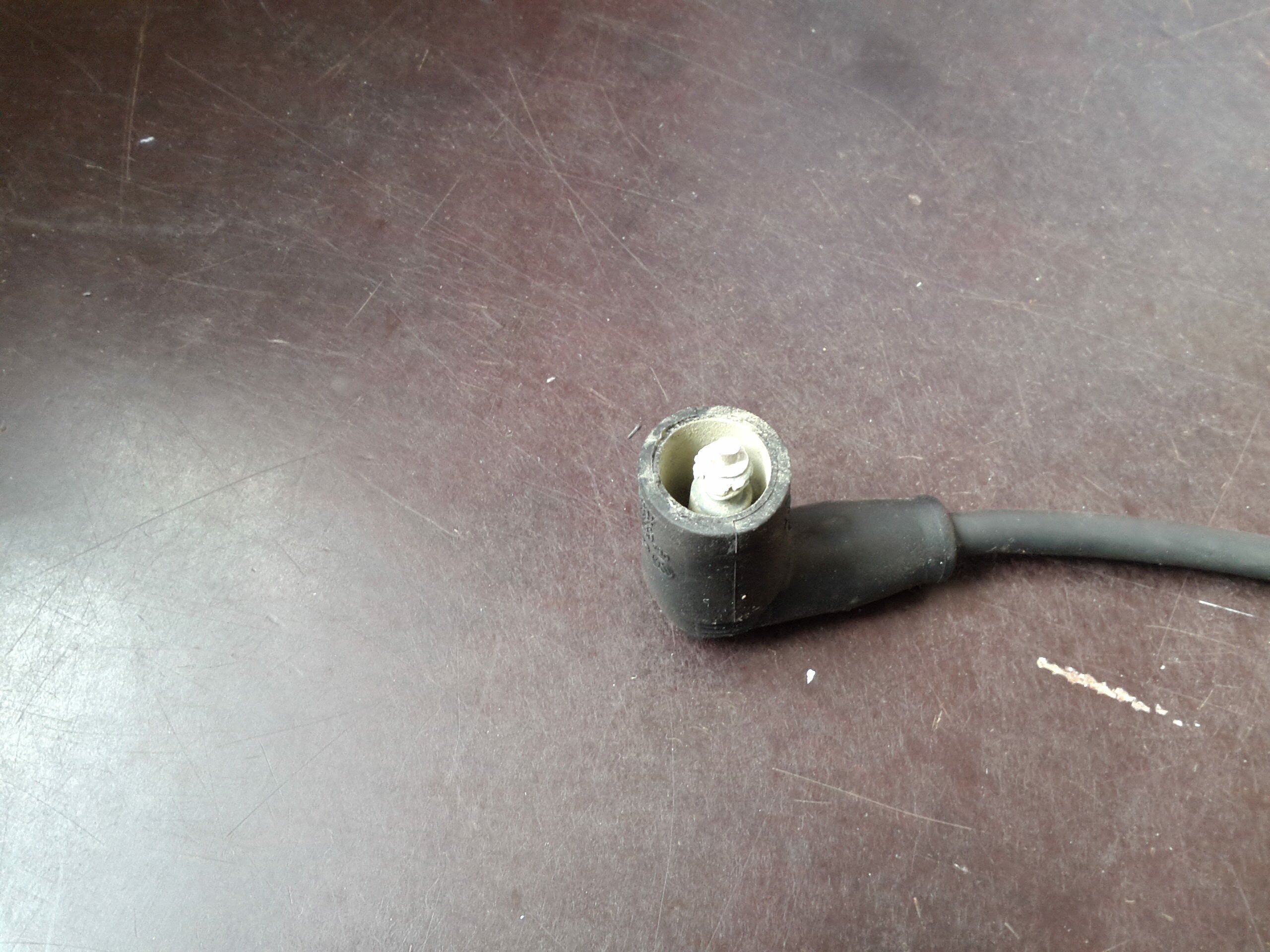

My 2013 Yeti 1.2 had No.3 plug lead failure which seemed to cause arcing at the connection with the ignition coil pack on top of the engine.  Need to take photos of position of leads before removing them. Quite simple job but ensure leads routed AWAY from the hot metat shields around plugs. I've got more photos if you need them.
