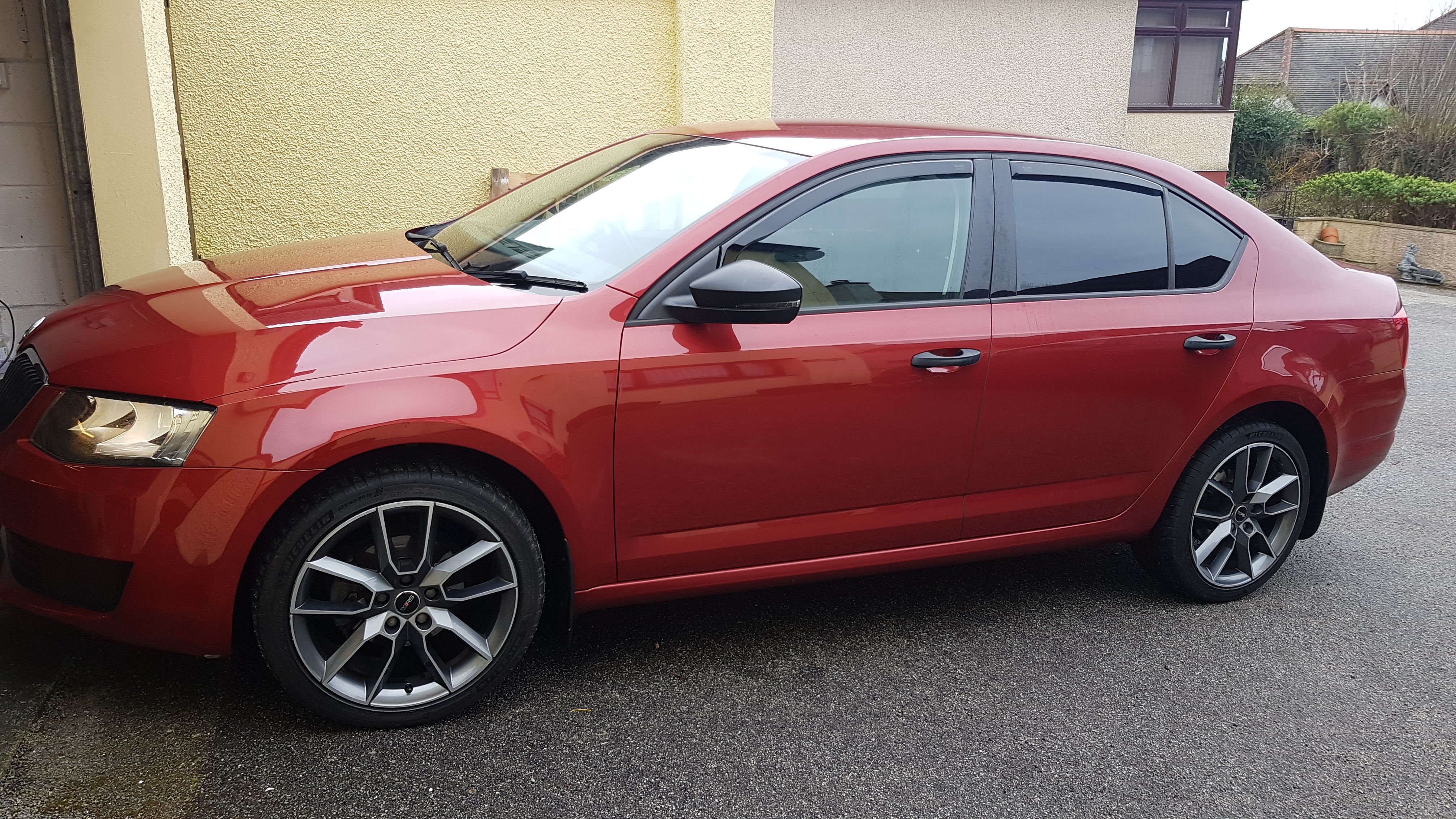

Hey guys just bought a 1.6 tdi a week ago. Absolutely love it and have been playing already with new alloys, front mudflaps, windows  tinted and wind deflectors. There are just a couple of small jobs I want to do now and the first is lower it around about 30mm. What's the best springs for this? any links? and any b4 and after pics of your car after doing the same . Thanks Dave
