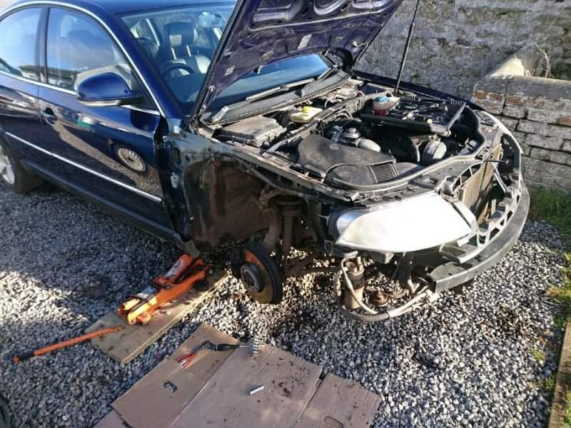

It's getting ridiculous with cars and having to take bits off for simple jobs these days. I had a similar problem with our old passat, changing the bulbs reguired major surgery so took my chance while dealing with another vag problem of that period (rusty front wings due to soundproofing foam blocks glued to the inner wing).

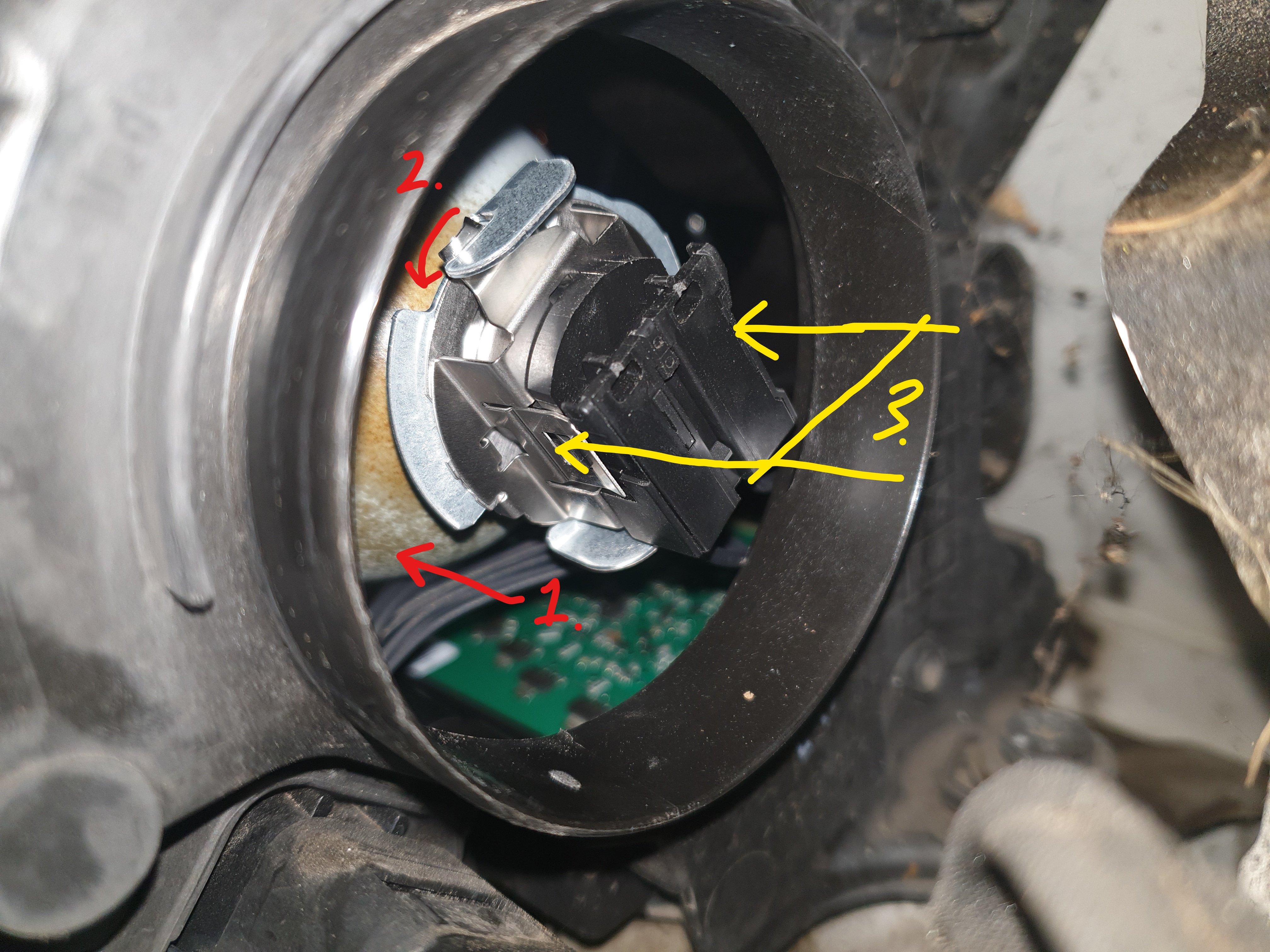

Thanks so much for describing that. When I had a go, I (and the garage I saw this morning) got as far as "Twist the connector (like a bayonet-cap light bulb), then the bulb and fitting/connector come out as one."
I literally can't do it. The garage struggled too, even while *gently* trying to twist with some long nosed pliers. When you say like a bayonet, you mean push the fitting towards the car, while twisting anti-clockwise?
I took a pic of the one that is relatively easy to access...
So grab either side of the bulb (3) push towards car (1) while twisting in the direction of (2)?
I did try this, but maybe I've not got the knack...?!
It does take a bit of force, twisting anti-clockwise to take it out. I didn't have to push it in to remove the bulb+connector.

I had another jimmy around with that one I photographed and with a bit of a push (which is very hard in a tight space) I managed to release it!!
However - that was the one that wasn't dead 😂 I just wanted to understand the concept before attempting the side where's there's absolutely fudge all space for your hand (the n/s light). How did you manage that one? Did you go up through the arch hole?

Same both sides and same as a bayonet cap light bulb in the house.
I put a small amount of grease on the lugs, marked up as number 2 in red above, to help with further bulb changes.
