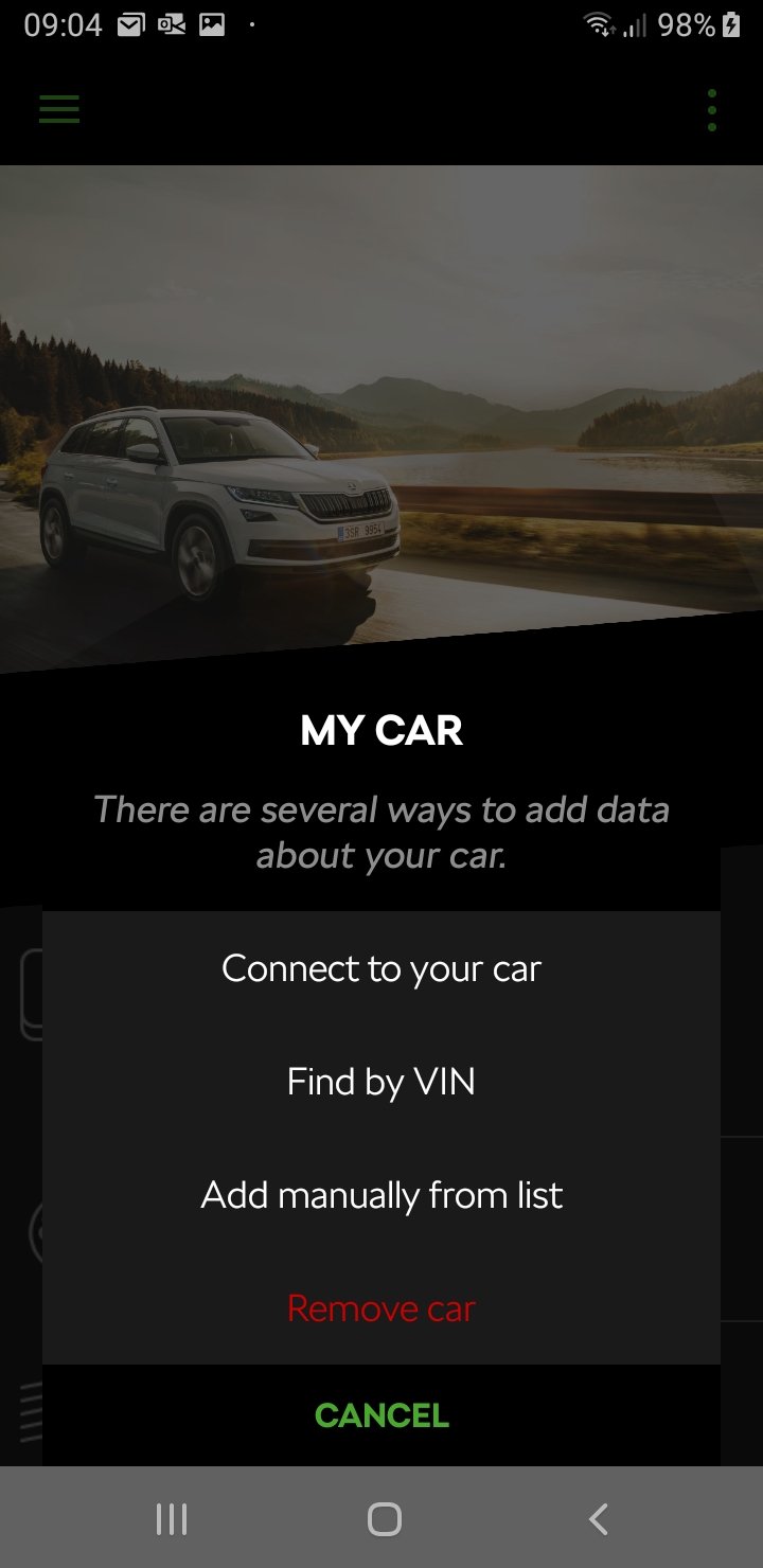

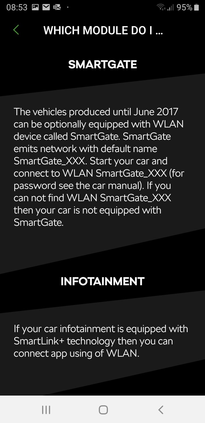

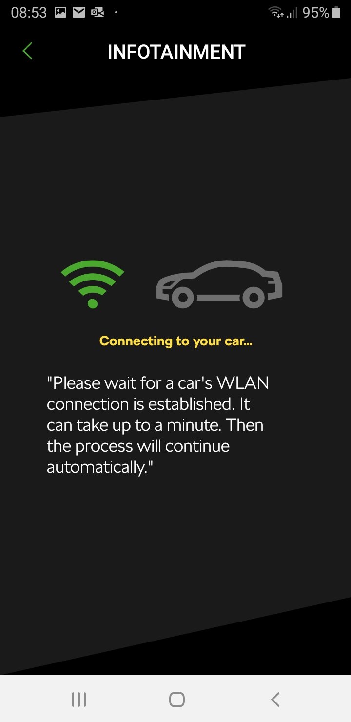

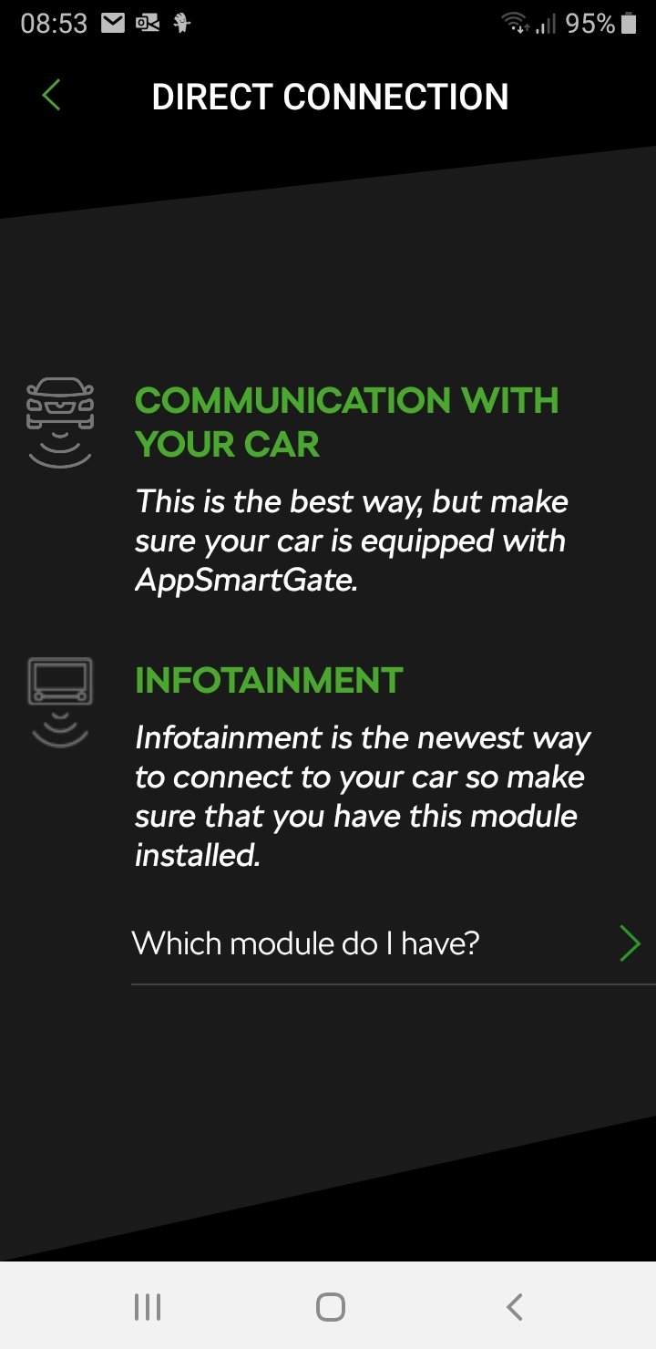

Welcome to Briskoda.
Your service history is now stored electronically, online. It can be accessed via your dealer, Skoda UK or the MySkoda App.
When the car is serviced you will still get a paper invoice, that you can keep and use when selling the car. You can also request a hard copy of the cars service certificate too, so you get another printout that can be used to prove the cars provenance.
When you say the MySkoda App doesn't work, what do you mean?
Have you been able to successfully download the App to your phone?
If you have then there are multiple ways you can connect.
As your Kodiaq was built after June 2017 you can use the cars inbuilt infotainment system...
Skoda claim SmartGate is the best way to connect your phone to your car as it uses Wi-Fi, but my Kodiaq doesn't have it.
Using the infotainment system works just fine...
You can choose from different options on your phone, WLAN, using the VIN or by simply selecting your Kodiaq model from a predefined list.
I tried WLAN but it kept failing...
Using the VIN is easiest, it can be found under the passenger side wiper blade...
Good luck!
