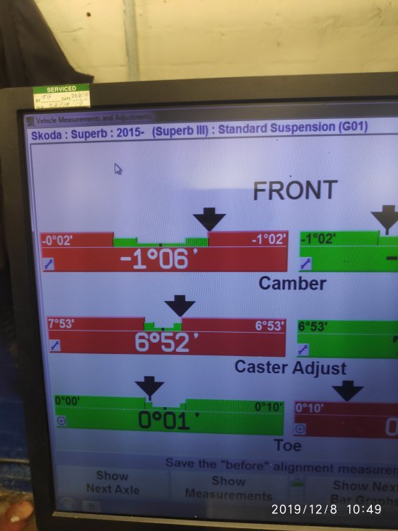

Hello everyone and yet again with another problem. As the title i have a camber issue.
2017 reg superb hatch 2.0tdi 150hp with 113k miles.
In December i changed front tyres do to wear, as i like doing the right way i done a aligment check also to find out that my near side is out of specs in terms of camber and slightly caster. Which i think it falls in the right place by itself adjusting the camber.... At the time i thought is not such a big issue a bit more negative than specs, but i than looked at the right side and the camber is -58 compared to driver side and difference between right and left is 2 times more than it should be. Picture attached from a hunter system when i changed the tyres
I know as per skoda workshop this can be adjusted by slaken the 4 bolt of the front carrier and move it left and rights as required but no one wants to do it.( Did not try skoda yet)
Any suggestions?
