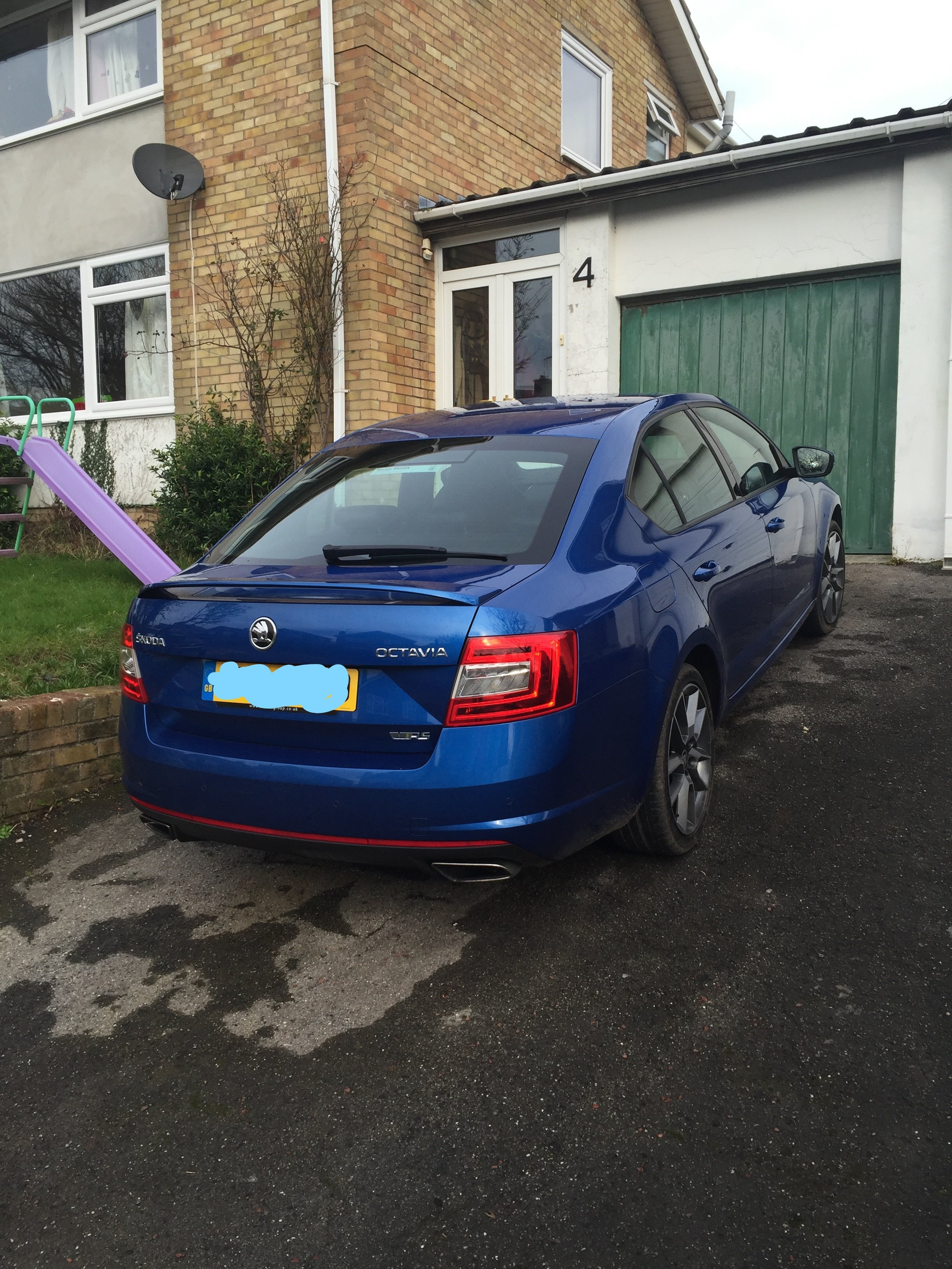

Heres how I picked it up

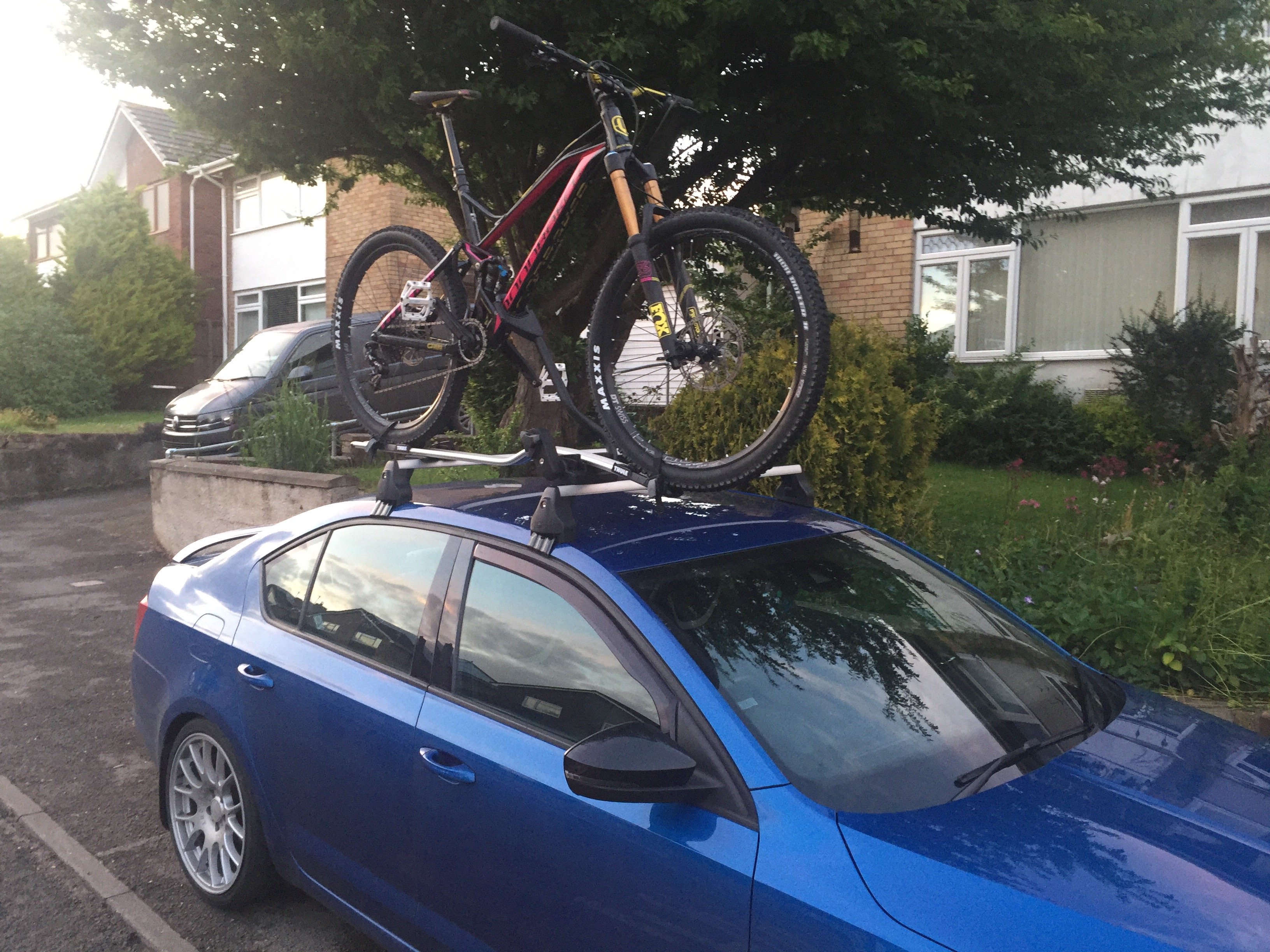

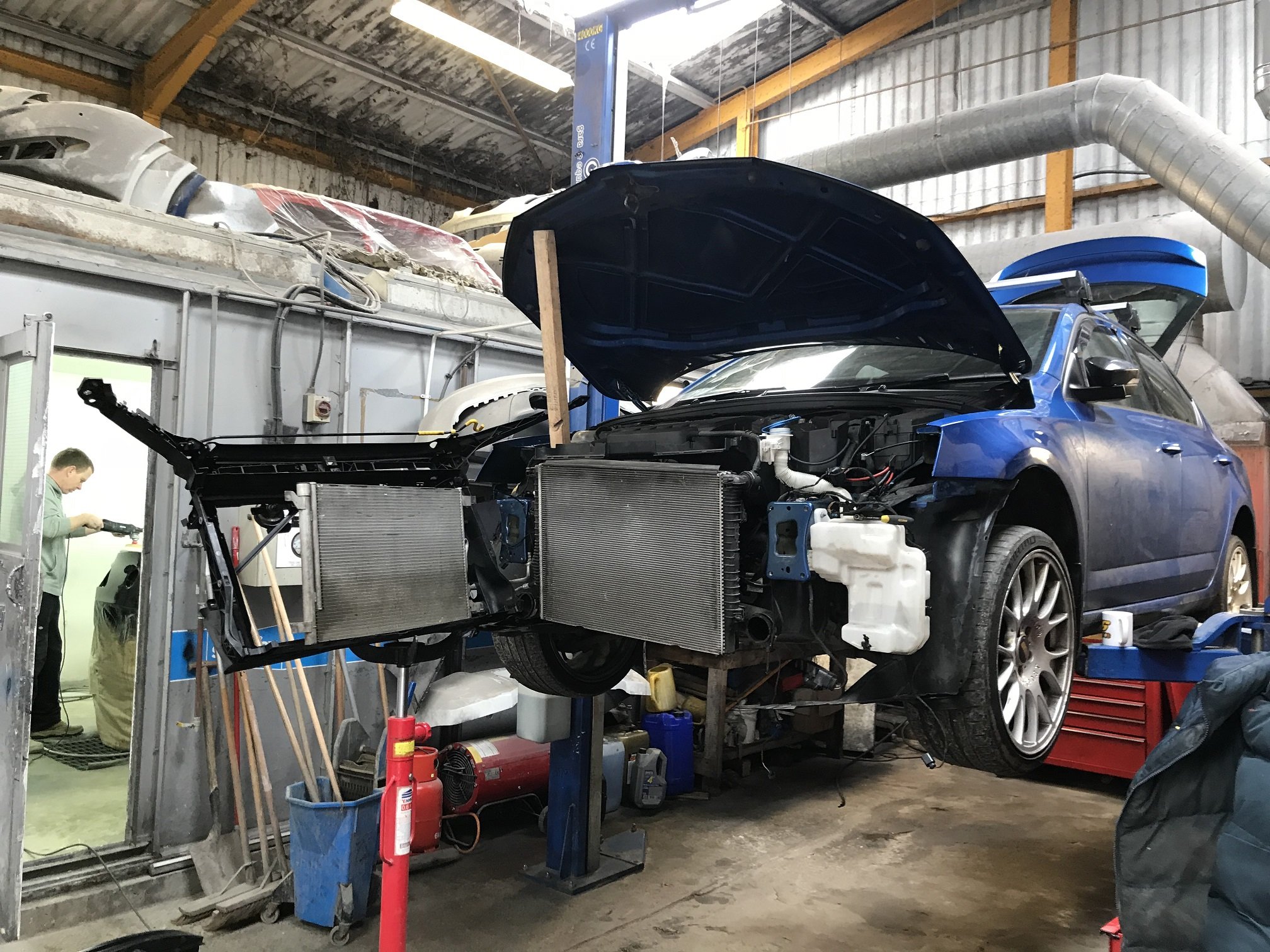

  • This happened at the begining of the year. got hit in the heavy winds. Then covid started so didn't get the car sorted till recently.   Now it looks mint,   roof and rear boot and
  • added 19 inch bbs ch reps       and a roof rack!

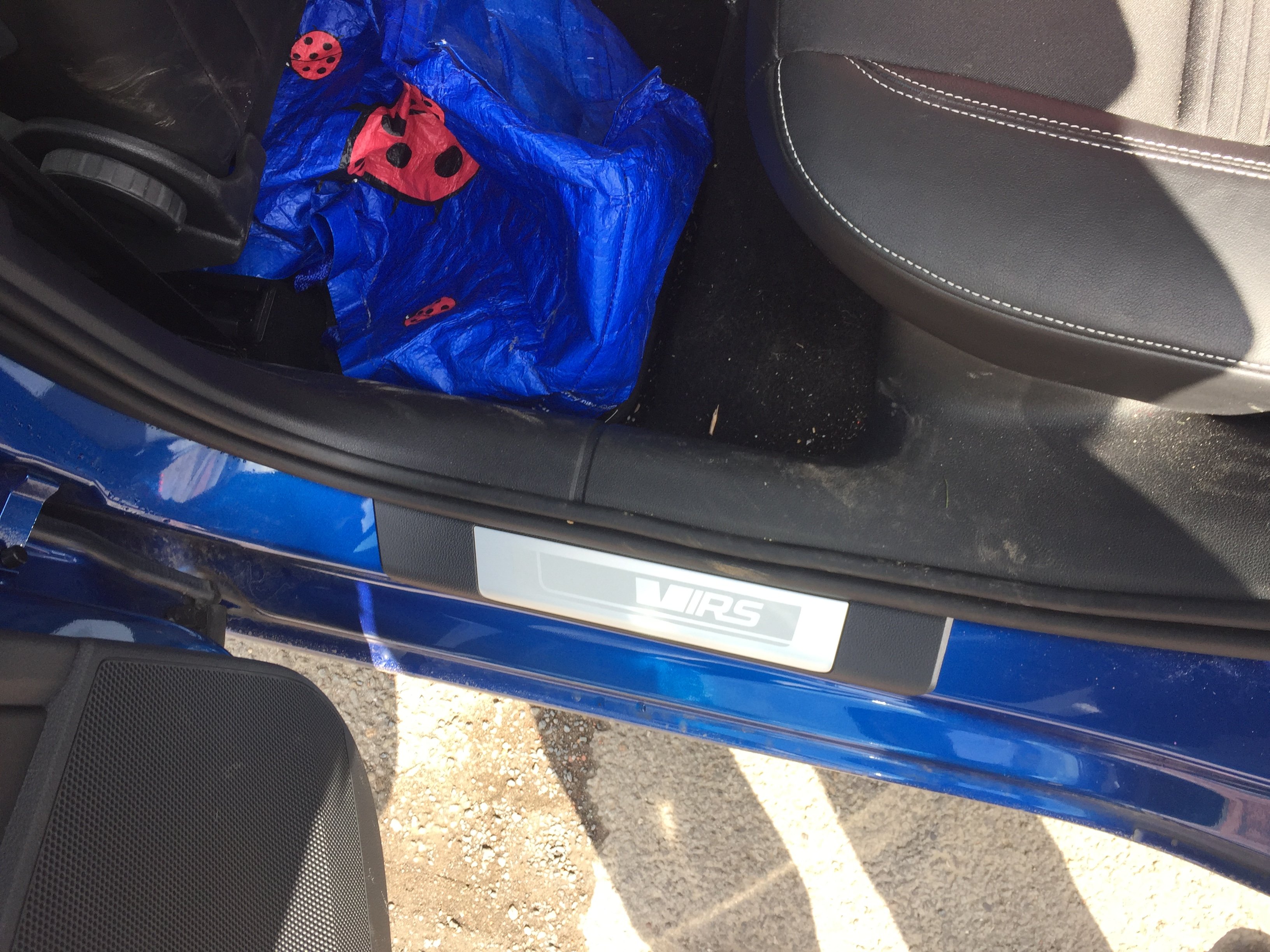

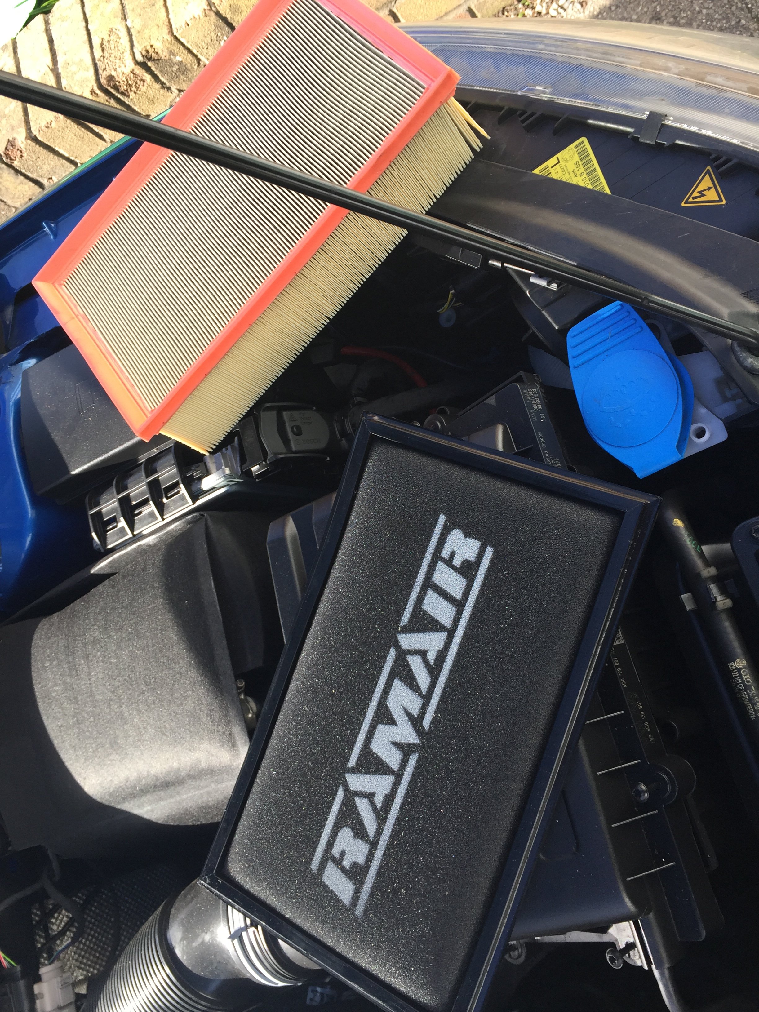

Black grill and mirrors next. Rear sill plates. Ramair panel filter. HR springs, Kenwood Garmin Satnav. Dog bone mount, Reiger rear splitter, genuine boot guard thingy,

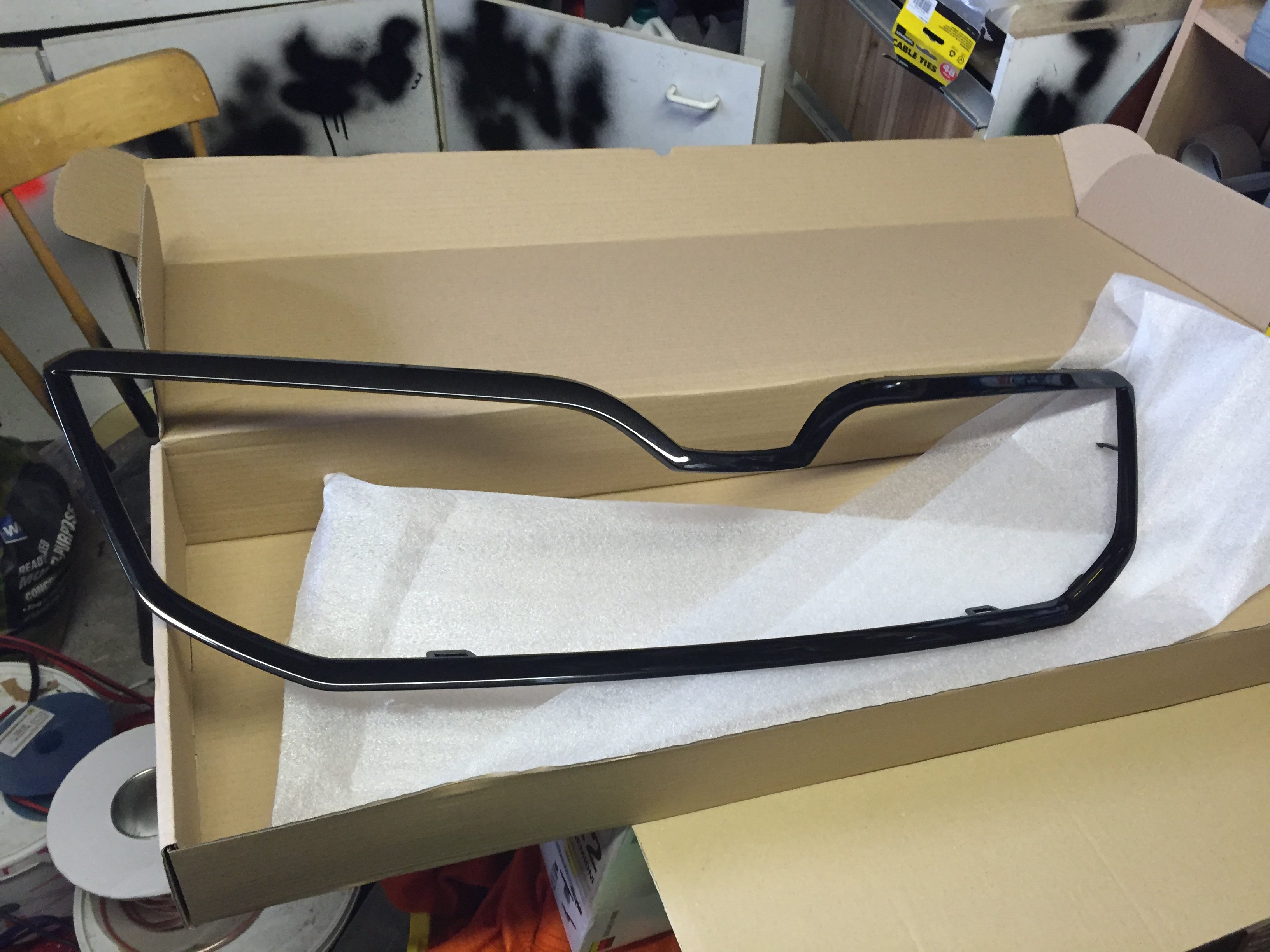

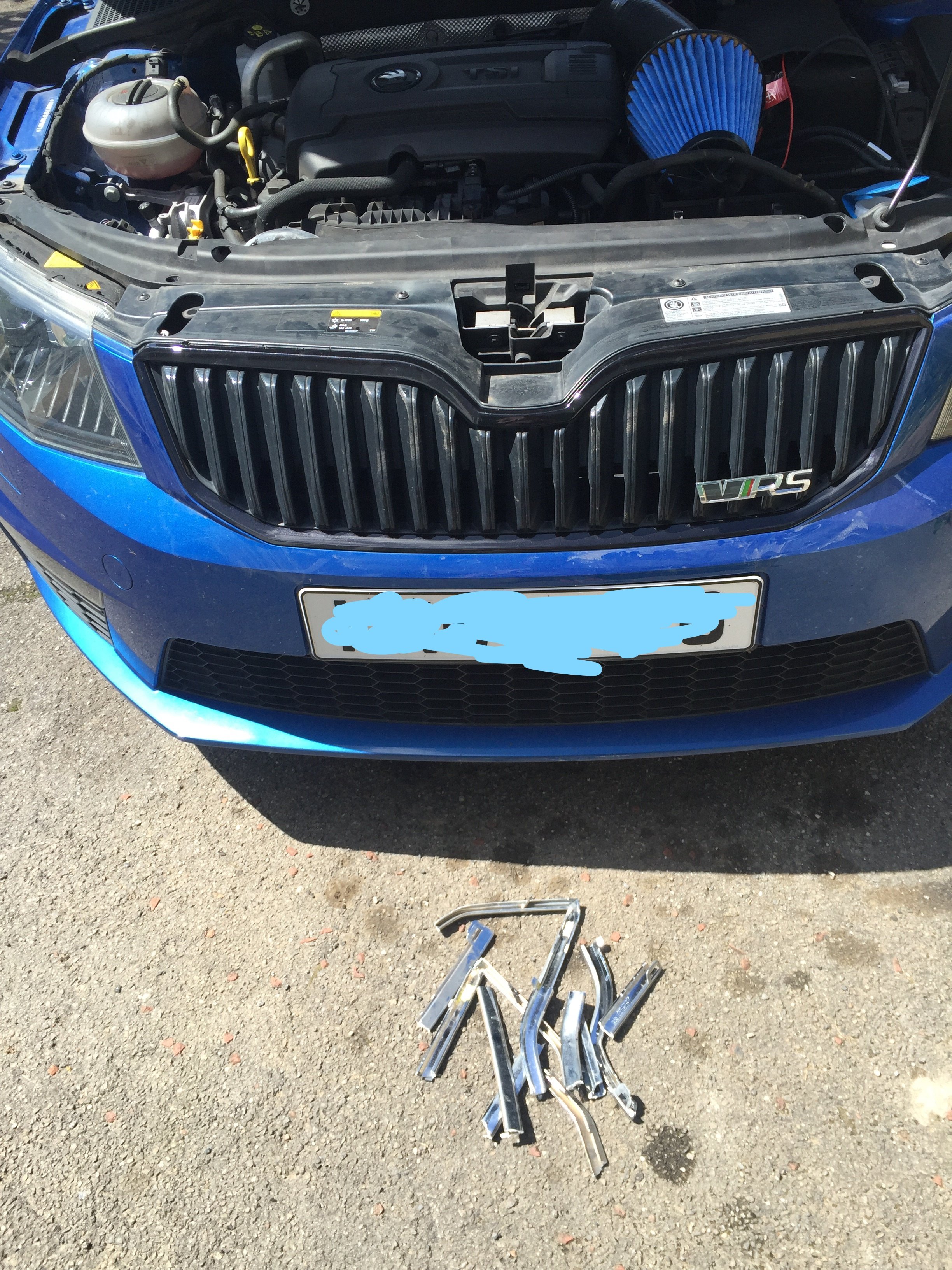

ok so I changed the grill with a hammer

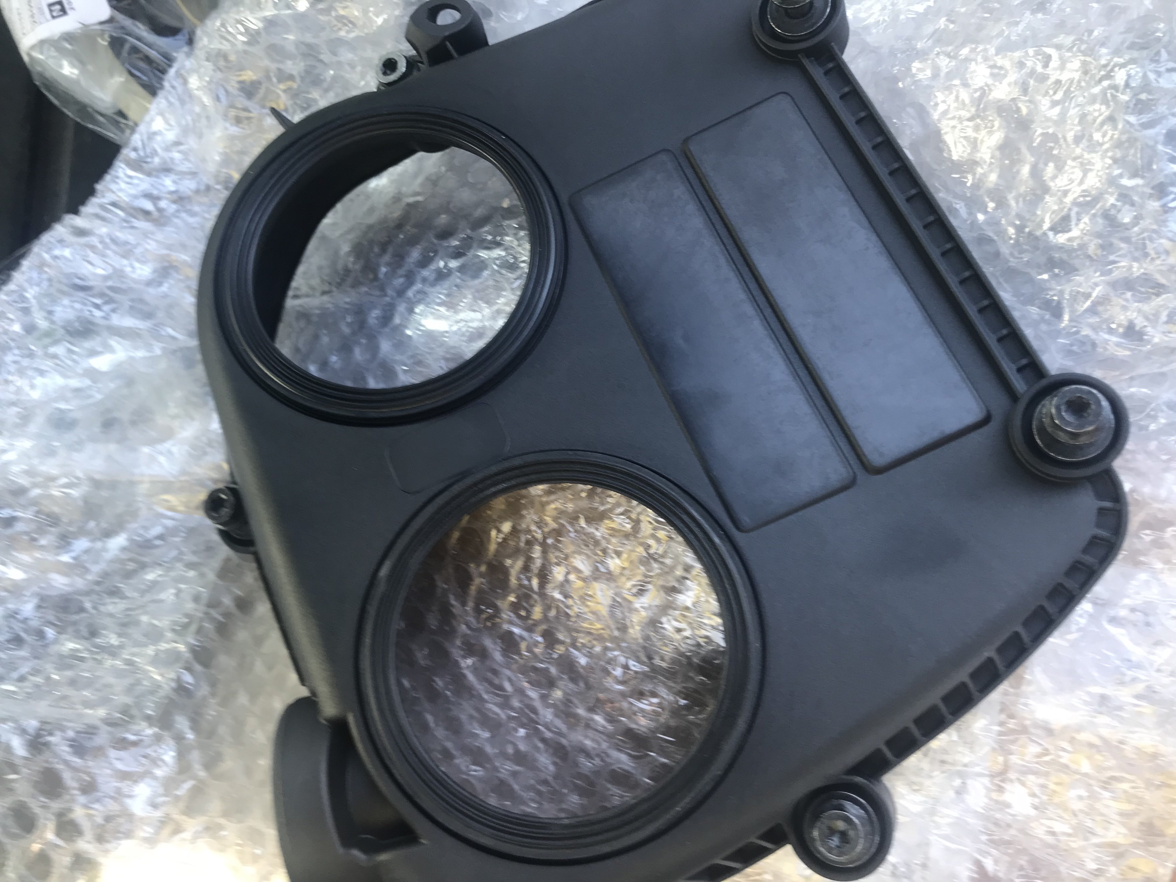

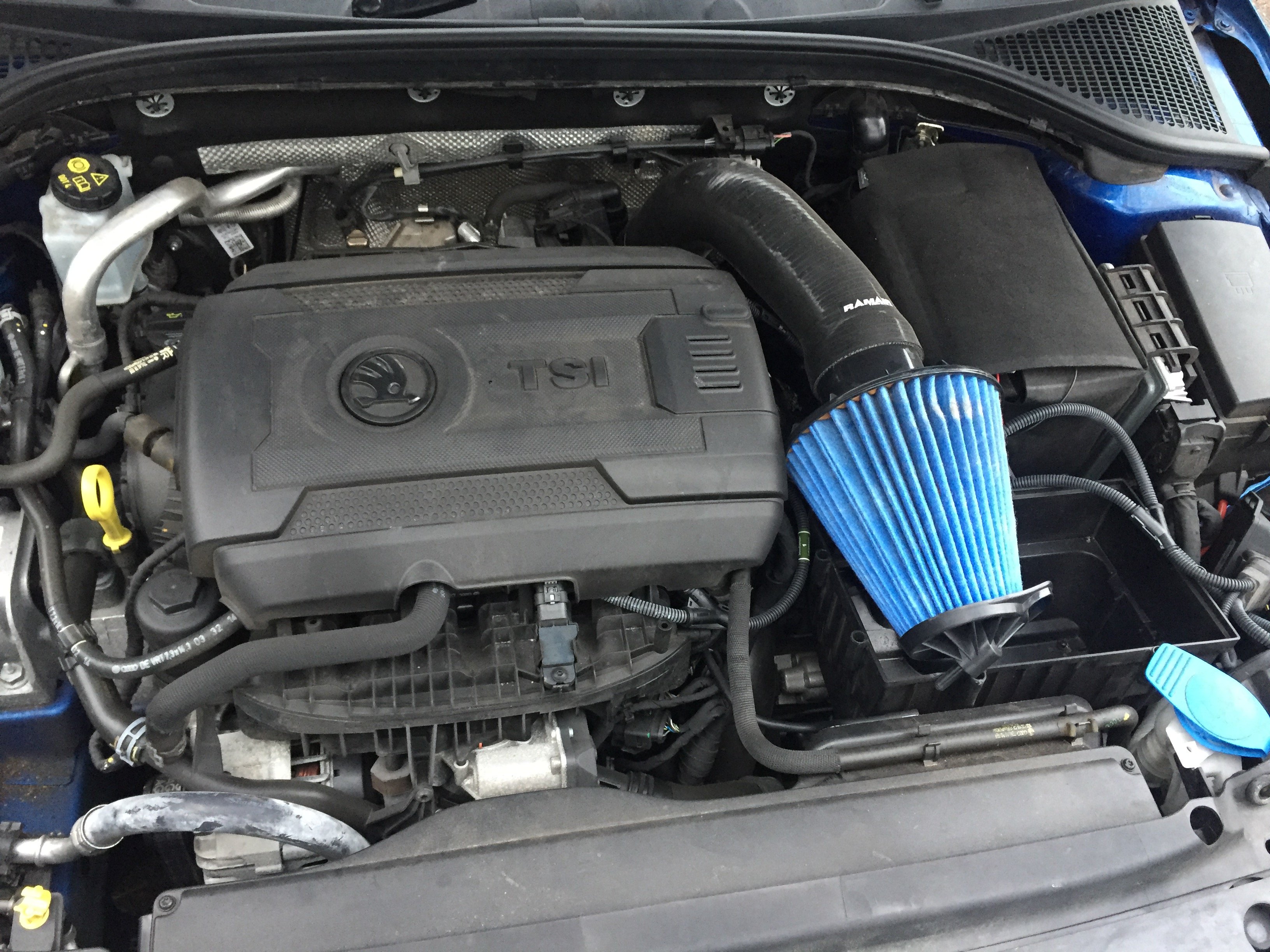

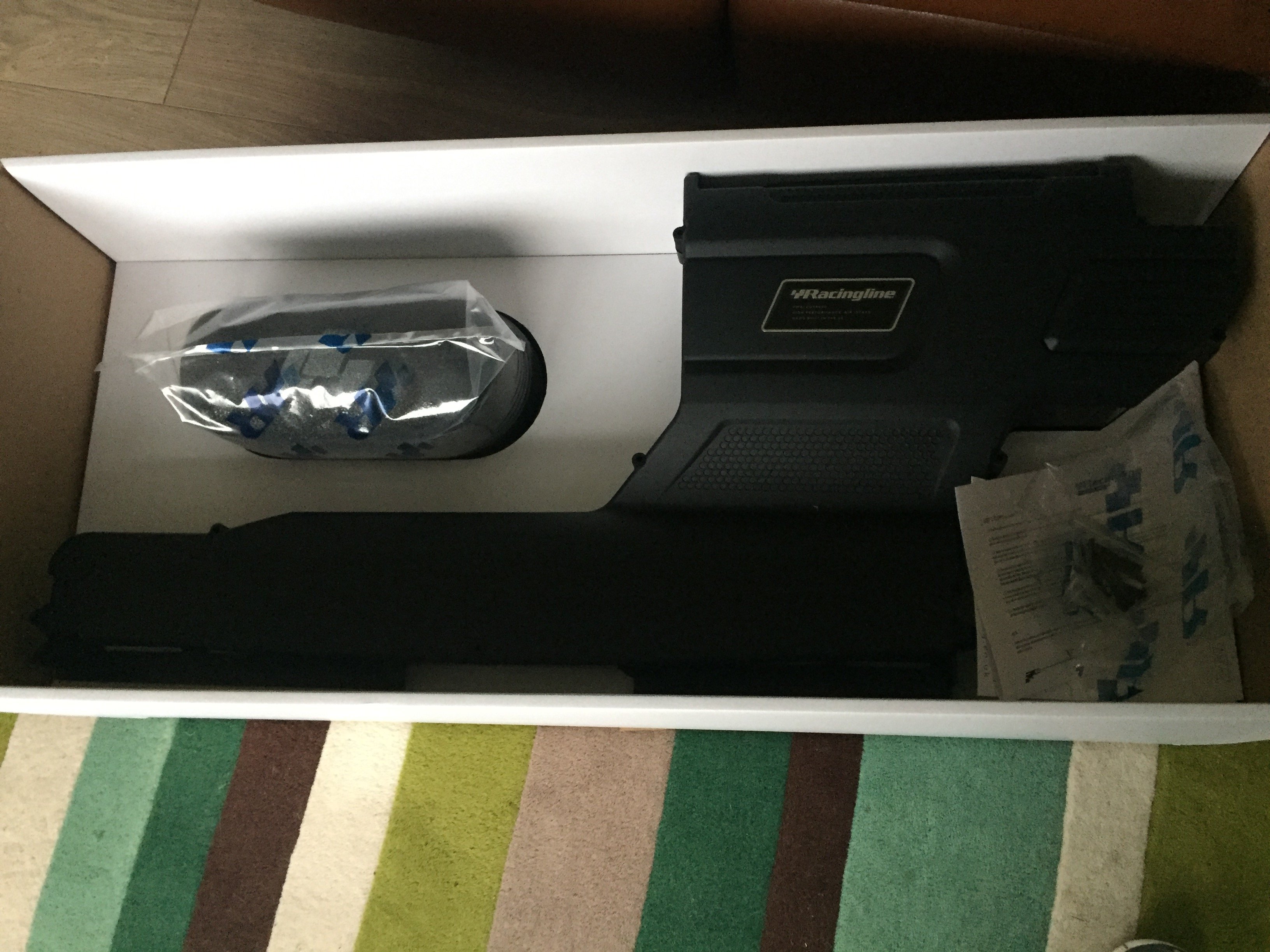

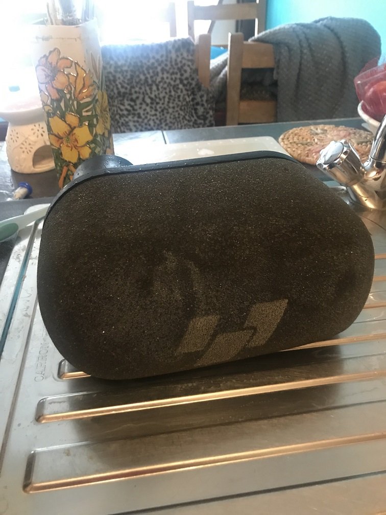

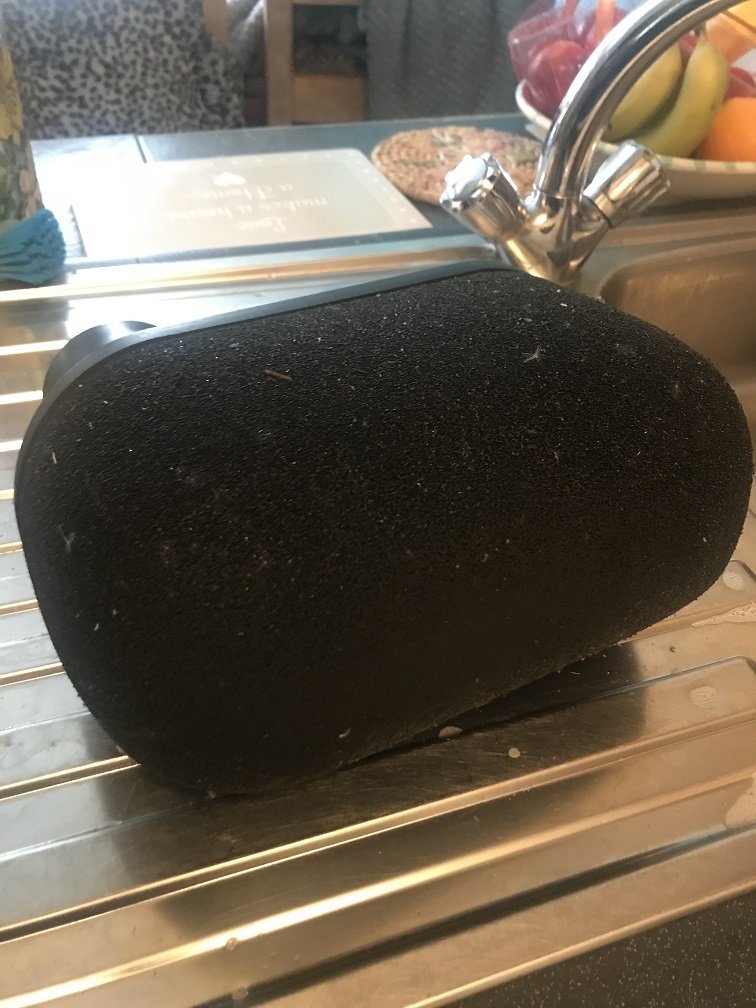

later I fitted a cosworth 20161205_140105378_iOS.thumb.jpg.24f3c5c75ebb1724e52727471c91d965.jpghonda s2000 filter I had spare in the garage with a ramair pipe.

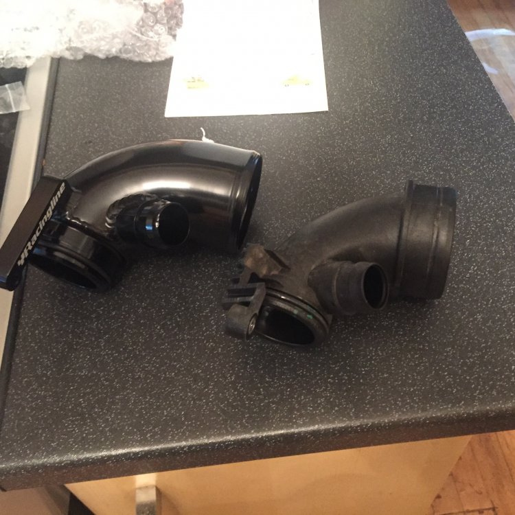

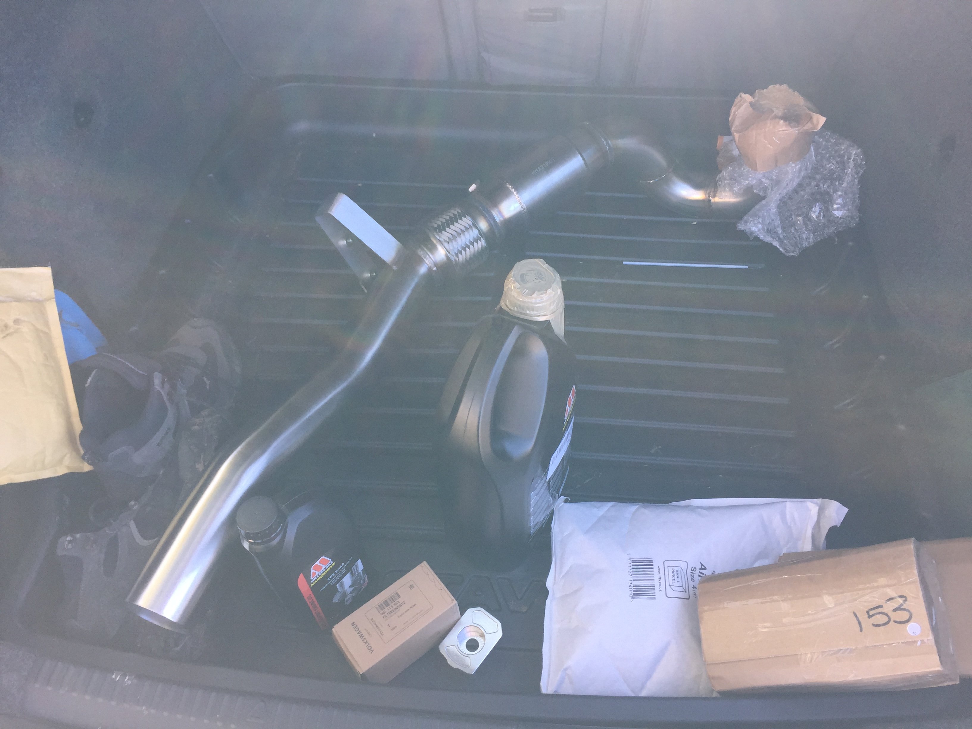

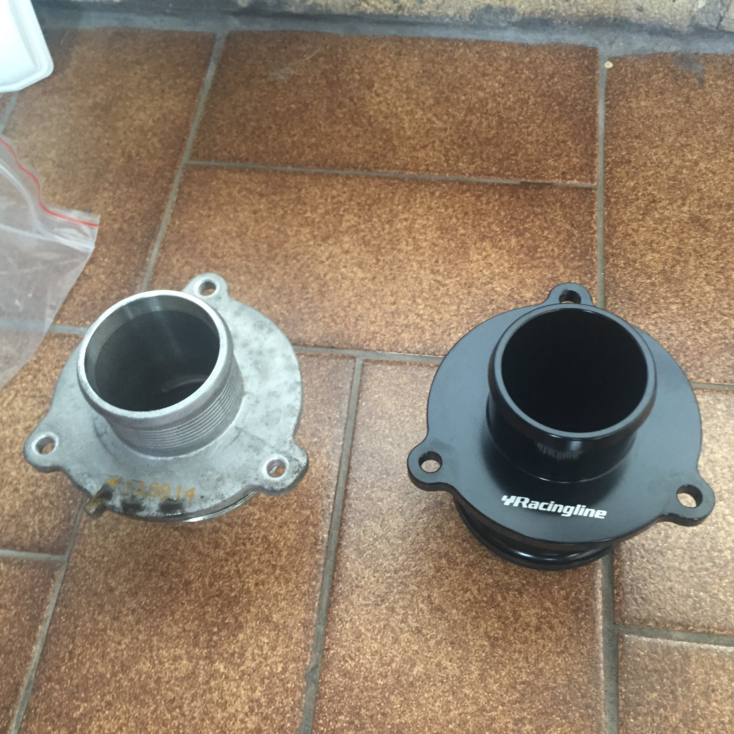

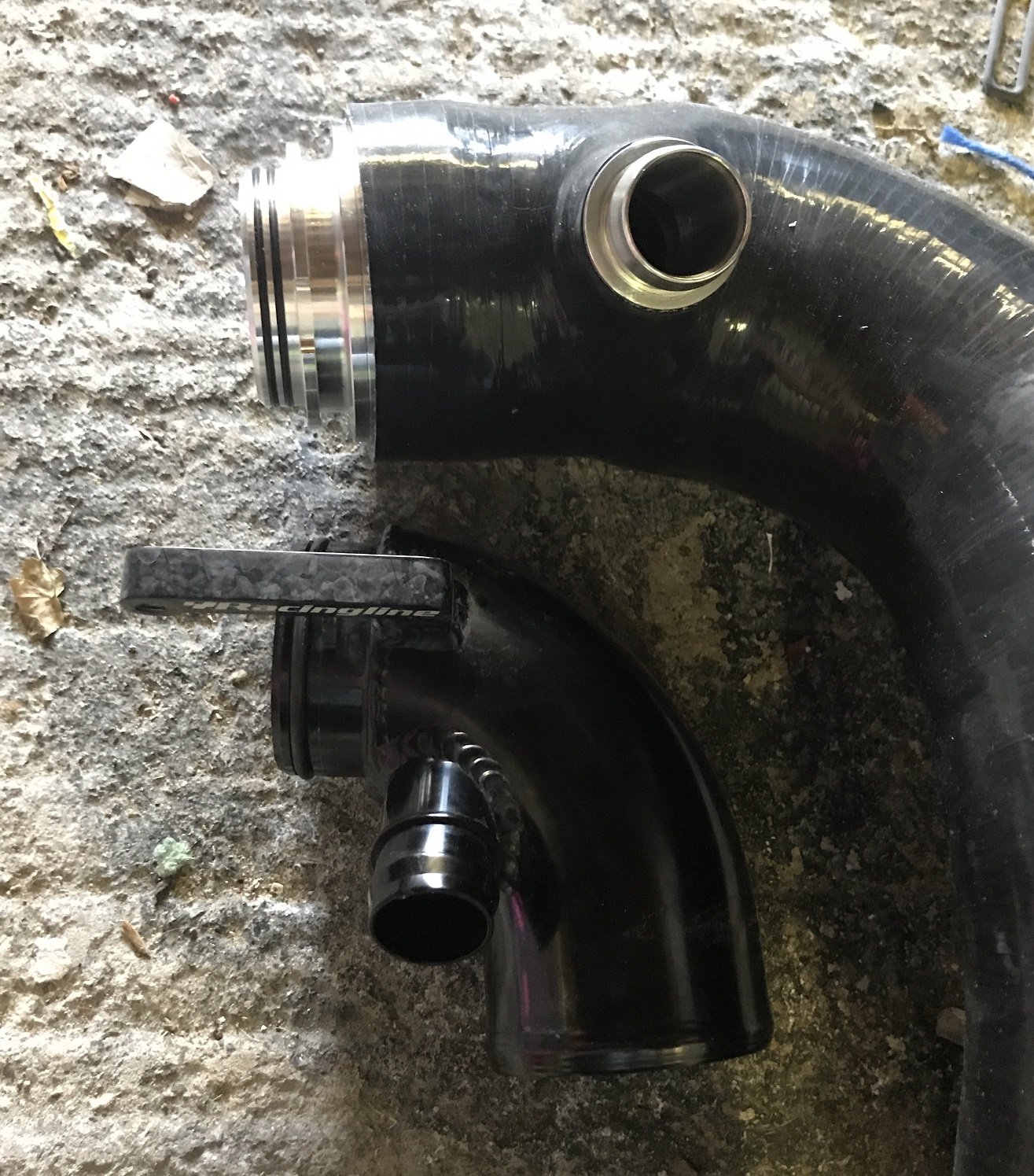

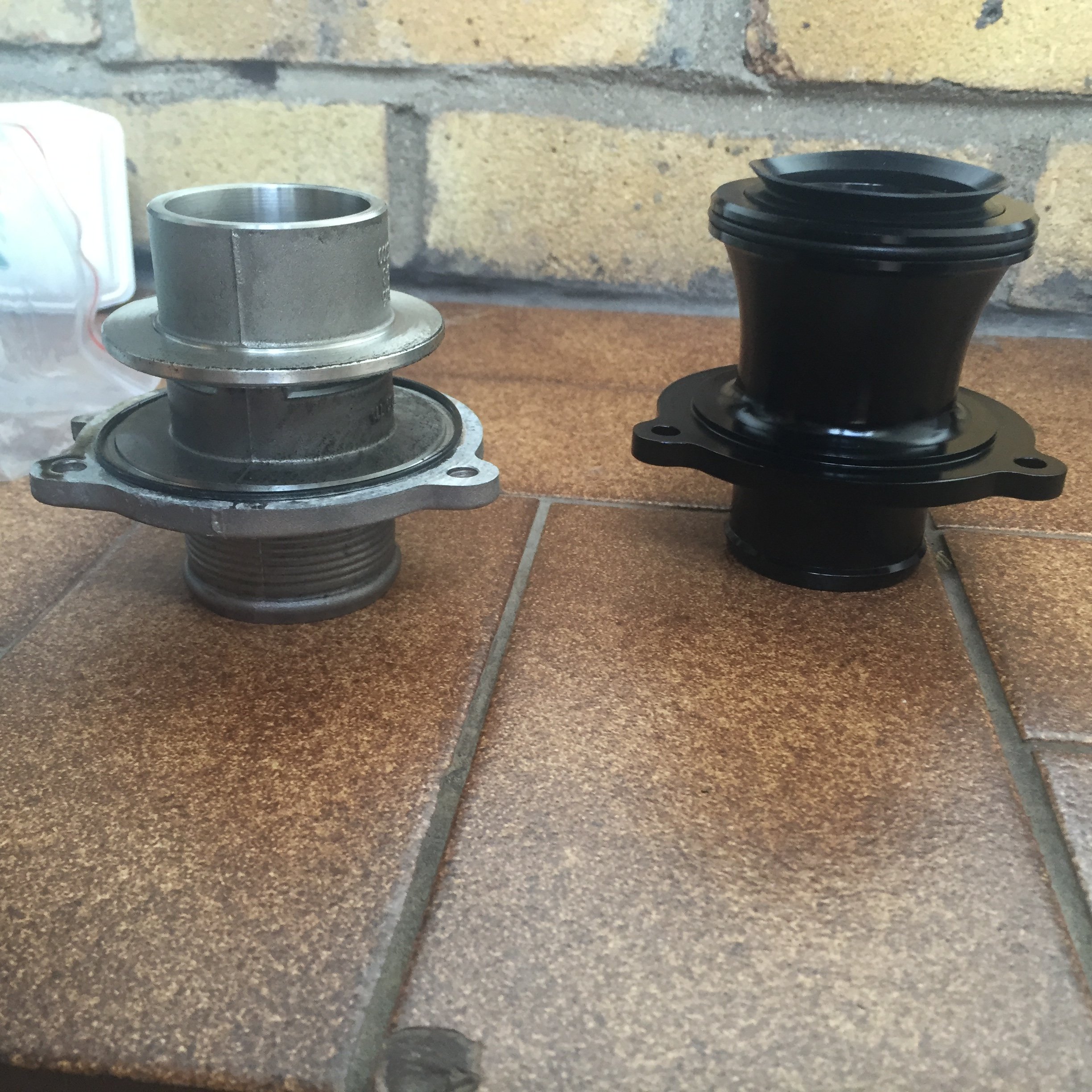

then racing line elbow and turbo muff delete. 20160907_164751121_iOS.thumb.jpg.d90615205a13face30ae4ccdba9e8279.jpg20160907_164803679_iOS.thumb.jpg.65fc4cf342e53f768818685486436e2e.jpg

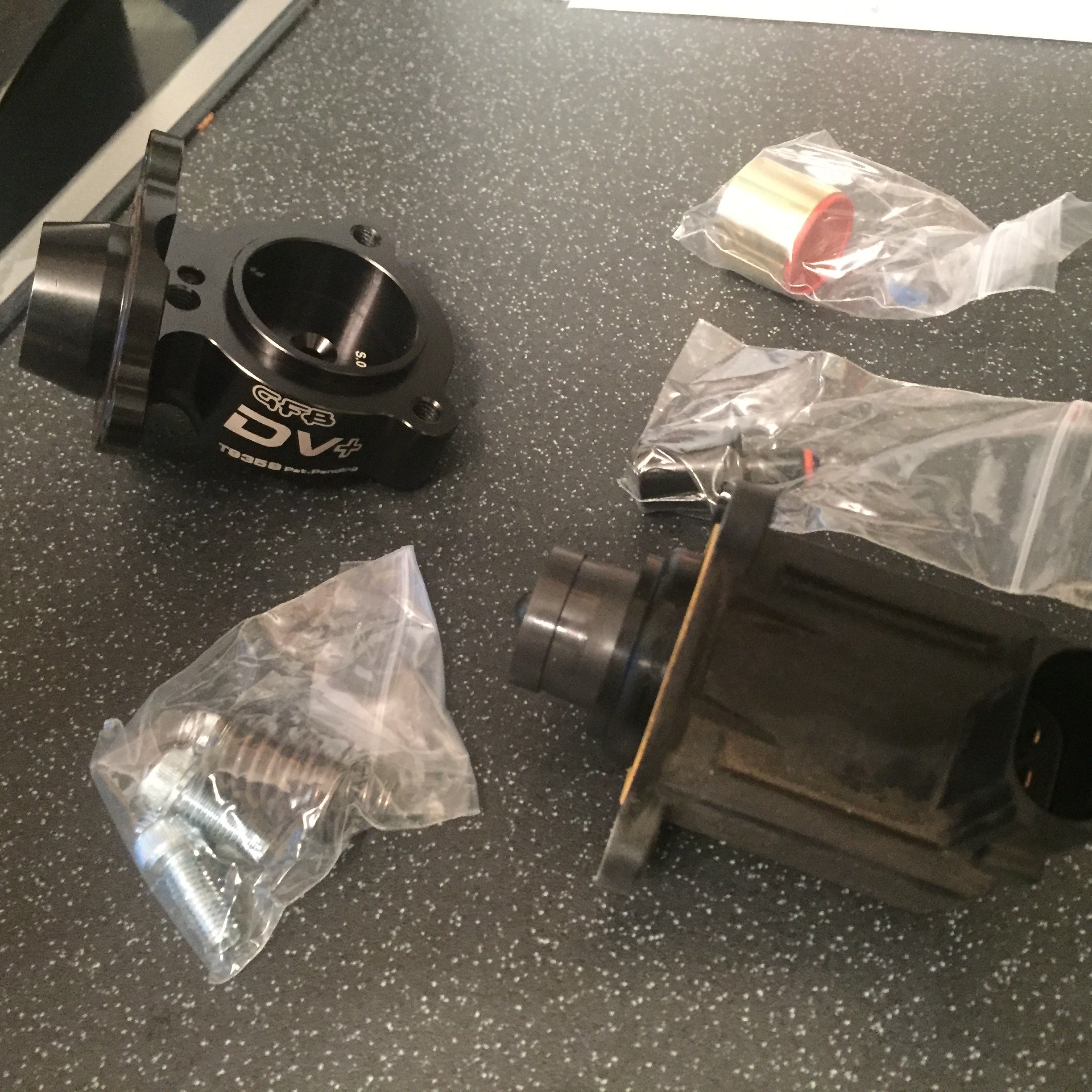

also got a golf r dv + and a scorpion dp cat

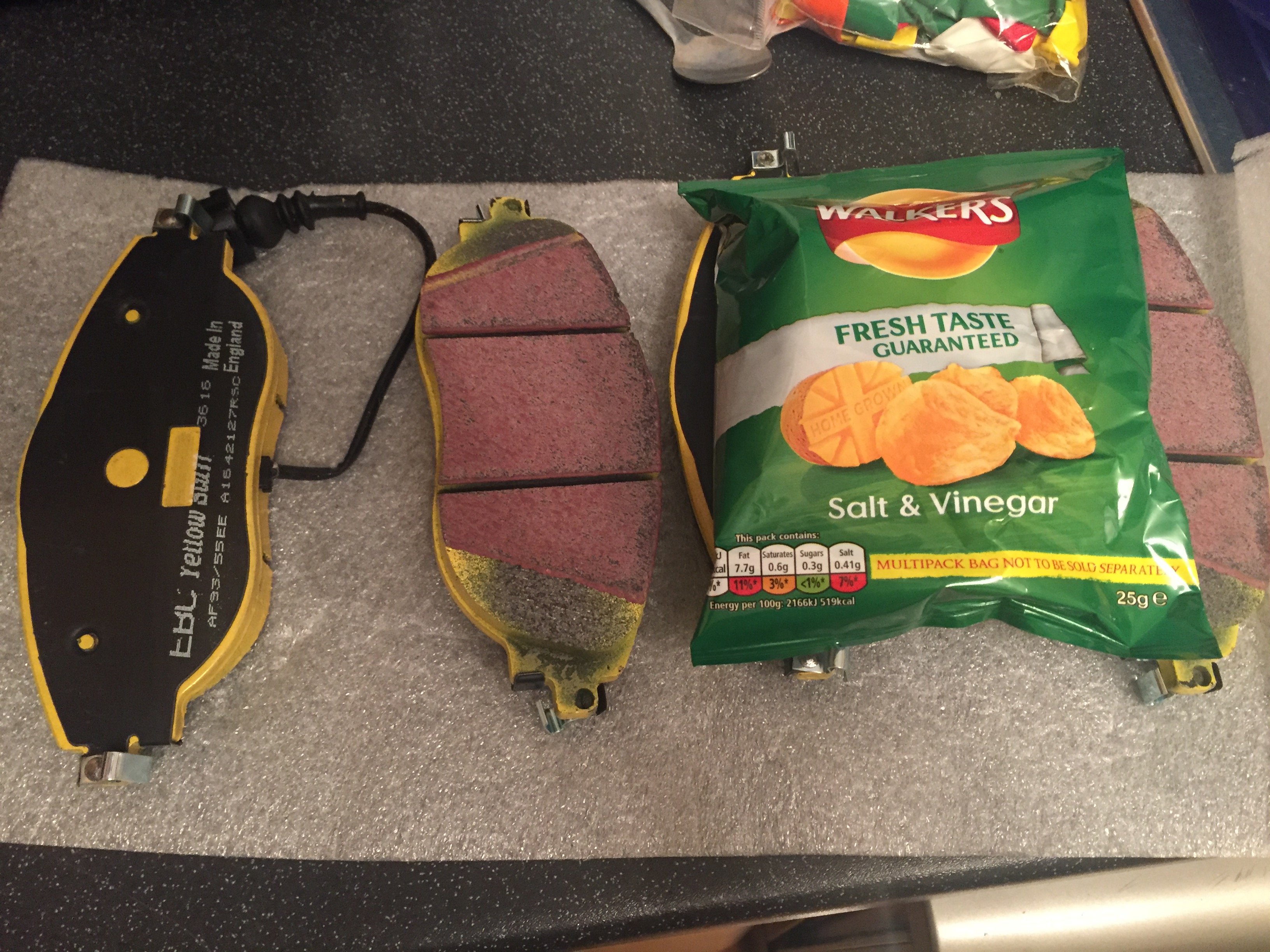

I tried ebc again and was quite happy with them

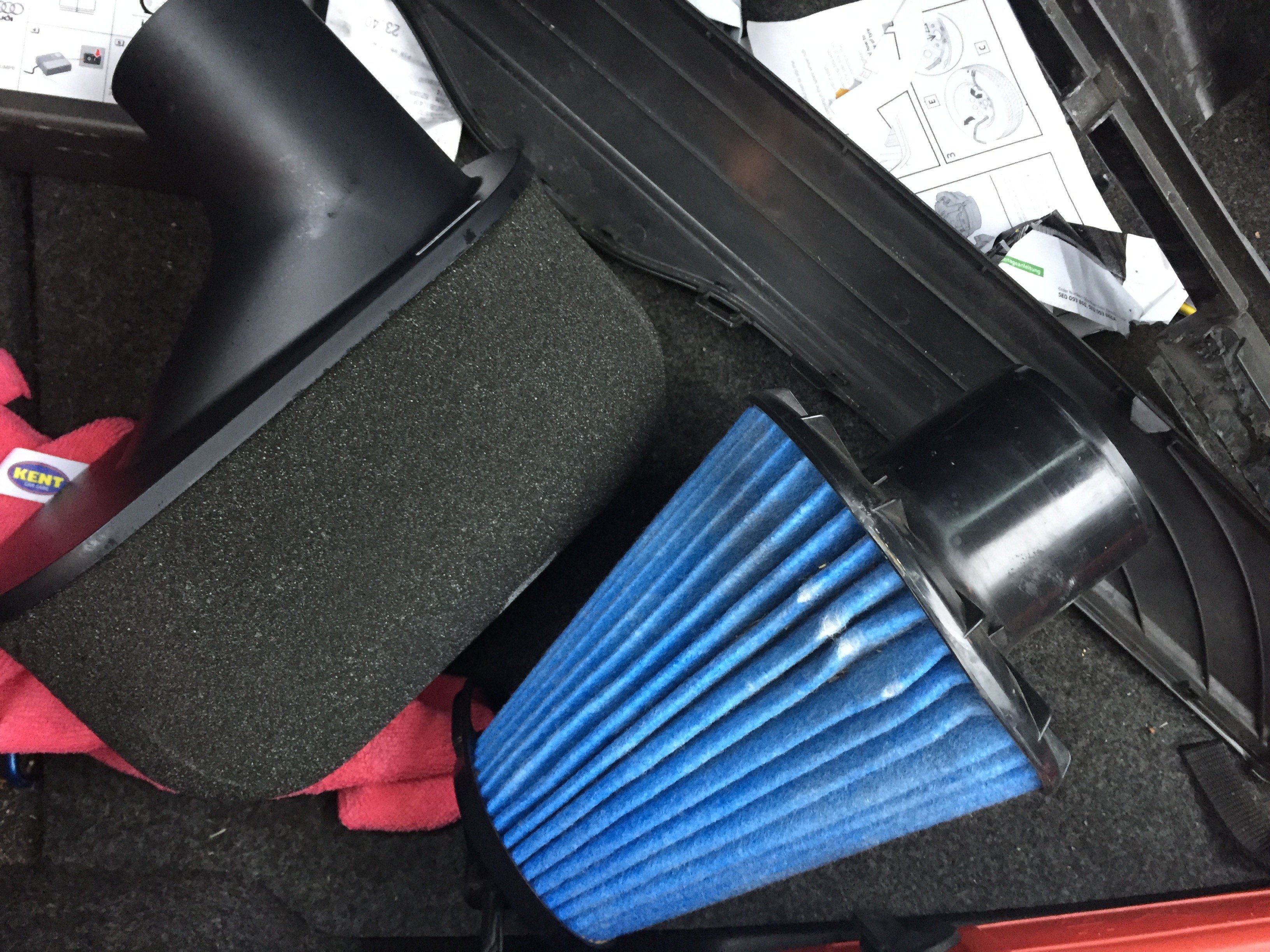

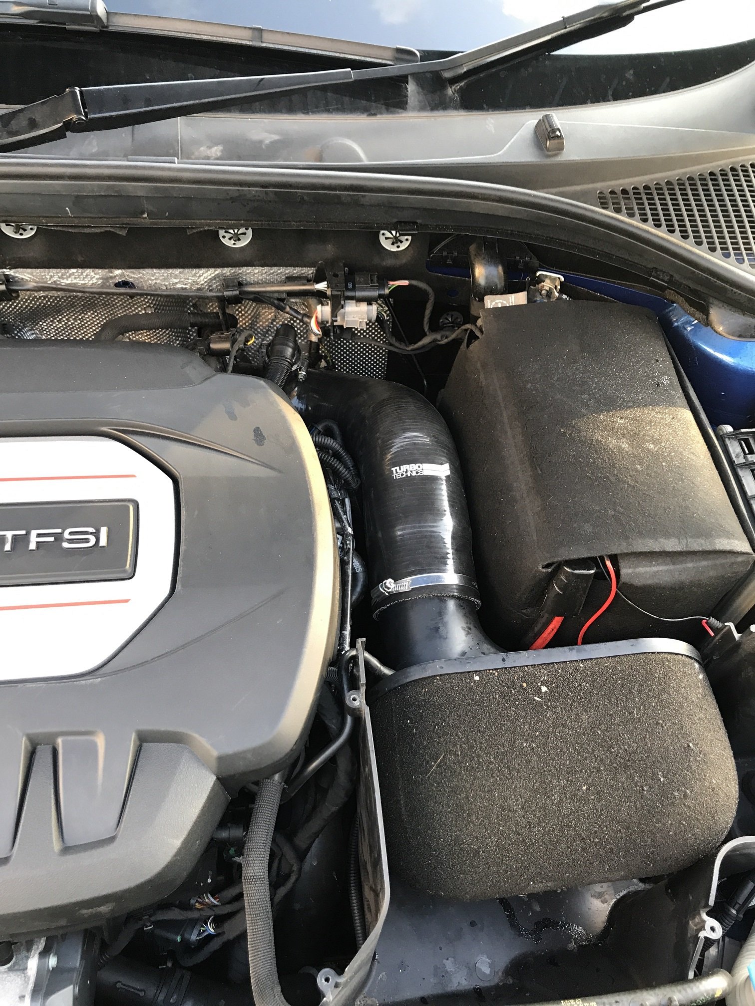

then I went for a r600 intake during a winter sale
20161202_091342441_iOS.thumb.jpg.00a7cf01218071a09c462c1f0c7e7fdb.jpg20161202_153232492_iOS.thumb.jpg.b9f8768d3f88ee05200ac483e756b367.jpg

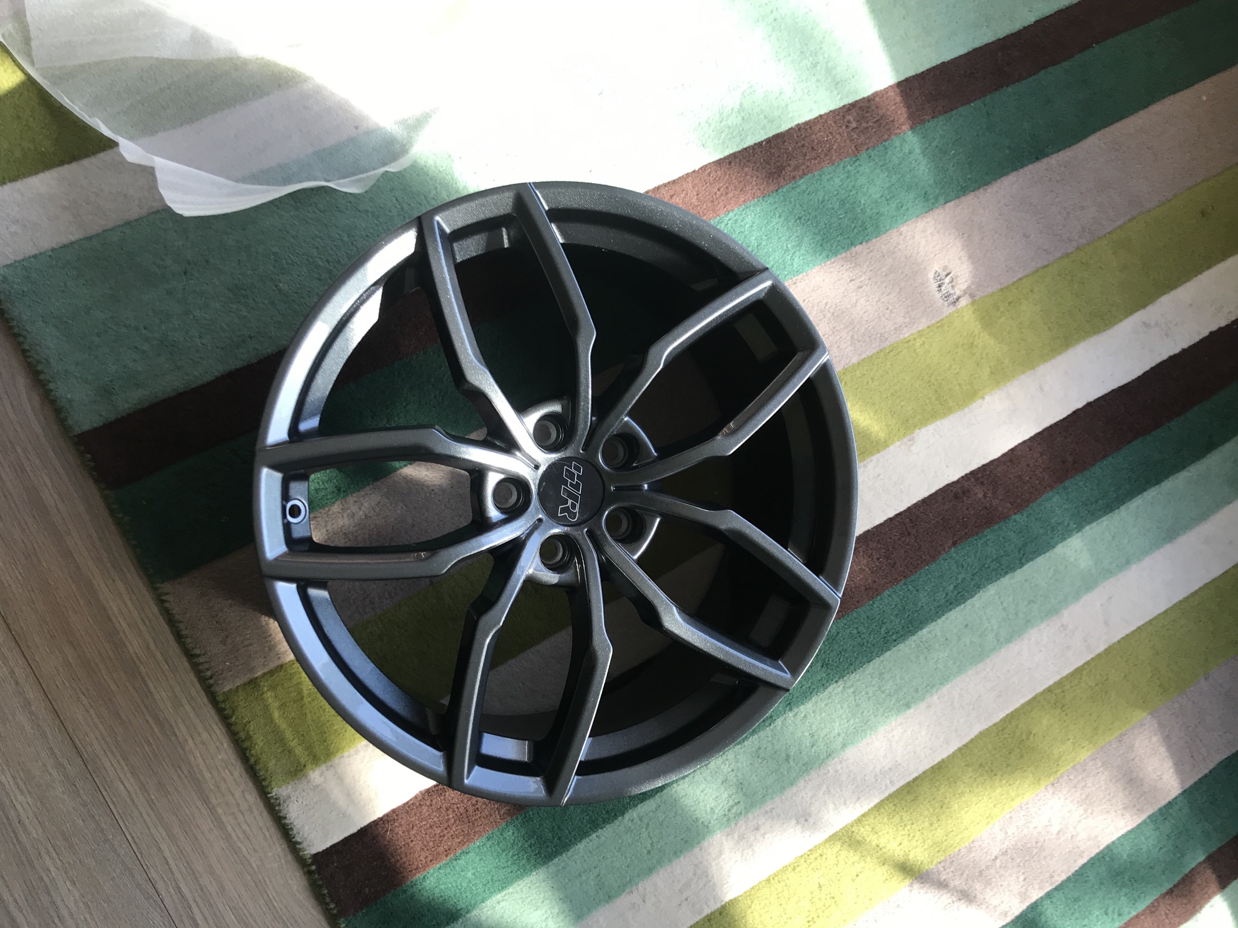

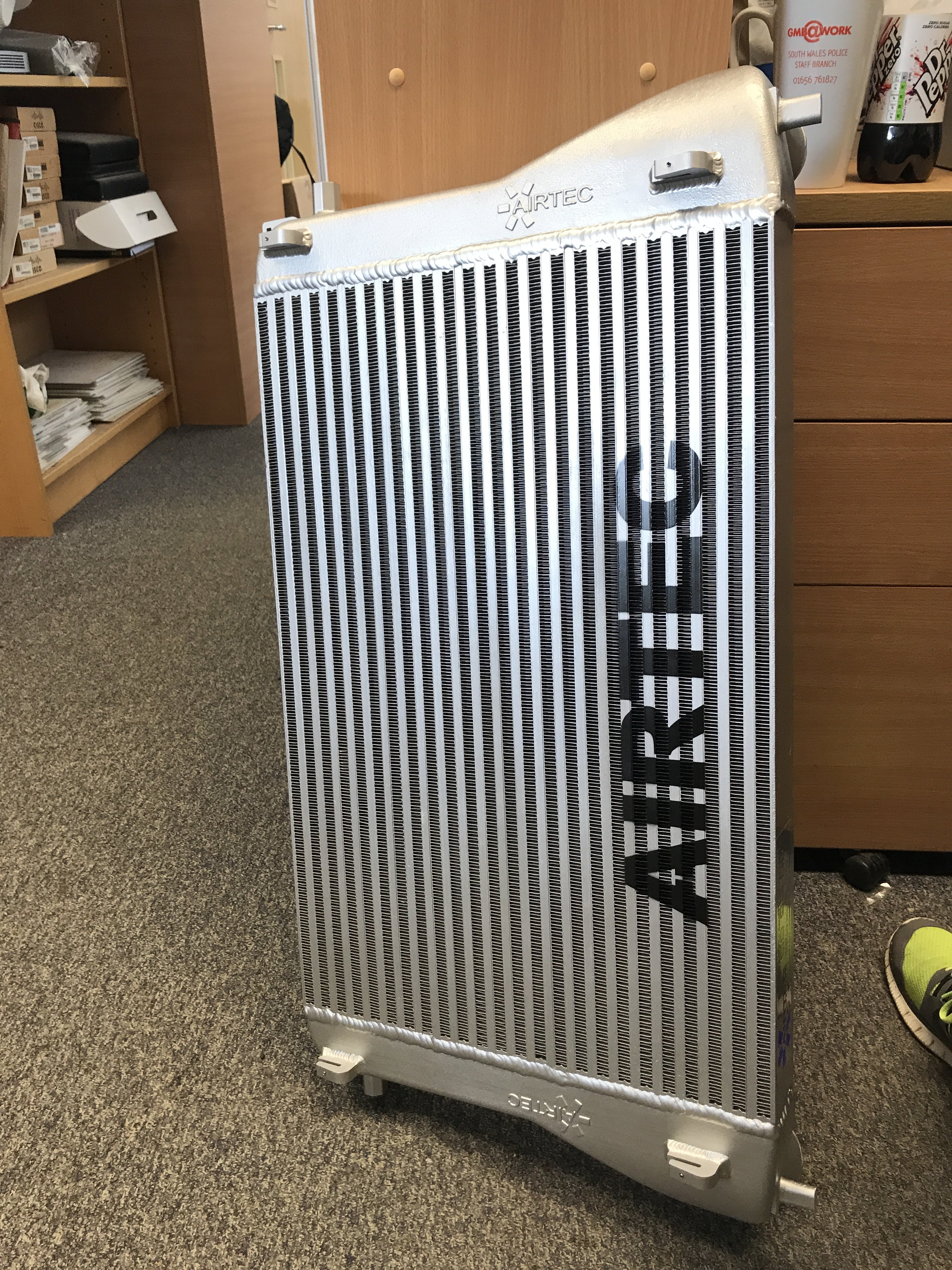

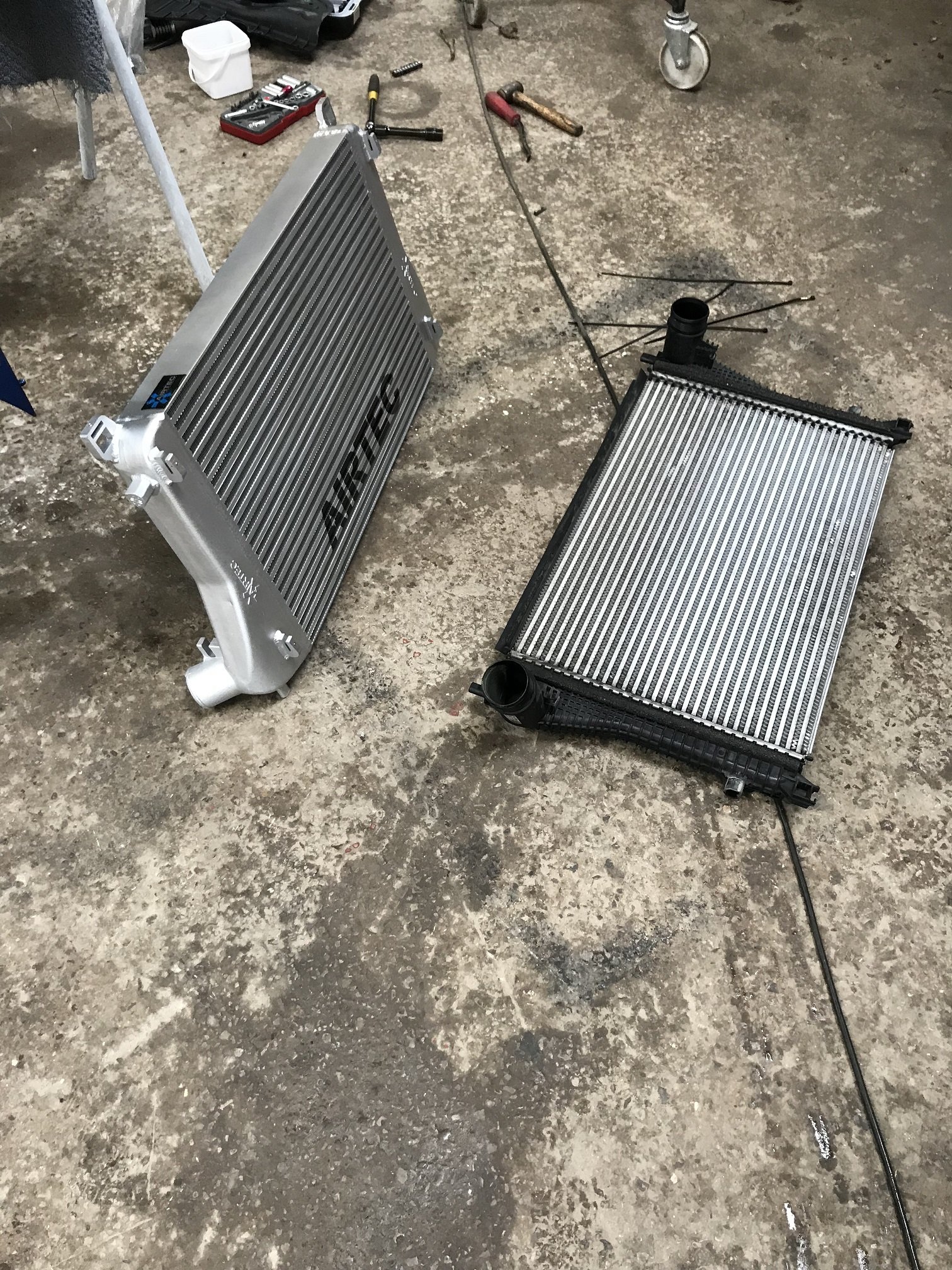

airtec cooler time. Also at around the same time I fitted a is38 turbo from a facelift audi s3.
swapped the elbow and pipe for a turbo technics setup. Much bigger.

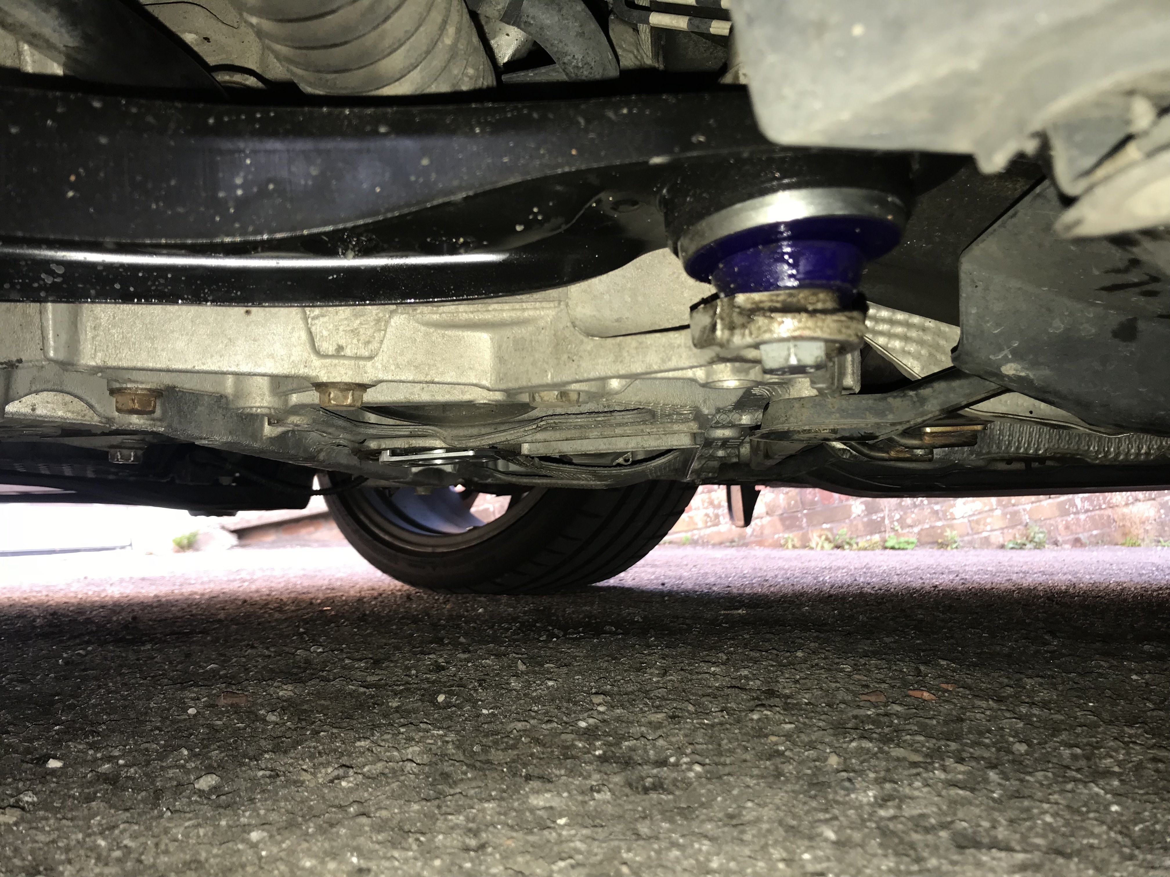

next up was a alloy audi a3 subframe, new arms fully superpro bushed including caster increase.

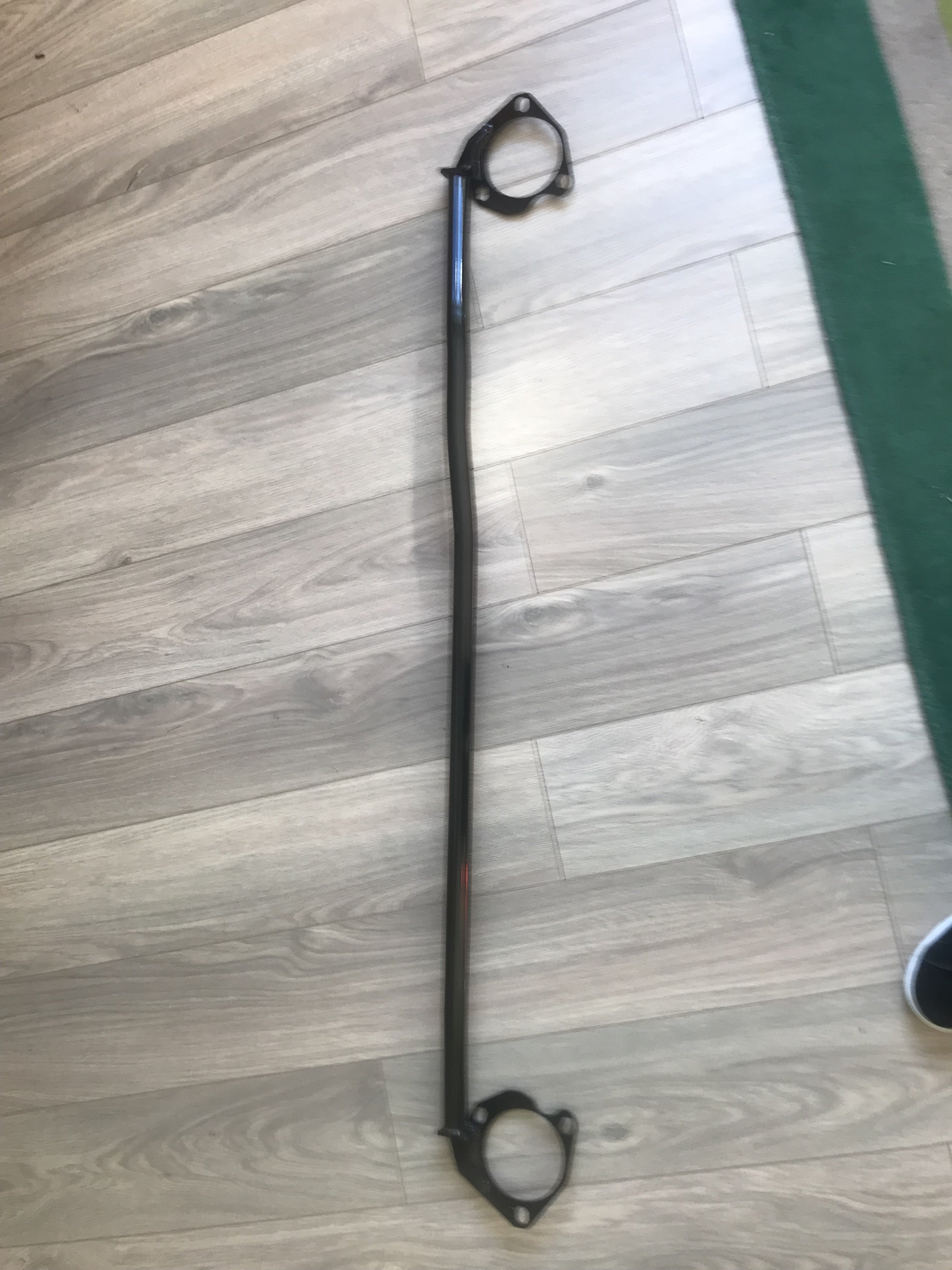

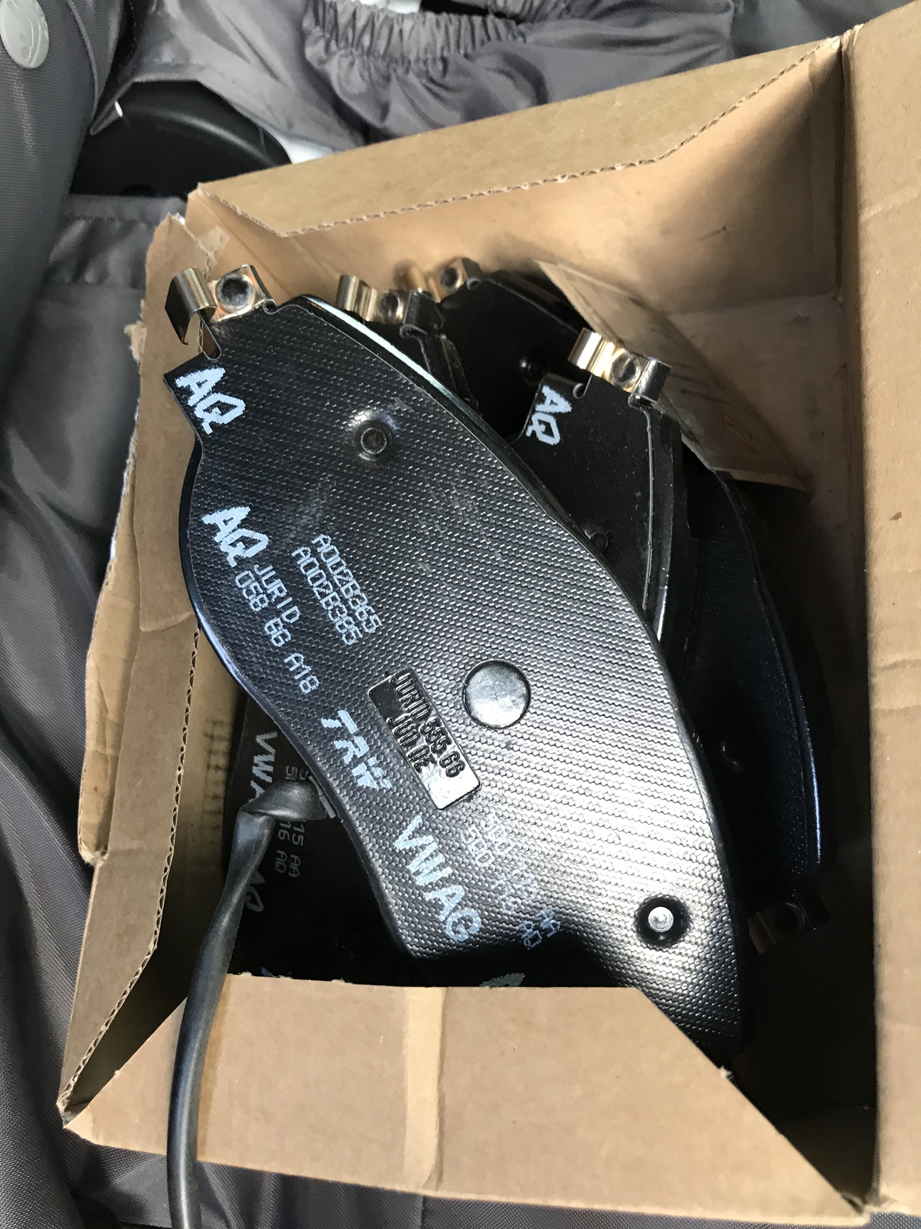

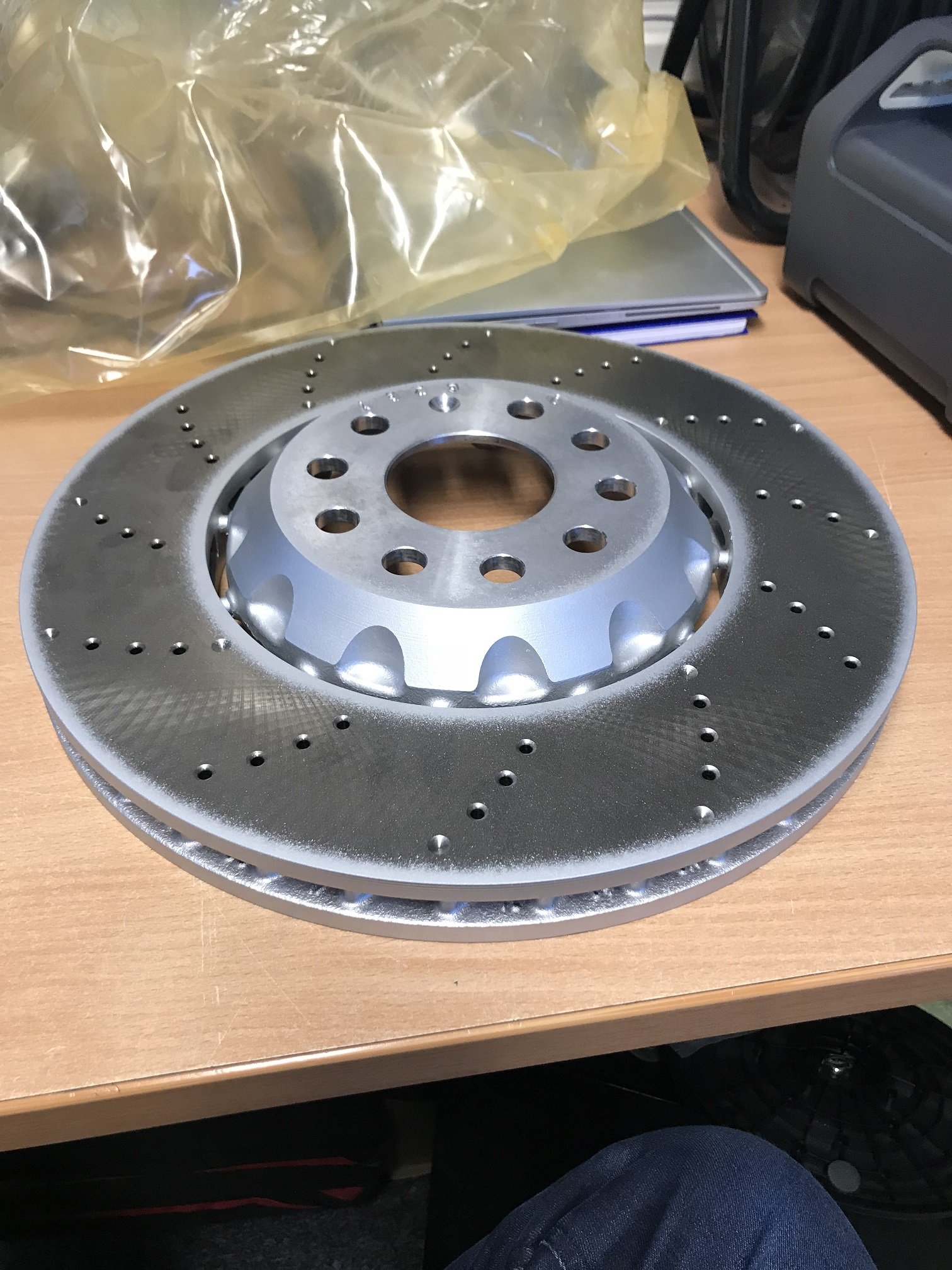

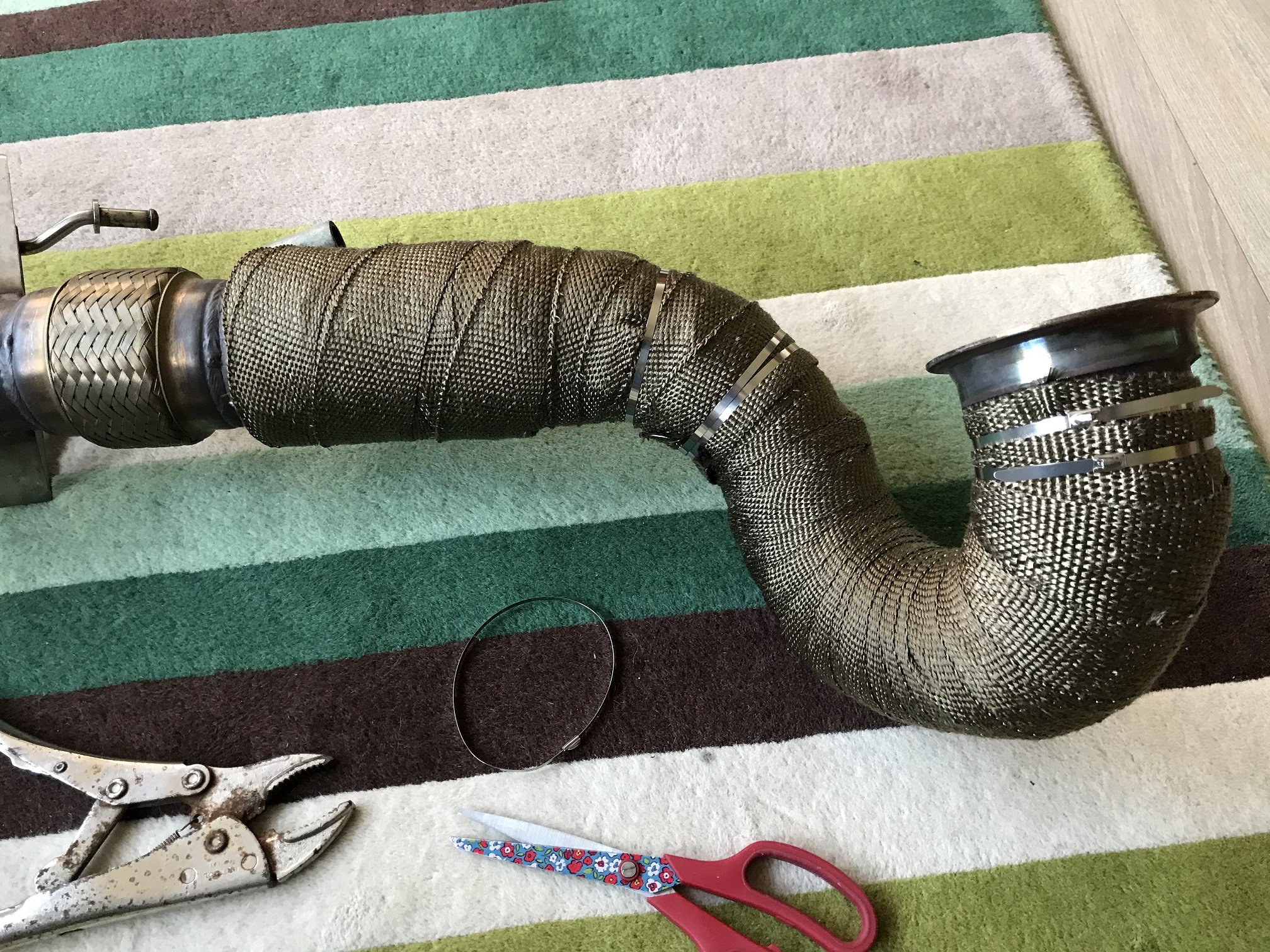

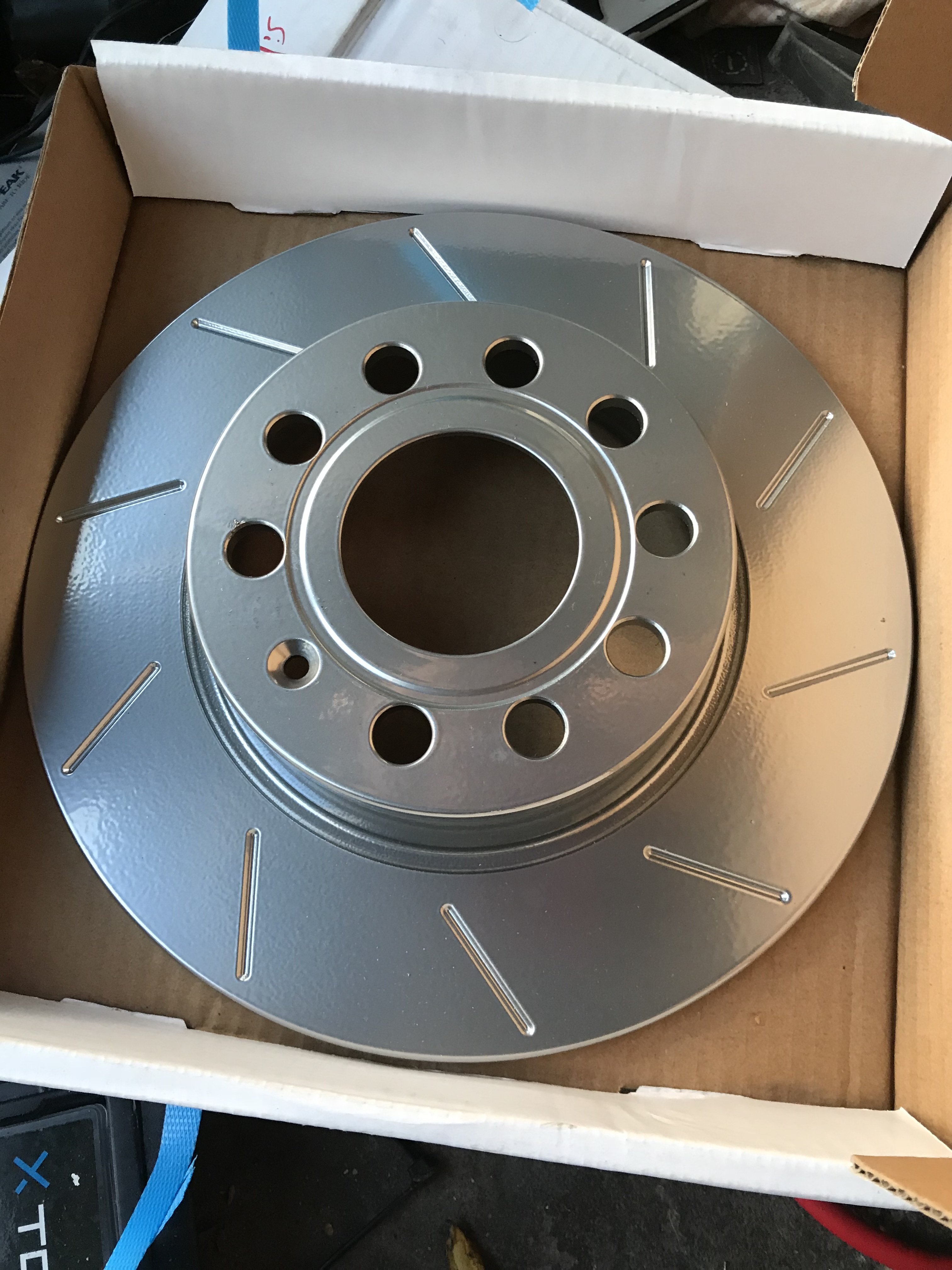

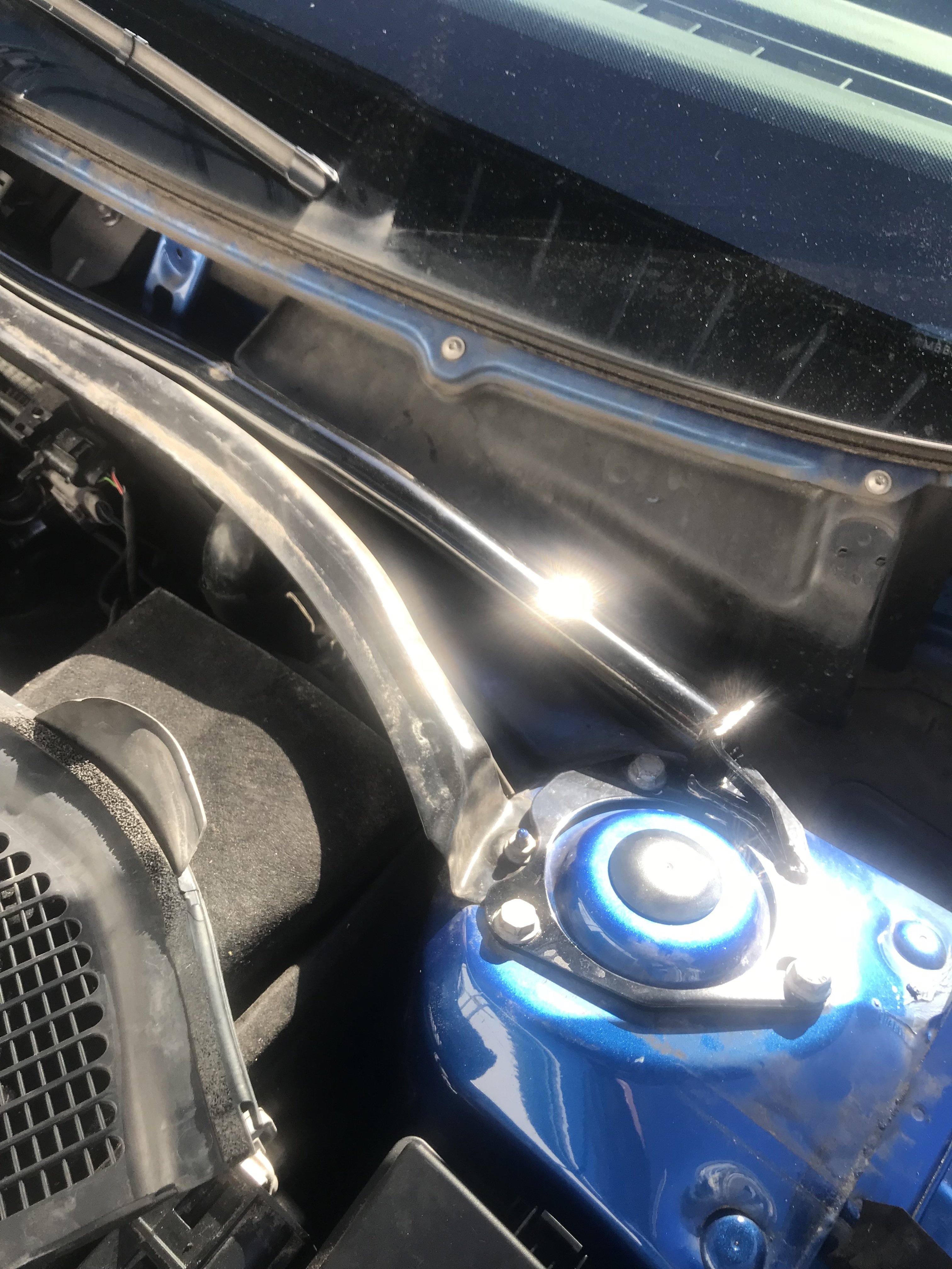

golf clubsport 2 discs and pads. mtec rear discs and pagid pads.  golf mk7 rear wiper, new dog bones and full insert, new drop links, strut brace. wrapped the dp. brake fluid. reiger front splitter. tour de france rear seat covers.

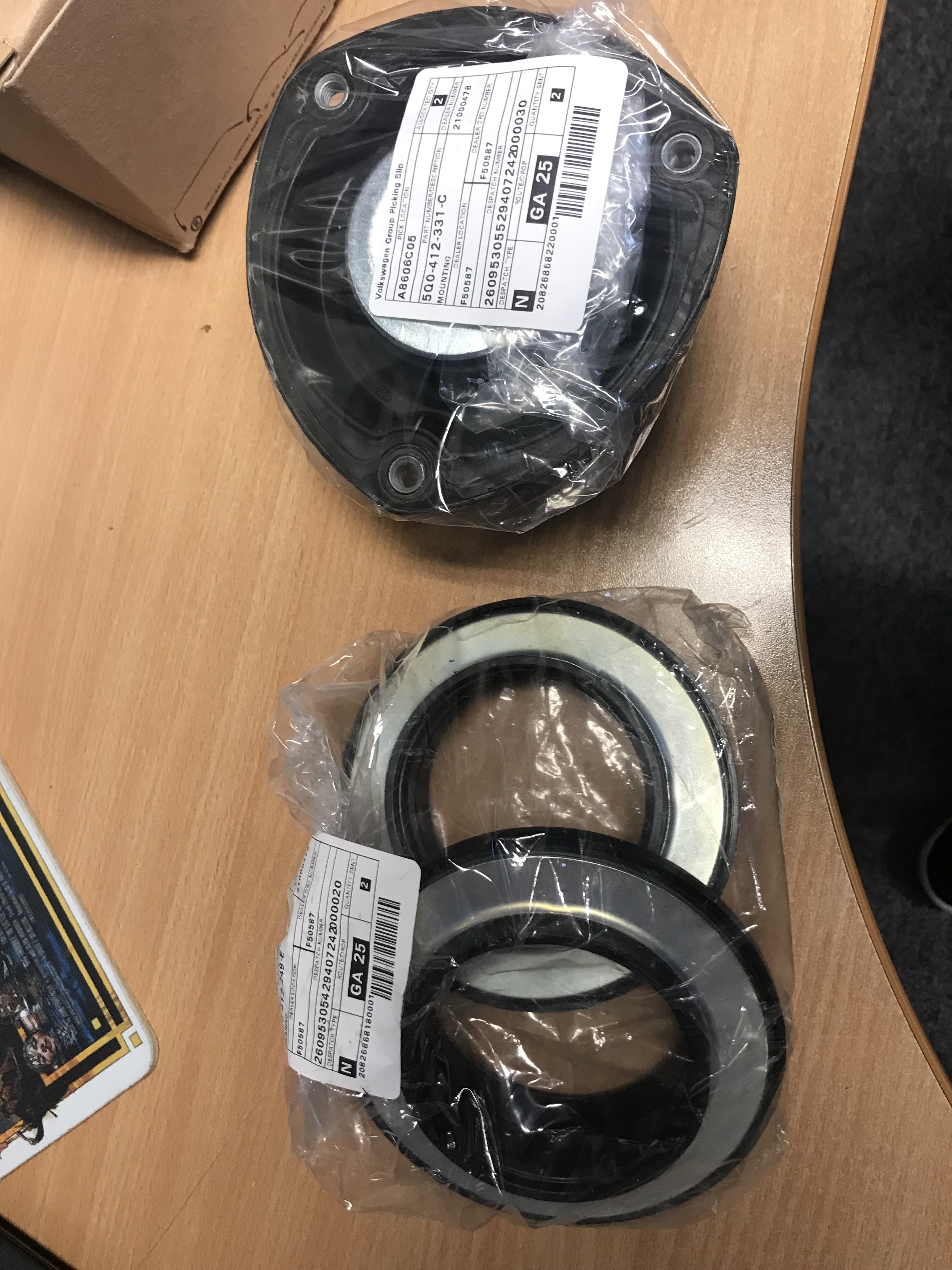

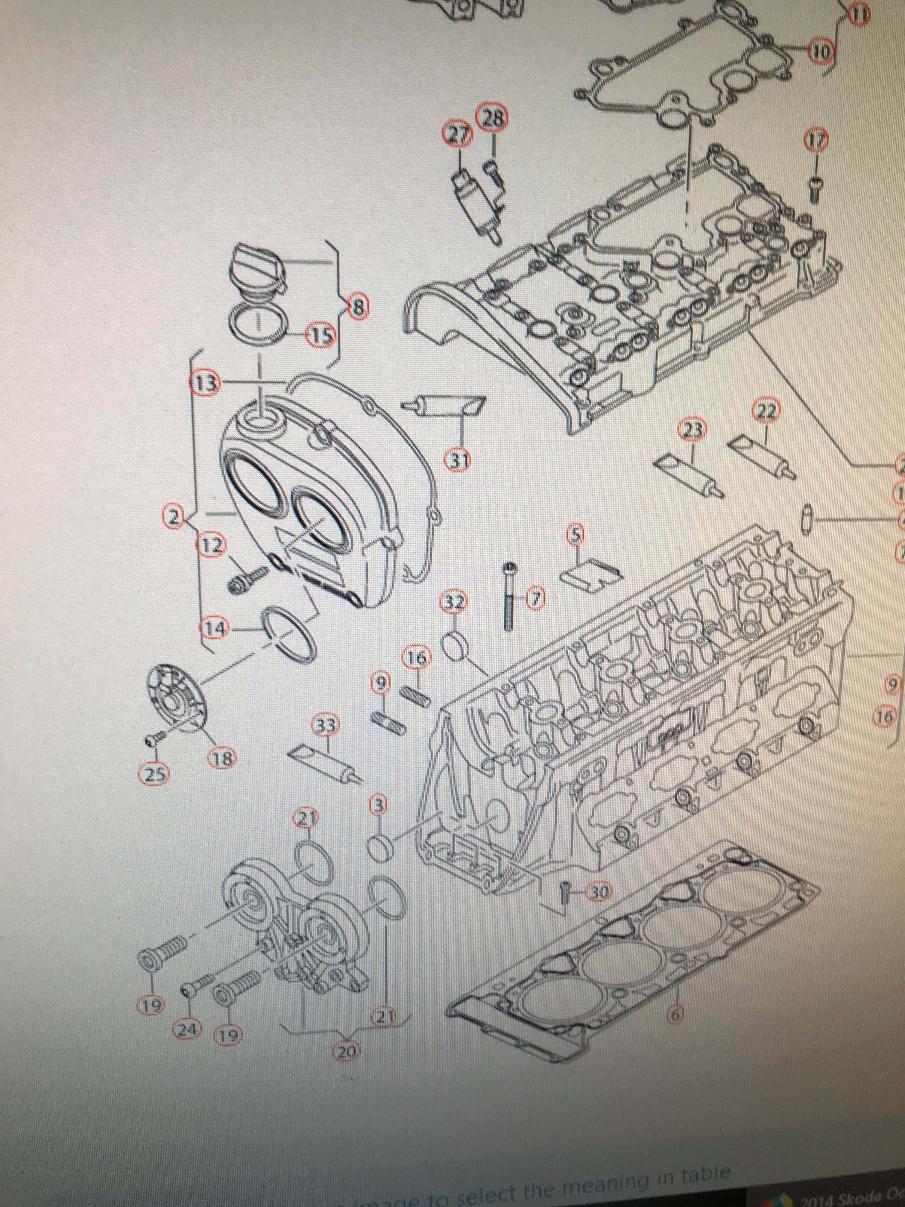

then I started getting a leak near the cam cover. turns out this is common. so got a new one and internal seals. also had to get new top mounts and bearings as mine were making a noise.

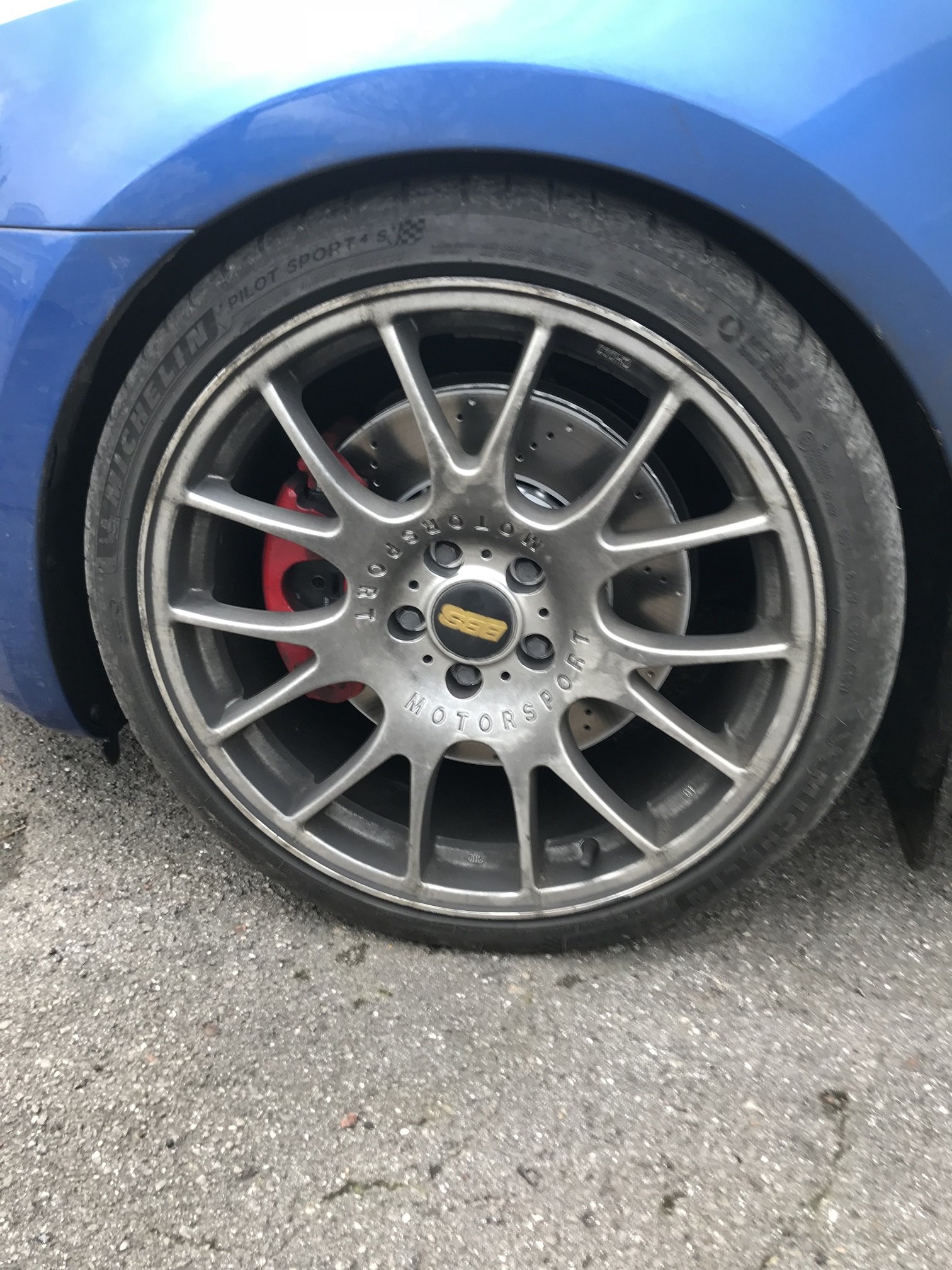

yay new wheels time. racing line 19s with mich ps4s tyres.

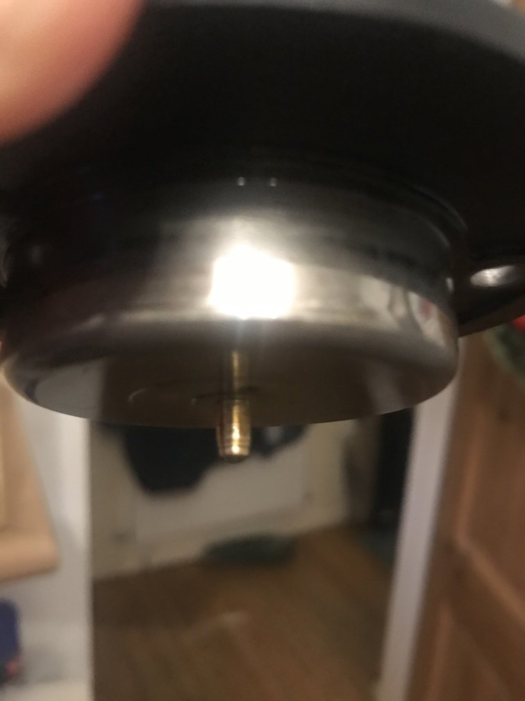

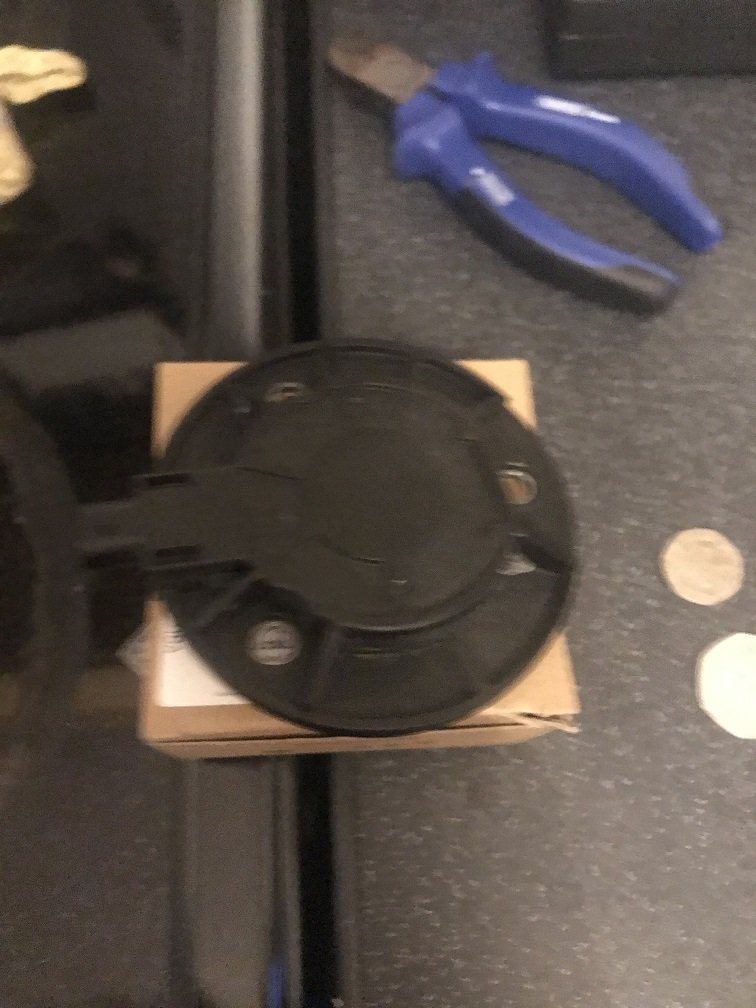

few weeks back the car was idling funny and stalling. I did some research and bought a new cam magnet. Bingo all fixed! The pipe in the middle should move freely. Mine was sticking ever so slightly and was messing up the vvt.

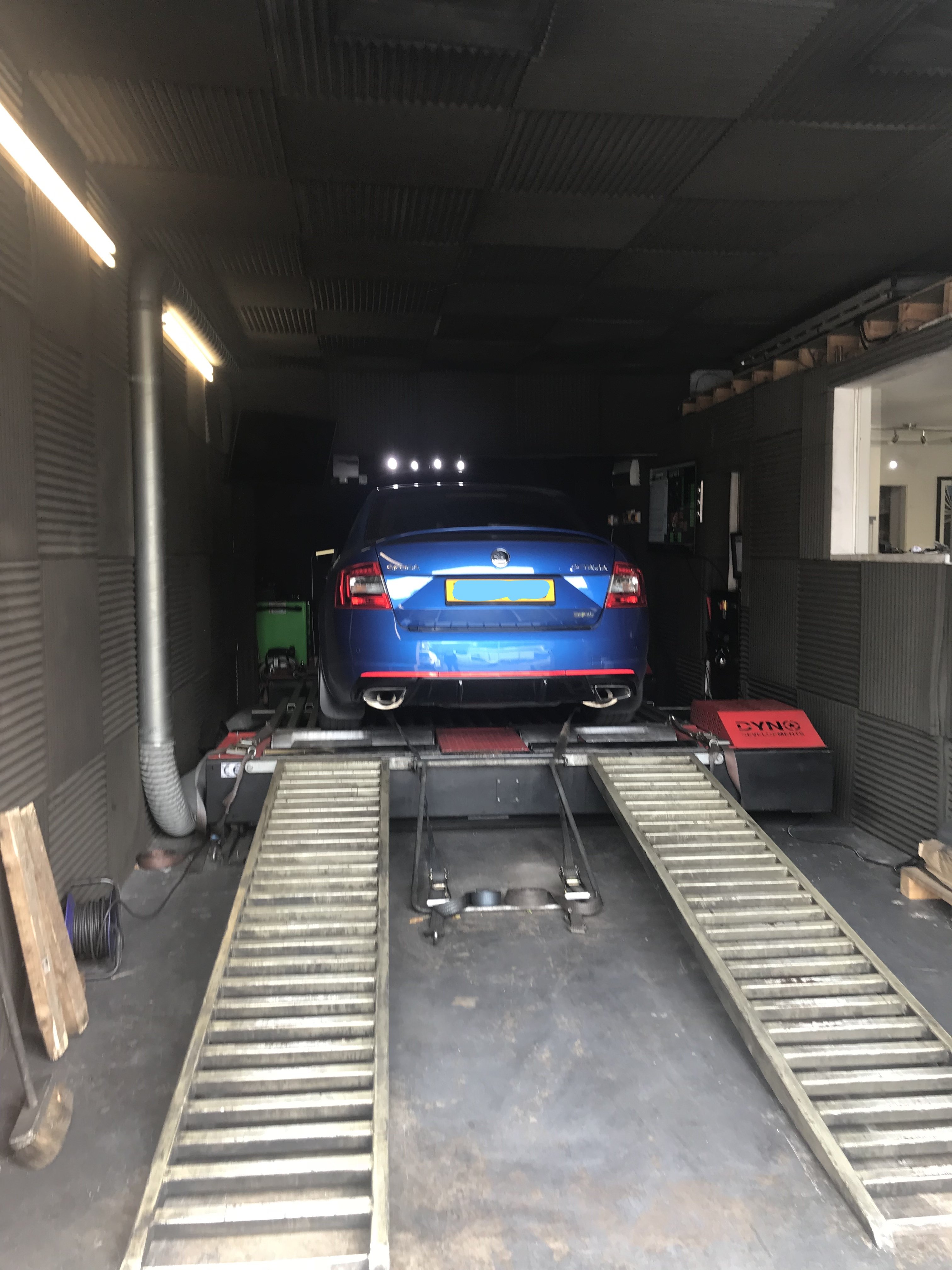

Dyno'd the car again last november at the orignal place I used (gotboost) and then hit 405bhp and again the capped 380 lbft.
So I'm pretty happy now.

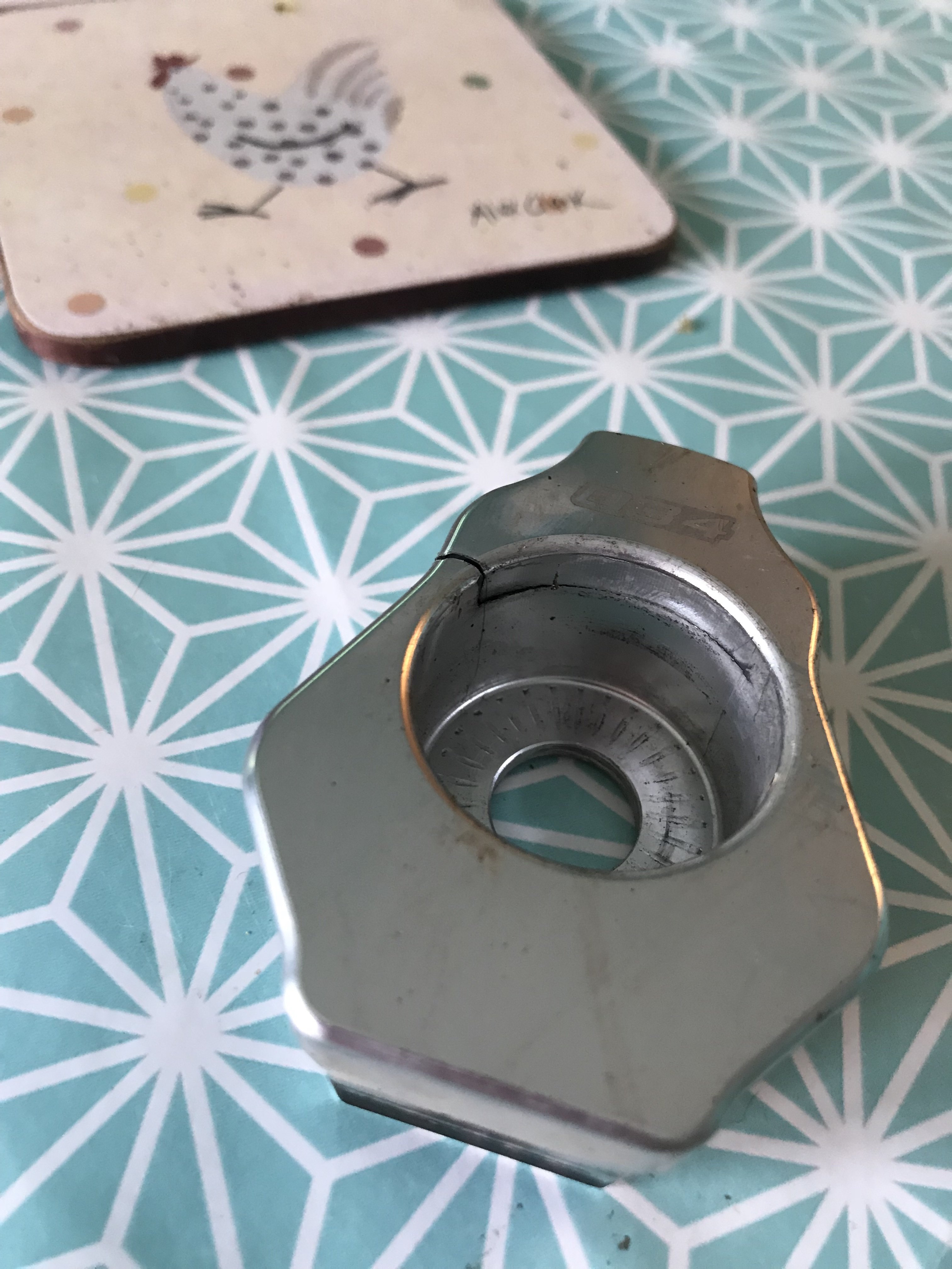

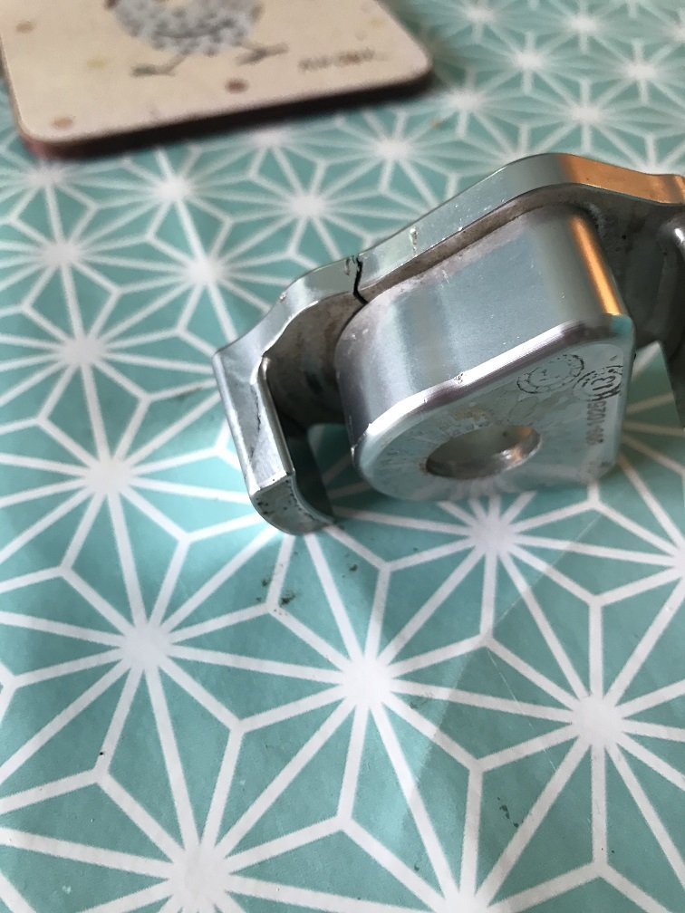

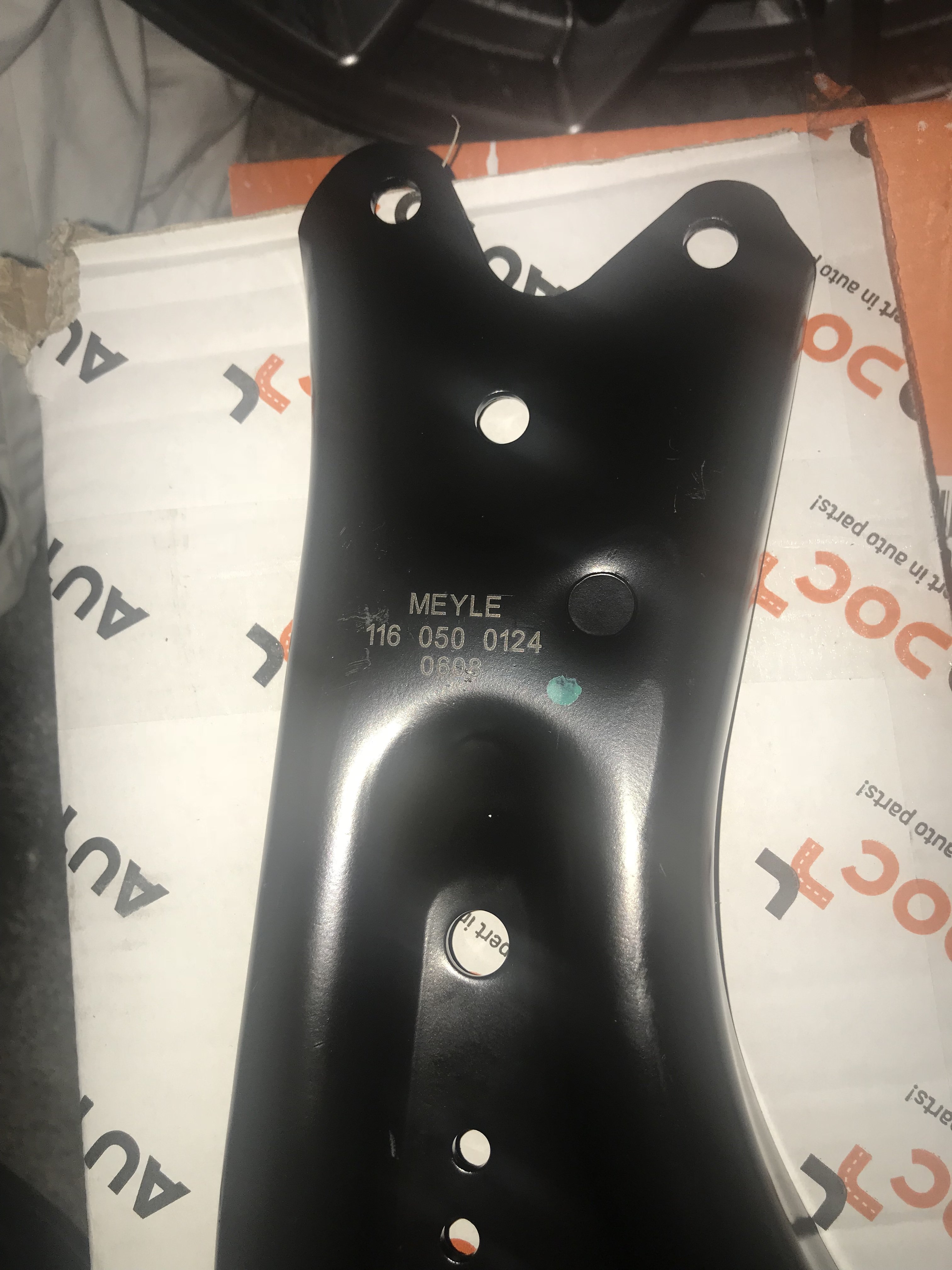

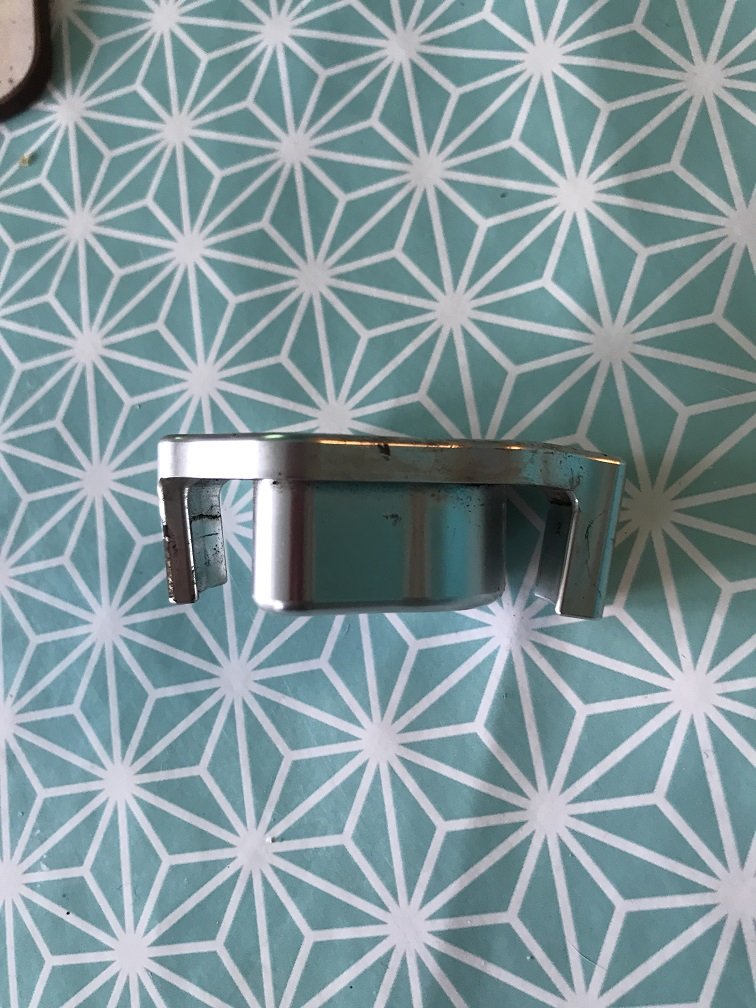

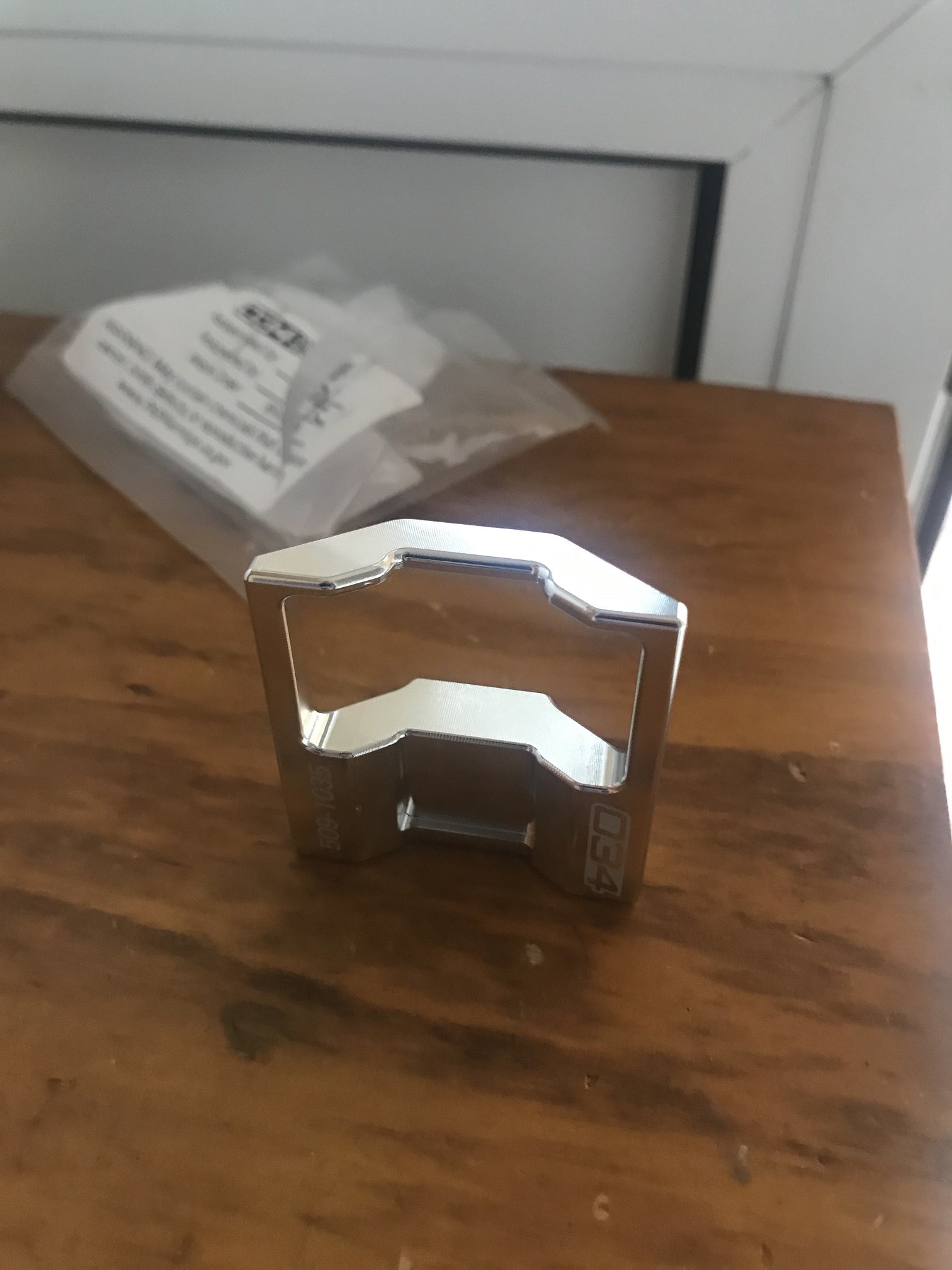

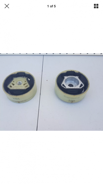

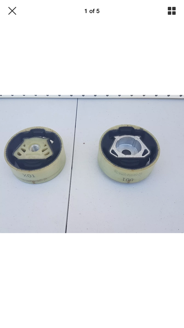

my old subframe used a different type of dog bone. take a look at the pics. that style dogbone simply doesnt work!
they crack and bend.
I've changed to the below ones.they accept the better designed mount inserts
