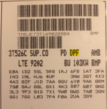

When viewing the car take a look at the build sticker, there will be one in the spare wheel well and another inside the front cover of the service booklet. The 3-digit code for the DPF is 7GG, or it will be called out specifically...
