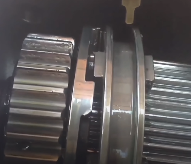

Being difficult to take it out of gear isn't normal. But being unable to put it in gear is normal - it's an inherent thing with dog engaged gears. It can even happen in the forward gears, though much less likely as they are synchromesh engaged.
It's not so much a problem it's just a non-beneficial "feature", it's not doing something it isn't supposed to be. Other manufacturers, with reverse where 6th would be, may have synchromesh enganged reverse gear as it's much easier to accidentally try put it in (if you're not used to the car - i did it a couple times in a Ford Fiesta). They won't have the same "problem" that the dog engaged reverse in VWAG gearboxes.
In synchromesh gears, when you attempt to engage, there is fluid drag between the brass ring (the golden-ish coloured ring), and the other darker ring, this brings them to equal rpms before they engage.
You can see how small the teeth are, and how they are rounded to allow it to slip into gear smoothly. Even when completely stationary, they will often slip in just fine. It is possible that they end up point-point and won't go in though. Again, just blip the throttle, or quickly putting the shifter into the oposite gear then back again, will move the contents of the gearbox enough that the synchromesh teeth will now mesh.
In dog enaged gears, there is no rev-matching brass ring, you simply have large teeth which interlock. If they are not aligned (they just happened to come to rest like such), they simply will not go in, no matter how hard you try, it feels as though "theres something blocking it" as it's literally the teeth pushing against each other rather than sliding between each other.
Move your lower jaw forward so your lower teeth go in front of your upper teeth, then try and close your jaws together - they won't because your teeth are jamming against each other - it's the exact same scenario here.
In the picture below, the teeth are aligned in such a way they would go in to gear. If the big teeth were not aligned (like jutting your jaw), it simply won't go in, not without spinning the shaft so the alignment of the teeth changes, so they can engage.
Honestly, i think you're being overly tentative having had a previous issue and are noticing things and thinking they're an issue. It's fine to think such things, but please, read the thread, i've explained numerous times the mechanical reasons why it happens.
A new gearbox will do exactly the same thing, it's just pure chance if the shafts come to rest in a way where the engagement teeth don't align in a way where they'll go in.
Of course, being unable to get out of gear is a problem. But being unable to get in gear, while everything is stationary (about to reverse out of your drive, or whatever), is perfectly normal, can be annoying, but it's normal.
