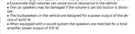

I found somewhere online in Boleros manual that un-amplified is 4 x 20W. Actually its about loudspeakers but it is giving some indication... Logic of keeping it secret is that actually that information in built in systems is quite unrelevant for regular customer, who don't give red penny about these clever numbers. :) . About new speakers You could check first, what kind of ohms are in use (4 ohms? 6 ohms? 8 ohms?). I remember from old times when i had my first Octavia RS there was 6 ohms and it was really pain in the bottom to find replacements. More easy was add amplifier and then attach proper speakers. Only woofer imho will not be enough, but as different persons have different requirements for sound quality, so never mind my opinion, it will anyway better, then without...

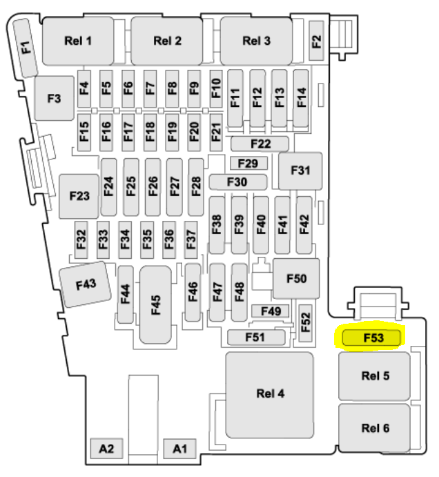

Hello,
I have identified in the fuse box inside the car (under the steering wheel) a fuse that I believe suits well because it is 30A and it is dedicated to heated rear window, that as far as I might remember I have never used in ten years with my previous Skoda. It is the F53 fuse in the picture below.
The only drawback it is that it is "always on", so not connected to ignition key; by the way, also the other fuses with big capacities (from 15A to 30A) are always on.
This shouldn't be a blocking problem because the subwoofer has a (blue/white) cable that can be used just as power switcher and should be connected to the ignition key switch AA position line.
The question is, where to take this switch signal? Does the head unit, that I will need to access anyway to take the signals from left/right speakers, have also a cable that might serve the purpose?
P.S. Apologies, I cannot remove the 2nd picture, duplictaed
Edited by MaxOrsiniVaraldo
Anyone for this question?
The question is, where to take this power switch signal? Does the head unit, that I will need to access anyway to take the signals from left/right speakers, have also a cable that might serve the purpose?
Almost all dash cam fitters use the blue 15A rear wiper fuse.
I too noticed when choosing a fuse to use, that fuses that on all my previous Skoda's were switched live, but for some reason on the Kodiaq were permanent live, as you've discovered. The heated rear window won't operate without the ignition / engine being on, but it seemed to be a permanent live on my Kodiaq i.e. it would supply power to the dash cam with the ignition off.
You should definitely find a switched live, it could cause you unwanted battery drain problems in the future if you're connecting electrical items up to permanent lives.
Thank you for the feedback. Ok, I will search better for a suitable fuse that is not permanently live, hoping it exists in the internal fuse-box.
