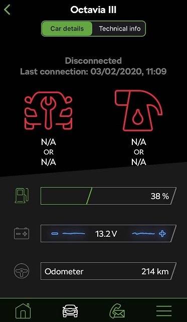

Last week I've purchased a brand new Octavia, and I've only done ~215 KM so far.
The issue is that in the infotainment, on service menu, it shows only the VIN no., and no other details regarding the next inspection or oil change.
I've asked the local dealer and he said that this information will appear there after the first inspection / oil change. Somehow I don't really believe that and I think more likely this wasn't set from the factory.
I've also attached a photo.

More likely it was set at the Factory on Variable Servicing and their Tech or Fitter messed up resetting at the PDI or when changing it from the 'In transit' setting.
I have bought one brand new car and few motorcycles and they needed first oil change service around 1000km.. Does Skoda require something like that or is it normal 30.000km/1 year for first oil change?
Maybe it shows empty, because service interval is not set and they’ll set proper interval at first service🤔
Skoda does not require any early Oil / Filter or Service in the UK.  & not Globally, but some Dealers offer that, an early Inspection of a vehicle. Top up fluids etc.

I think that should be 30,000km OR 12months, whichever comes first.
You should not have to do it yourself.
It is 30,000 km or 24 months which ever comes first from the Factory..
Some might set a 372 day Inspection service.    Some might set to 372 days / 9,600 miles for Fixed Servicing.
  @CBPT
The Service Interval needs set.  Someone at the Dealership is just telling you rubbish.

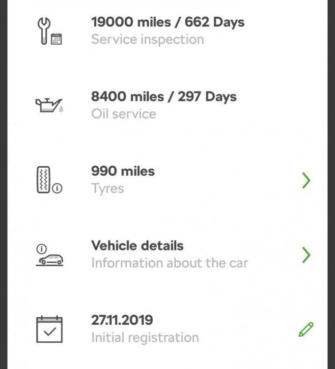

Here's what the Connect Lite app is showing for my new Octavia -

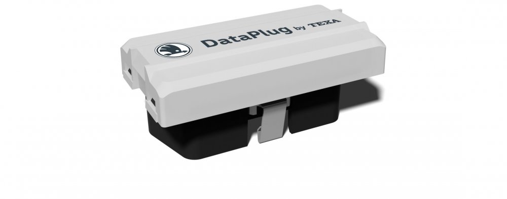

Skoda Connect Lite makes ”not smart” car smarter with dataplug. I have planned to buy it, it was only 5€ from eBay or 59€ from dealer :)
Have you got a reading on the Digital Sevice Plan on the My Skoda app. Mine shows the PDI
@Tolpol62
Your car shows that it is on Fixed Servicing.  Did you ask for that, or do you have a Service Plan?
Am I right in thinking that a VW Dataplug will work in a Skoda as the Skoda is just a Golf with a different skin?
Many thanks
Many thanks
I purchased one and it works fine on my 65 plate VRS
Top reply!
Thank you squire😁
Yeah the VW data plug for £4.99 inc postage works a treat for me.

I cant check till I'm back in car, there's more tire info in the sub menu. I'll look tomorrow.
@Roottootemblowinootsoot
Mine is a motability car, so whatever service plan they use, I'm not sure.
Motability have the car left on Variable Servicing usually.
I just returned a Motability car with a 2.0 TDI SCR DSG at end of lease back in November.
If the car has to go in in a year they will not argue really if that is how the Dealer put the car out.
