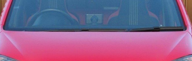

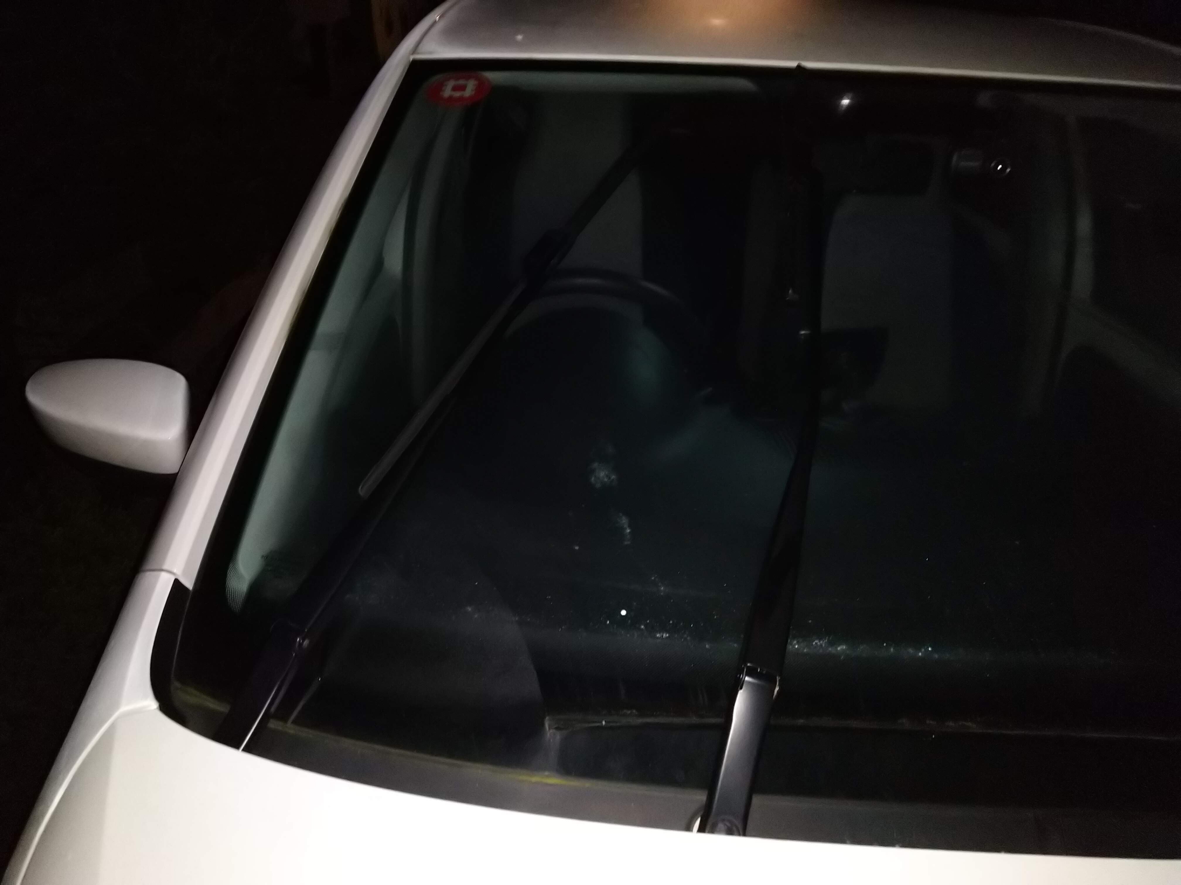

You have the longer arm on the driver's side, why would anyone do that? So you need to swap the arms over. This is how they should be in first photo then in service position.
