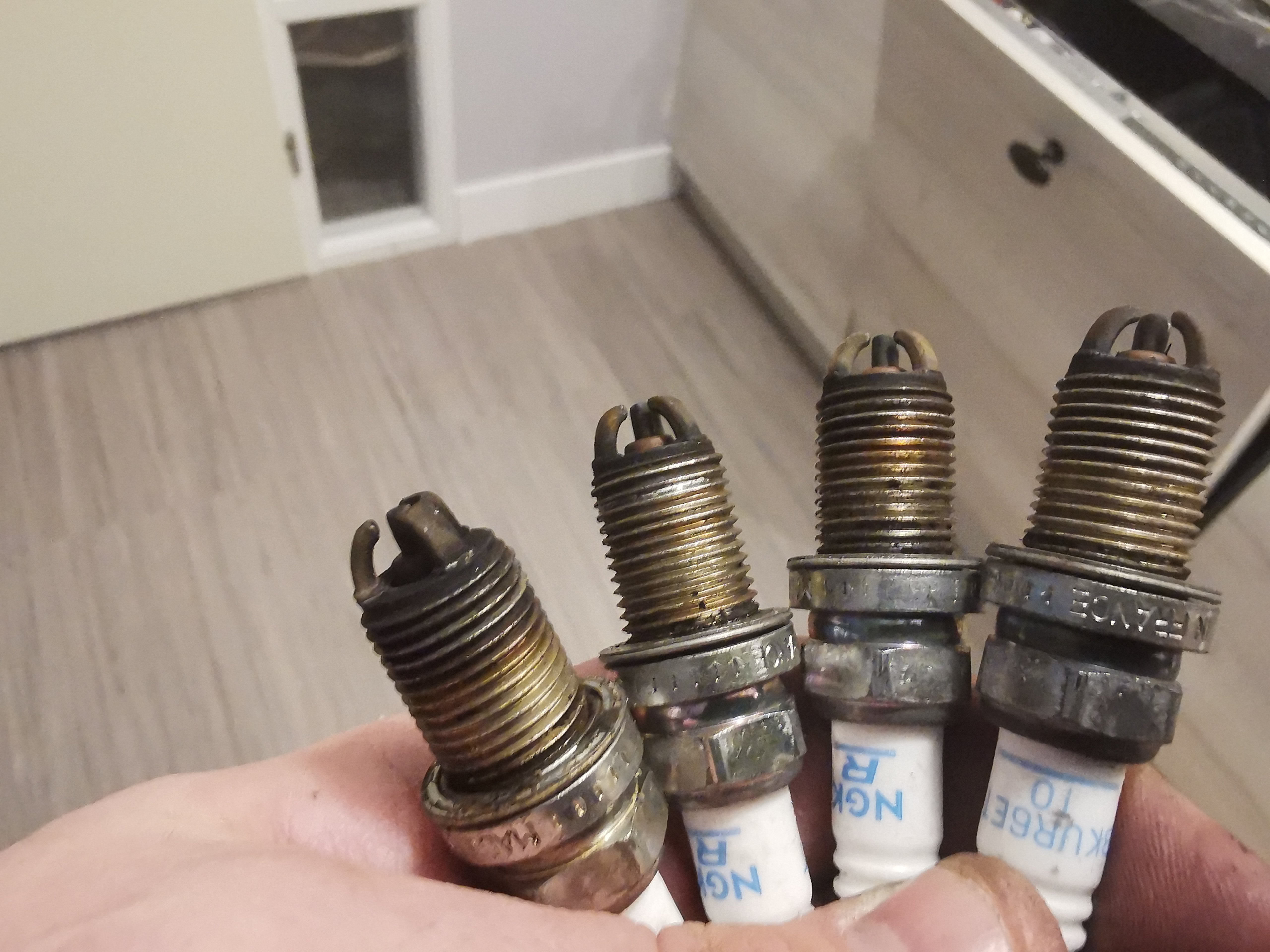

It was the coilpack. Still same after I replaced the plugs, but when I moved the coilpack, the misfire moved as well.
Interestingly the coil that was broken looked neew and shiny but is a VW park with year code 04 l, so came with the car. The coilpack that was replaced on cylinder 3 a few months ago didn't look nearly as good. But running fine now, and have a spare coilpack in the car now.
This is how the plugs looked.
