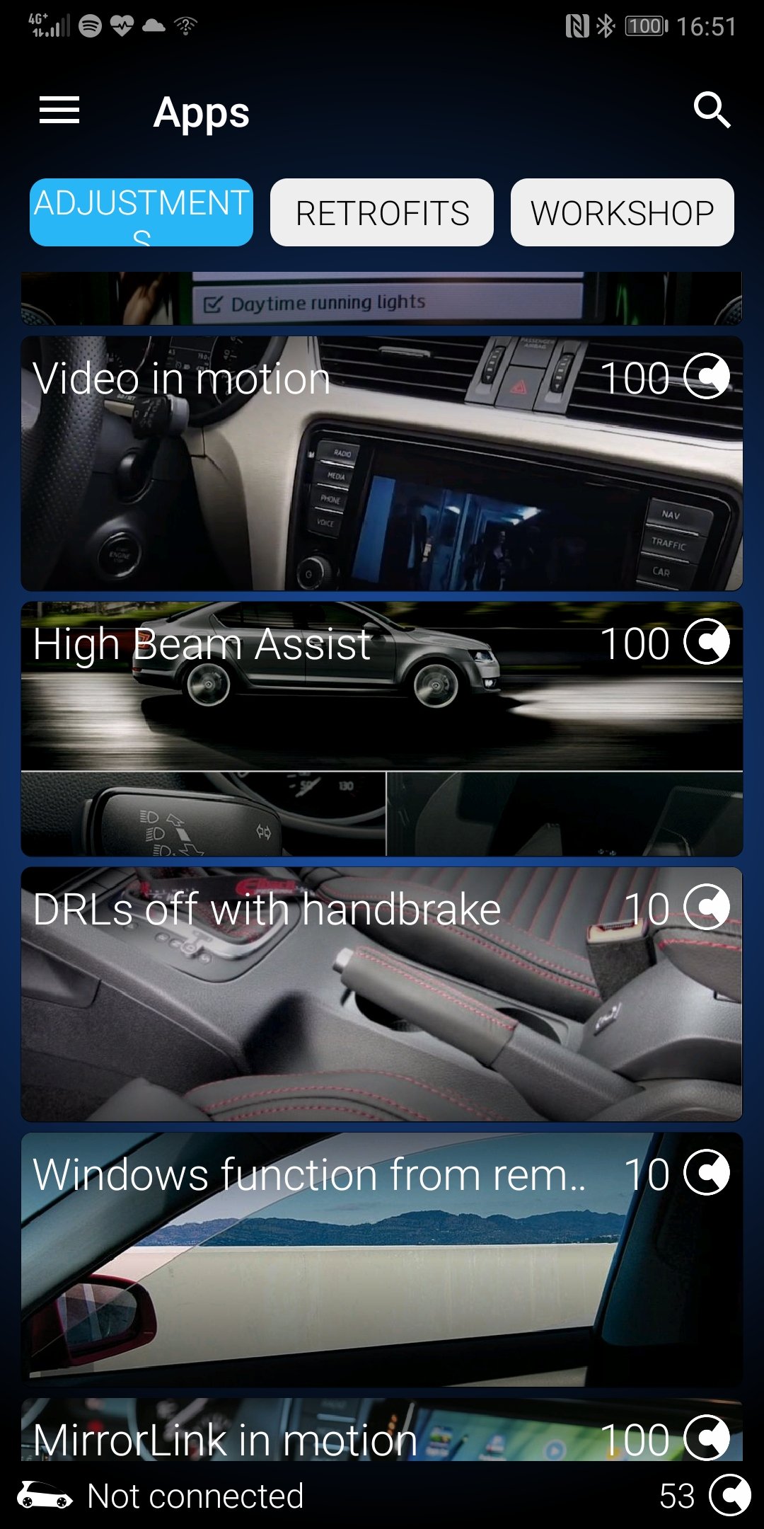

I just used the application in the OBDeleven app rather than the long code above
Try to avoid using apps.
Lots of discussion about this in different forums. Possibility to s.rew up is high, up to bricking the modules.
