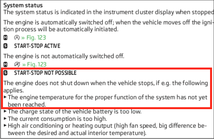

Another factor that will prevent stop/start from working is if the engine isn't up to temperature.  Could that be the case for the OP, given the time of year that we are currently in?  It's certainly the case for my Yeti: this evening, driving through town, stop/start didn't operate until the engine temperature was up to ~70°C.  I don't think the battery voltage could have had anything to do with it: stop-start traffic, mostly in 20mph limits, is hardly going to give a massive boost to the battery.
The May 2017 edition of the Yeti owner's manual states:
The bit in red does not apply to every engine of model.
You can start a TDI or TSI with the ambient temp below freezing and move a few feet and Stop / Start work when the coolant has not started to heat and neither has the oil.
Just a nice strong battery and no demand on it and the heating knob not cranked up.
