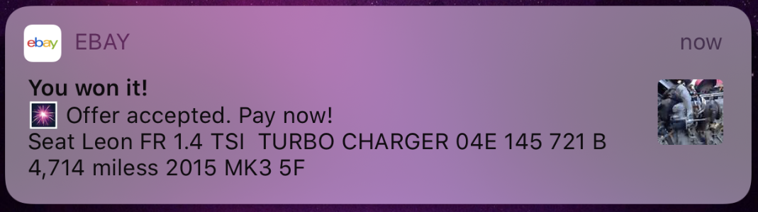

On another note, a spinny blowy boi from none other than a 1.4TSI may have been purchased...
So, another update to the build. Finally.
The 1.4 turbo i purchased some 10 months ago was fitted shortly after it arrived, and was unsuccessfully mapped in quite a few times by multiple people.
After quite some time talking with JBS about EA211 engines and turbos, they told me that they'd decided to develop a hybrid for it finally. Sooooo.. I'm the first person with the JBSL12 Hybrid Turbo!
