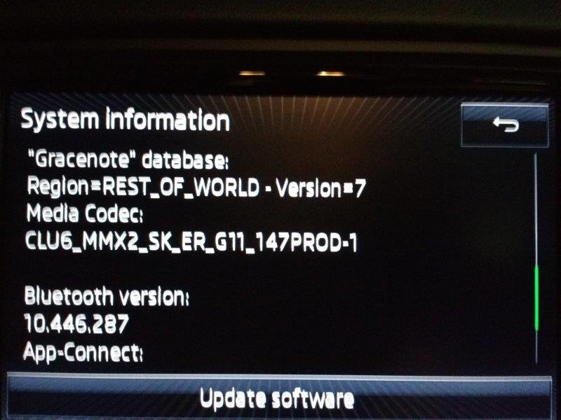

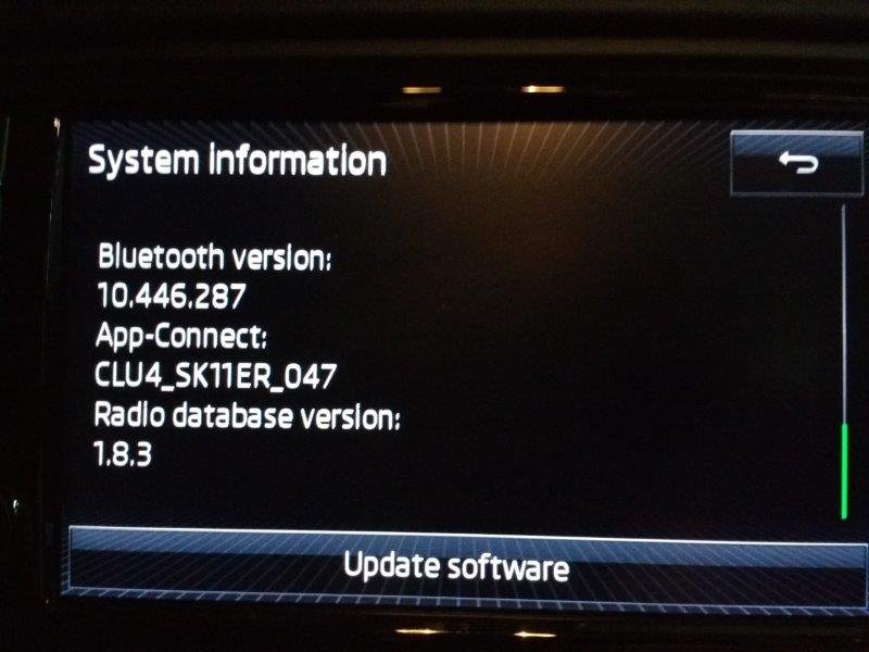

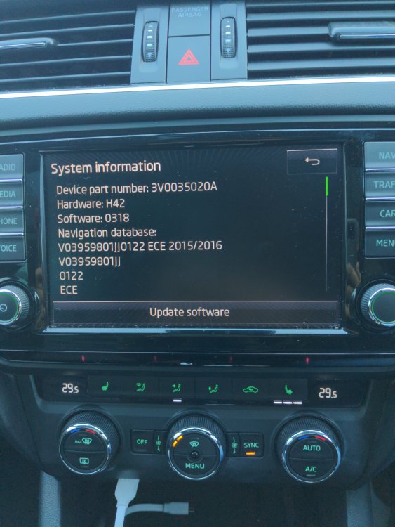

Thats annoying, could someone whos telephone button is working let me know what firmware version they are running?
Attached is my firmware version.

I will check my car tomorrow but I'm pretty sure it's SW version 0492
I believe there's one version after mine.

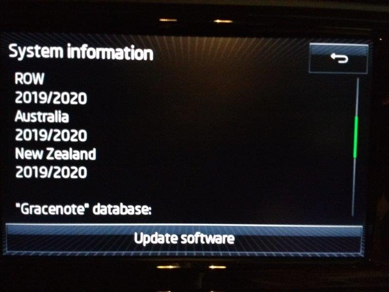

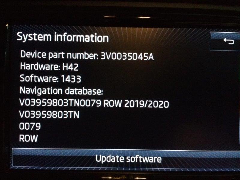

This is after the upgrade.
@CajoLajo which file did you use? I tried one from i found online. But the sd card was not being recognised for some reason. Formatted to FAT32 aswell so am thinking it couldn't have been the right one
This was done by the dealership. I could not find anything suitable online.
Well, not entirely true, I installed the navigation database files. It took a long time to complete. The files are available on Skoda website, but not for the firmware. I paid around $90-95 to the dealer.
