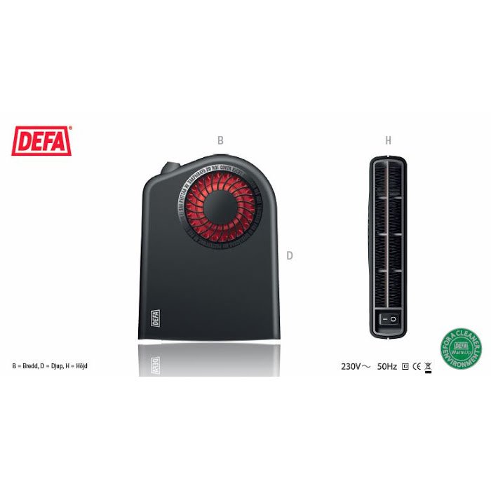

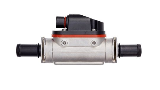

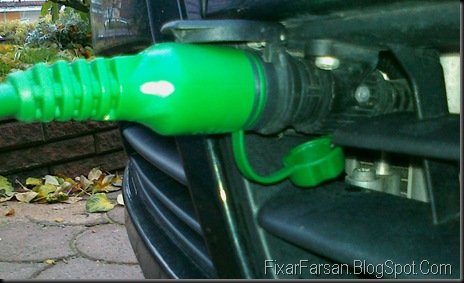

In Sweden we use these in our cars:
together with this for the engine:
and a car plugged in, getting heated:

Could you provide a link where I could find out more info? Thanks
http://old.defa.com/vfp/eh/422810.pdf heater for the 1.5 tsi
43005690_E03-Termini-II-Userguide-Part1o
1920254.pdf?timestamp=1581716876
https://www.defa.com/electrical-preheating/engine-heaters/
https://www.calix.se/en/vehicles/cars
Has been using both systems in differernt previous cars (last was Calix on my Octavia RS230), both systems can completed with separate components, they working  quite well only problem they need wall plug access... In personal yard it is probably not problem, outside that it is not so easy... Anyway at least it is really pleasent to start day with warm car, de-iced windows and inside car is also dry. 👍
