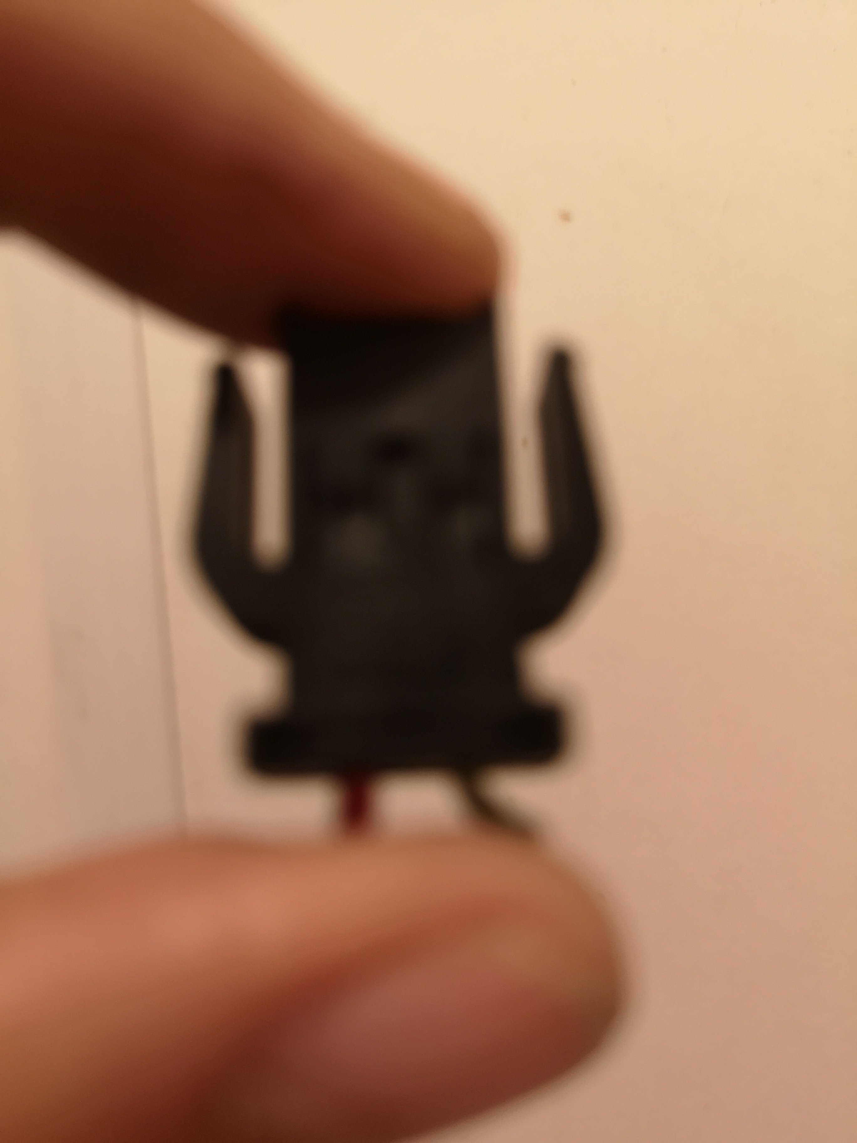

I recently brought some after market speakers for my parcel shelf and whilst looking in the boot I came across two connectors. One on either side.
So I thought the connectors might be for speakers but when I cut one of the connectors off while the car was completely off I got a spark now I'm not very mechanical minded so if anyone could tell me if the know what this connector is for would be much appreciated the only thing I can see on it is the VW and Audi logo
Boot lights?

+ 1 for boot lights & +1 for the following response.

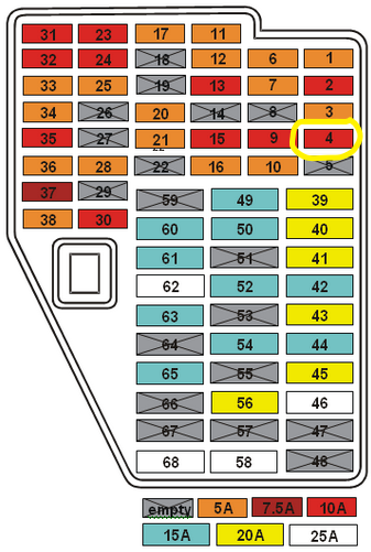

Next port of call should be the fuse box.
You've probably blown fuse number 4 (10 amp) in the fuse box on the end of the dash.
Stuffing 12volts onto a speaker might not have been a good idea long term!
