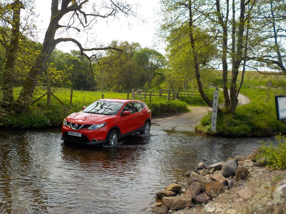

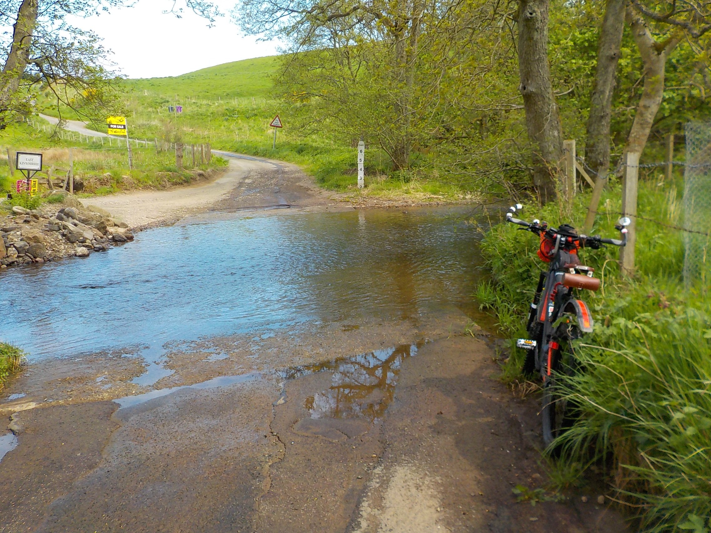

I see people drive through here at higher levels and who likely have no idea where their air intake is.

The news at the weekend showed some total nutters in cars around Renfrew / Paisley.
In vehicles lower than this bampot was in.
