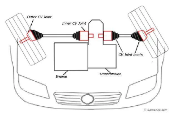

All the possible moving parts will be in these areas...
As mentioned hidden noises are likely to be wheel bearing or transmission / gearbox related.

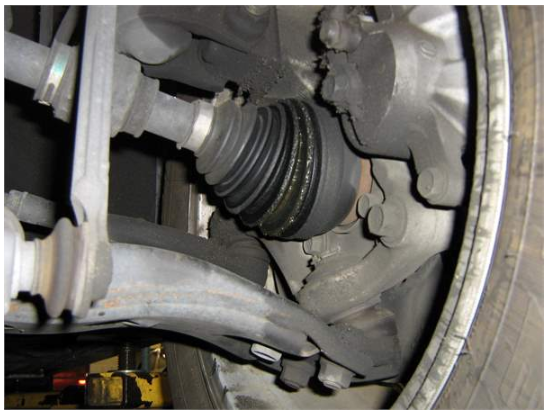

What do your CV joint gaiters / boots look like? Any splits / grease leakage?
