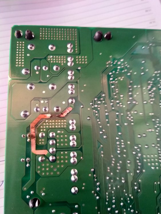

Hi can anybody help my 07 Skoda Roomster convenience module has  damaged circuit as per picture can anybody tell me what other convenience modules are compatible with mine which is a Siemens unit serial no 6Q1973049E any help would be appreciated

Any idea why that happened? Looks like it could be repaired with a piece of wire soldered across the break, but unless you know why it may have blown it'll probably happen again.
What function stopped working to make you look for this?  Any blown fuses?
Whereabouts are you?
As far as I can tell, your part number should be 6Q1937049E, not 73, and hasn't been superseded by any other numbers.
It appears that somebody interfered with wipers as when the motor was powered up the wipers went down into the bonnet apologies for my typing with the part number
