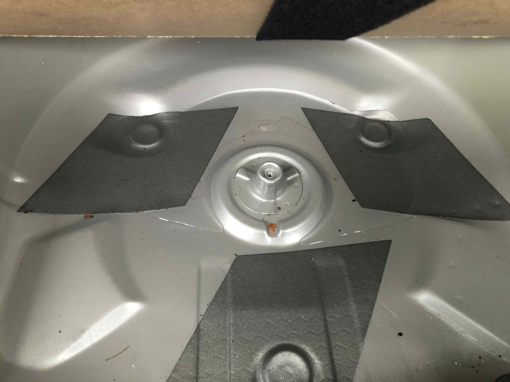

I opened the trunk and I found the carpets completely wet. The I pull up all carpets and found a lake on the reserve wheel space.

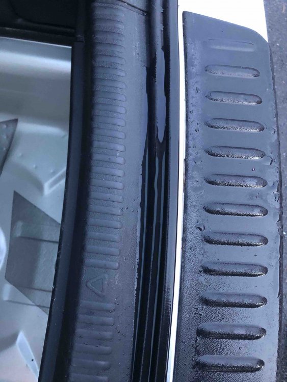

old thread i know. but i discovered today, my 2013 rapid also gets wet around the rubber like yours, mine is not a spaceback though..
it is raining heavy today, so took of the truk lid coves(was a bit wet on the left), and sat in the car, could see the rubber got wet, and water creept in at bottom left.
might need and adjustment of trunklid... any ideas?
