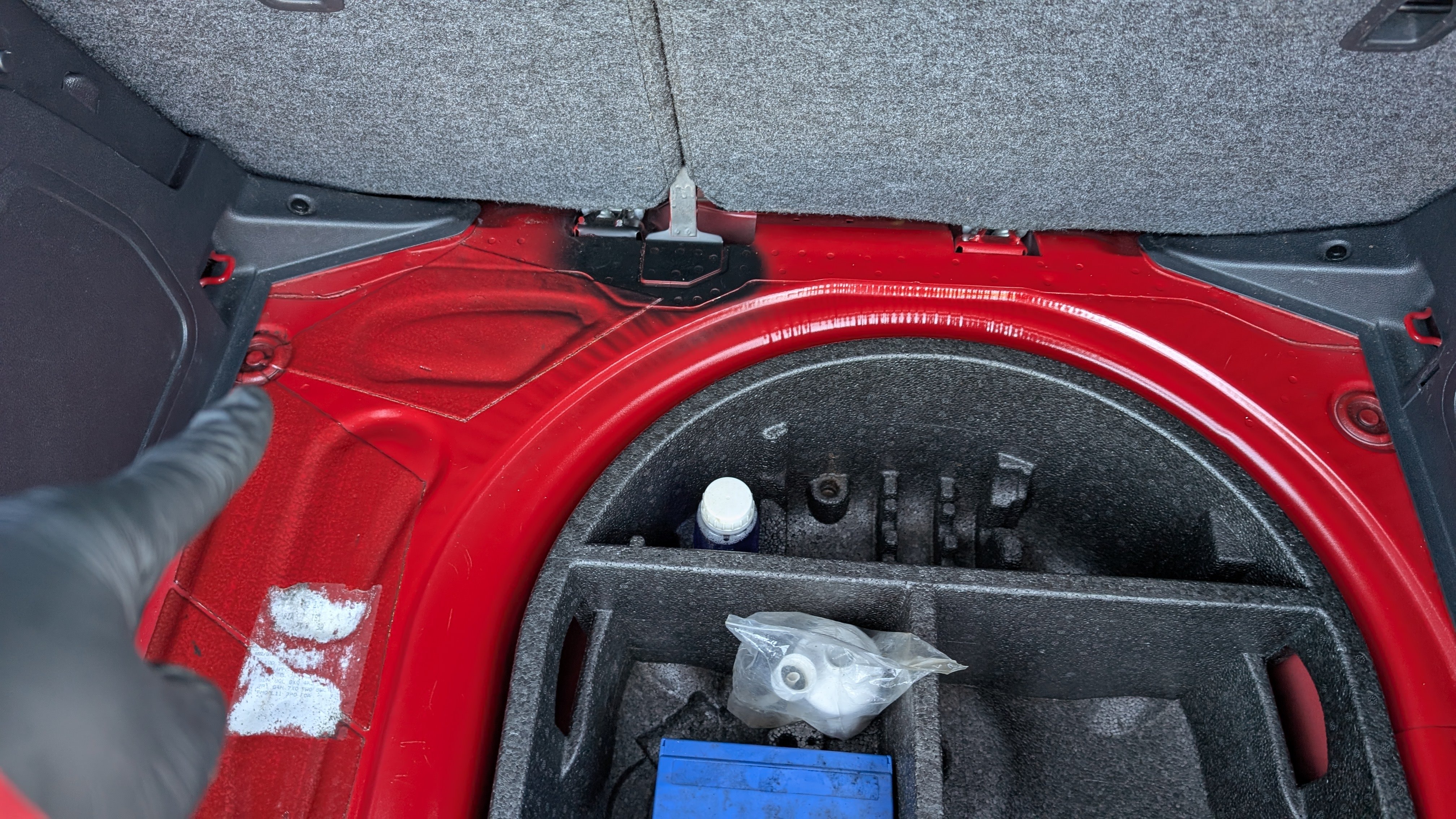

When I picked my Fabia 2011 Monte Carlo up a week or so ago, there was about 6 inches of water in the boot, in the space where the spare wheel would go. I thought it was because the guy had left the boot open when it rained, after drying it out I noticed some more water in it today, I've heard these Fabia's can get leaks in the boot but I have no clue where it's coming from, no damp on the roof lining, checked the rubbers around where the wires go for the heated rear Windows and as you can see in the photo where I'm pointing that's where some water was sat and some in the spare wheel area. I'm wondering if it's coming in through near the rear lights as I seem to have a bulb fault light on but all bulbs are working l, so wondering if that's where it's coming in and has corroded the bulb connector hen every I also have a bulb warning lights.
Anyone else had this issue at all? If so where did you find the water was coming from?
I really need to get this sorted otherwise it'll keep happening. I saw a guy on YouTube who had a similar issue and he reckoned it came from the vents behind the rear lights that let the pressure out the boot when closing it, so he removed them, cleaned them and sealed them back in.
Any help or advice Greatly appreciated.

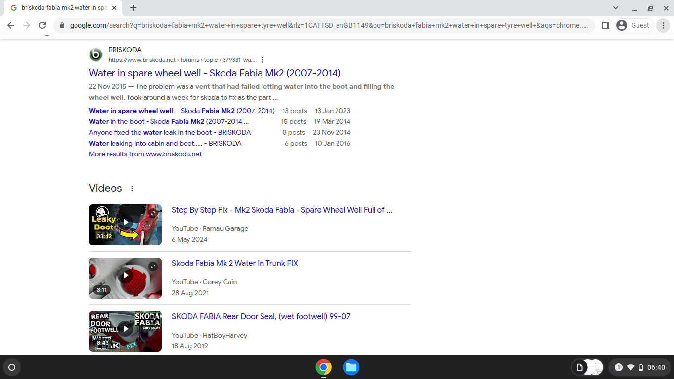

It can be the lights seal,  it can be the rear flap,rear of car behind, actually in front of the bumper, it can be the hatch seal.
Look at the Threads, these are just some of the many.
