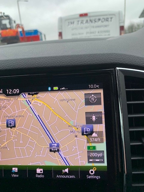

I am driven to distraction by the Columbus Navigation System in my wife's 2018 Karoq. Having set navigation destination into car on nearly every journey the map stops to move, and the car icon therefore moves off the map as we drive.
This is related to a grey image on the right of the screen which looks like a plan view of the vehicle with dashes front, rear and both sides. Tapping this it disappears and the vehicle icon reappears in the centre of the map. Later on the journey the dreaded grey image appears and the map stops again.
Why does this happen? How can I stop it and keep the vehicle cursor centre screen for the whole journey please?
This is driving me nuts and I can find nothing anywhere suggesting how to fix.
That usually happens if you have physically touched the screen.

Just been out to test and you are quite correct. The touch screen and the underlying system are my problem
